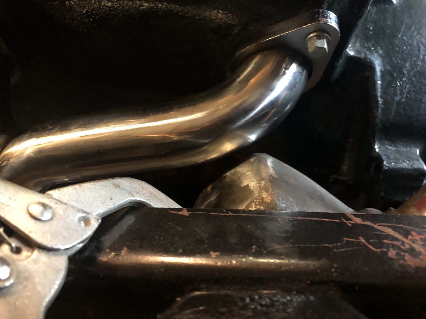

    Oldbanger71, thanks for the pics! From the teaser pics there looks like you have something rad going on! . I just got my headers today... been sitting in the garage starting at this from every angle. I think I’m going to move the steering box back about 4” and it puts it in a spot I think... I also need to make a wedge spacer cause if I clamp it to the frame right it kicked the Column off.. i really wishe I did something a little different. I hate this set up haha . I’ve decided right away that to get my steering wheel low enough I need to shorten the column up. No be deal there I guess. Only thing I don’t like with moving the box back is that I pulls the column up in the pedals. (Kinda more between your feet... I wanna make sure there’s no bullshit with foot space . Since I’m shortening it I might just u joint it and I can do whatever really ... at this point I’m just rambling haha . But here’s some pics of where I’m at. Might just change the header up some ....

    Which Box are you using ? For my self , i decided that it would be less trouble to leave the pitmanshaft at the original location for not changing the steeringbox geometrie. I shorted the pitmanarm to the lenght of a Stock 32. I Took the route of cutting the Box flange off and reweld it at the right angle to the rails, since i knew i needed to get as close to the frame as possible.
    I droped the column a little, so there is now a spacer of about a finger at at the stock 32 column drop and dash. The column goes throu between the pedalarms by just a fiew mm. But pedals clear them ok.

    I think the center dump headers are more trouble than they are worth considering you really don't gain anything horsepower wise when using them. I used an F100 box and some stock flathead exhaust manifolds and got everything to clear properly by pushing the motor over to the right as far as possible and taking a little off the corner of the steering box. I also had to put a small dent in the steering mast tube where the last header manifold bolt is. One issue I had was that there is so much stuff on the left side of the engine it would have been ugly trying to get the exhaust through there. I ran the exhaust across under the front of the motor and down the passenger side with the pipe from that side and then back over to the driver side so I could have duals out the back. Hope this helps.
