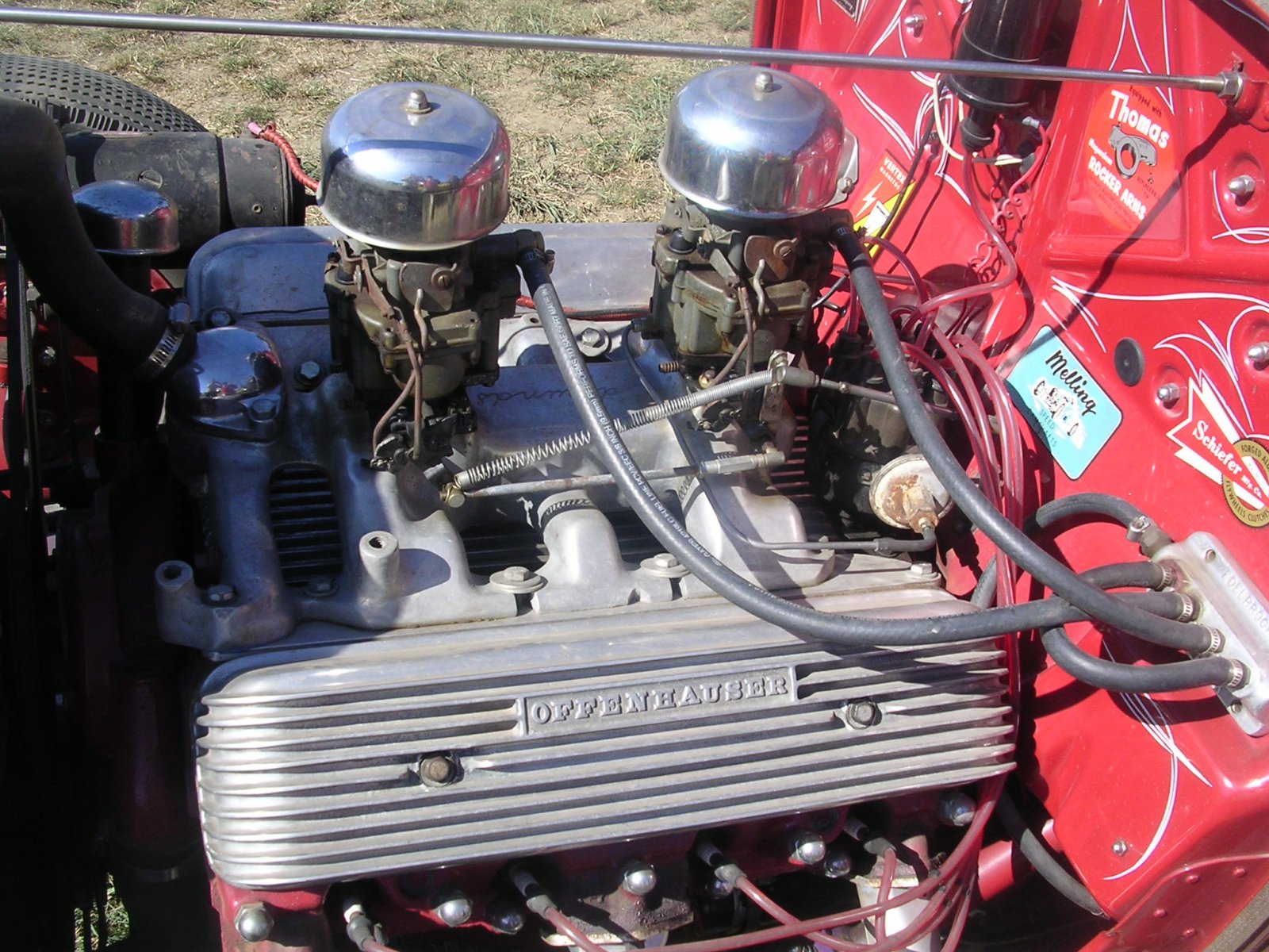

    I'm no expert either, but that's sort of a true statement, ..."If" a person wants to slightly modify things, then those "can" be made to work,.... and it was done back in the "good old" days...
    I talk with as many oldtime hardcore Olds guys while they are still around. One of these guys sold me a shaved iron GM 57/8 J2 tripower intake that he bought brand new from the local Olds dealer. He had a friend mill the flanges so it could fit between the heads on his race 324 motor. I am pretty sure he later ran 371 heads on that 324, and I don't know what if or what needs doing to make that work. (he also ran about four or five different aluminun intakes on that motor...he always was experimenting)
    I have that shaved iron J2 intake on a 303 which has much shorter head ports than a 324, but I never opened them up to match the 371 size intake ports. I was told by Dave50 that the "stepped restriction" would be an issue at high RPM...AKA "reversion"
    I also had a vintage aftermarket set of aluminum spacer plates that were made to use the narrower 324 intakes on a 57/8 371. Not sure on the port match, but I would guess a little port matching was needed for high RPM.
    Also, I am running a 303 2x2 Edmunds on my 324, by using home machined aluminum plates to seal the upper edges of the head ports. I use a 324 gasket on the head, then the plate, then a 303 gasket, and then set the intake on. I am not doing high RPMs, and I wanted a 2x2, so it works OK for me.
    Some aftermarket 303 aluminum intakes might have more material at the top of the ports to be able to work better on a 324, but Edmunds really skimped on the thickness there.
    Here is a pic of the Edmunds port mismatch on my 324, before I made plates. This was an early "open web" low-rise Edmunds, and I've since switched to the later closed web, higher rise Edmunds. Both versions still need the sealing plate on a 324 motor.
    Also a pic of a 57/8 371 in a 32 Ford at a show, with homemade spacer plates to make the skinny Edmunds fit to the wider 371. He was running a 39 trans, so maximum HP is "not required" :)
