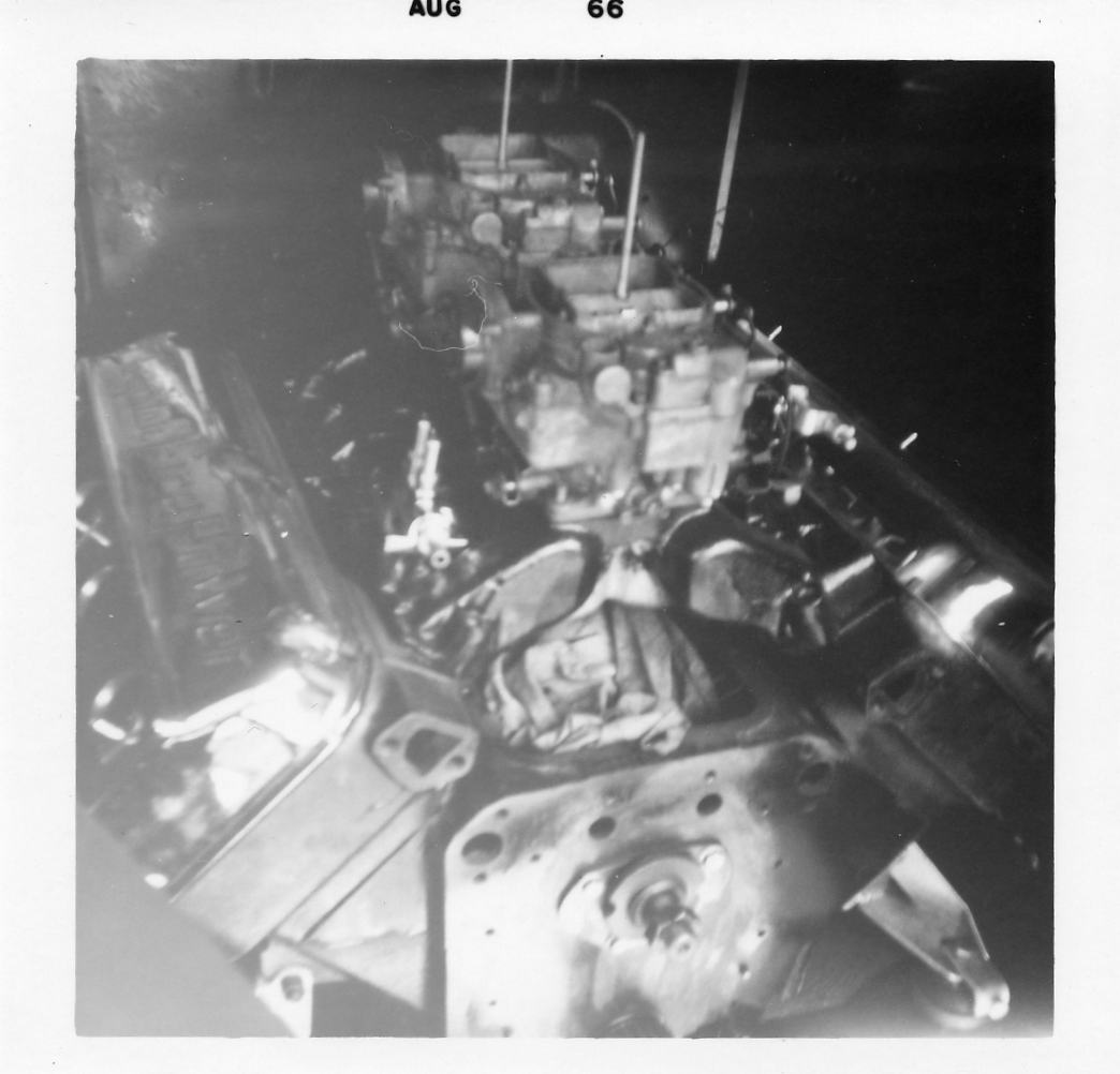

    I ran across this picture of my '47 coupe with the 331 in it. It's a pretty good view of the Hurst mounts with the anti chatter adjusters on them. Supposedly they stopped clutch chatter when using a stock closed driveline.
    Tom

  27. 39delux
    Joined: Nov 1, 2002
    Posts: 332
    39delux
    Yep. They are the same thickness as the mount material and the bolt is in a tapped hole. You tighten it against the mount and it pulls on the bolt head. I have no idea if they worked but they were also in a Hurst box when I got them from J.C.Whitney.
    Tom

  29. 39delux
    Joined: Nov 1, 2002
    Posts: 332
    39delux
    This was 1964 when I put this engine in but I'll try to remember what I can. I sold the '47 in 1981 so I don't have it around to look at. I's still around now mounted on a '68 442 chassis. The hemi I sold seperately.
    As you can see in the photo the mounts set on stock Ford bisquits and bolt through the stock Ford holes. I had a stick belhousing on this and with the carbs leveled I had to trim the bottom of the firewall maybe an inch for clearance, then modify the floor pan to fit. The stick bellhousing had mounting ears like a '55-'57 Chevy so some standoff mounts were made bolt in style and attached to the x member. The ears then set on rubber mount pads that I can't remember what they were for.
    The Hemi was a rear sump and the pan cleared the tie rods and wishbones. The oil filter cleared the frame by about 1/4". I planned on clearancing the top of the rail slightly to give some wiggle room. The starter was very close to the steering box but didn't touch. The stock rams horn manifolds were very close to the frame If I remember, if they cleared at all. Today I'd just get some Sandersons.
    I never got this car finished as life got in the way after high school with Viet Nam and all so I never fit the trans in. It still had the closed drive line rear end in it to roll around but I had a '57 Chevy rear for it. The trans was a late '50s Plymouth (I think) 9 bolt side cover 3 speed that looked like it would fit throught the x member once it was modified and once the rear parking brake drum was removed from the tailhousing. It was a very skinny trans. Since you are using a Turbo 400 I'd just get the Chassis Engineering split wishbone and trans mount kit.
    I don't know what to tell you about the center sump pan. I'd have to see it in position to see what mods to recommend. Maybe someone else here has experienced this.
