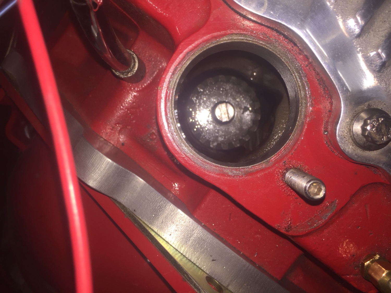

  26. I think it’s because we have to take the gear off of the distributor so that the intermediate shaft and distributor shaft will engage. The inside diameter of the bottom of the distributor gear is too small to accept the top of the intermediate shaft.
  27. I might try and turn down the end of the intermediate shaft so the gear will slip over it.

    Can you better explain your thoughts on this? The gear is/should be pressed onto the intermediate shaft and depending on exactly which shaft you are using the gear location on the shaft can vary but the base of the gear will always seat on the tower bushing.
  29. I’m talking about the gear on the end of the distributor shaft. The intermediate shaft hasn’t been messed with, but in order to get the distributor to mate with the intermediate shaft, we had to remove the gear from the distributor because it wasn’t big enough to go over the top of the part of the intermediate shaft that sticks out above the gear.
  30. [​IMG]
    You might not be able to tell from this picture, but our shaft sticks out about 1/4 of an inch above the gear, unlike the stock shaft which is below the gear. That’s what I’m talking about when I say the gear on the distributor won’t slip over it.
