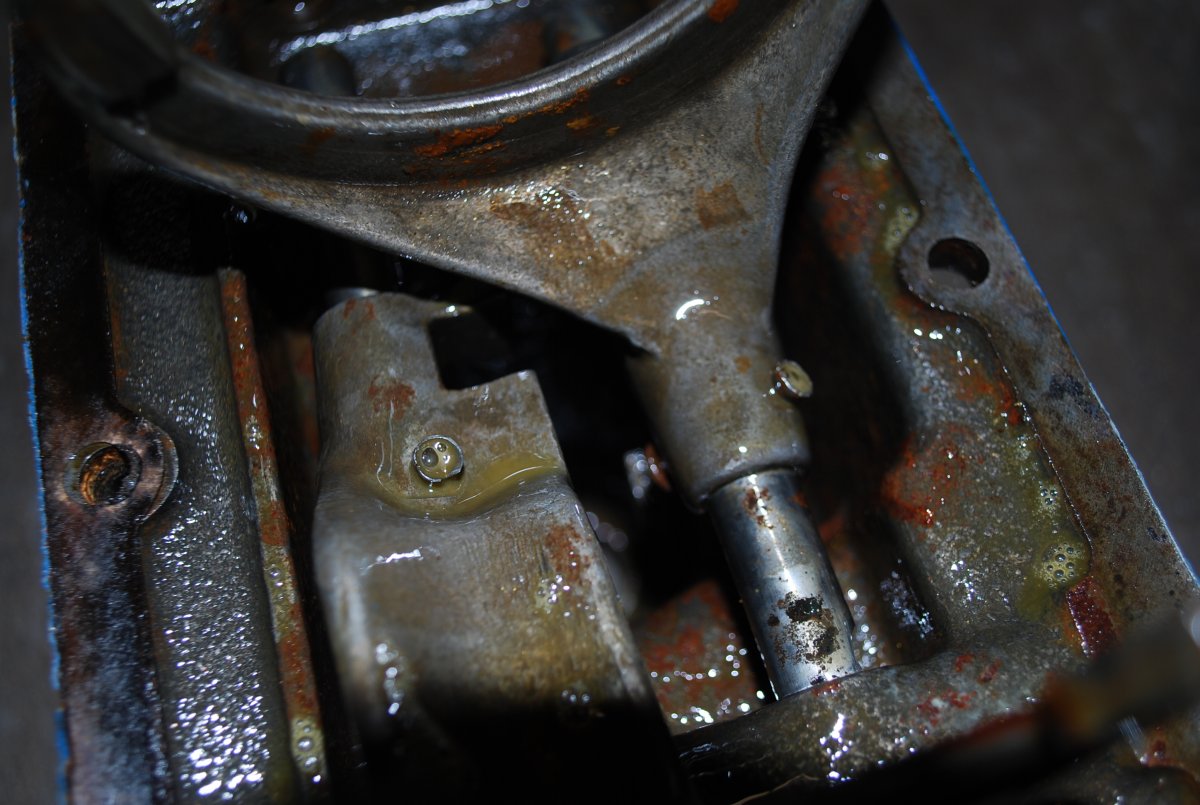

    Hey guys. I got a 51 Ford F1 from hell in the shop, been pretty well cobbled together over years and I been trying to sort thru it all so I can get it out of here and the owner can drive it. It's got a 3 speed floor shift behind the flathead the owner bought to replace the 4 speed that was in it. He installed it with a new motor. Shifter just flops around like a loose noodle, I finally got it in a gear (not sure which other then a forward) but then it stuck in that gear no matter where the shifter went. Pulled the lever, looked down inside. The top of then first/ reverse shift fork is about 4" down from the cup/pin in the tower, 2nd/3rd is about 2 3/4" down. The end of the shifter is about 4 1/2" from the ball, that jives with 2/3. Now I'm not a tranny guy but I don't see how this would work. I'm I correct to assume he bought a pos tranny that needs to come back out? Least I was able to see it was stuck in 2nd and was able to get it into neutral with a long screwdriver and can roll it again.

    Nothing wrong with the shifter itself, my first thought was a broken pin, all that looks good.
    I went ahead and pulled the shift tower. Here are some pics. I feel like the shift forks are not matching, notice how the notch the shifter fits into are different heights. No way this shifter fits into the 1 st/ reverse fork. Not to mention way too much room between the 2, shifter can move freely between the to forks, neutral should just be a side to side.

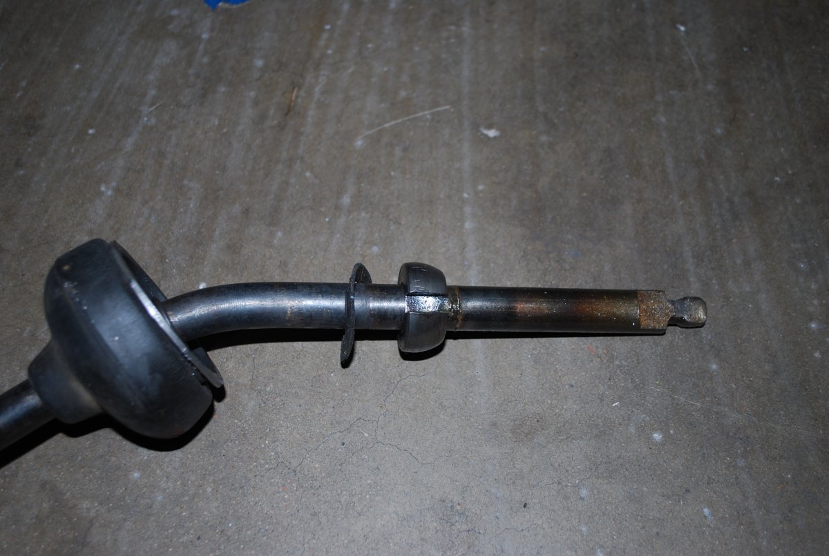

    Post a picture of the bottom 8" of the shifter lever.....turn it for a couple angles with the camera and post them here.
  7. That's the 4 speed stick, you need a 3 speed stick

    None of my early Ford shifters have an end like that. Maybe Mac can tell us what it is from. ----I type slow, Chris sussed it.
    At first I was thinking you may have an early lever in a later trans. They are different lengths from the rotating ball to the tip.
  9. There are also two 3 speed speed stick. Assuming your large fork is the wide one (part number 91A-7230), you will need the longer stick (1939-up).
    I'm not even sure how that 4 speed stick would even work, but obviously it needs changed out

    Well, it doesn't! Must be why it has a 4 speed knob on it. OK, great. Guess I'll have to start the hunt for a shifter. Anyone have a pic of what it looks like. It does have a 91A-7230 fork.
  11. Not handy, but a 39 car would have had a swan shifter, pickups had a more strait shifter much like your 4 speed one except a lot thinner. Either car or truck 3 speed stick will work. I do have a couple extra Swan shifters laying around, They are what people usually want due to their shape.

    + 1 on the totally wrong shifter.Trans needs the late (long stub) shifter.I have some of the straight truck type as well as the swan type if you need one.

    You definitely had the truck 4 speed lever there. As you now know, it will not work in the 3 speed transmission. With the 68-7222 or the 81-7222 shifter tower, you have 3 choices for a lever (all three have the same bottom stub):
    1936-37 car lever (single gentle curve out to the knob)
    1938-39 car lever (double bend out to the knob)
    1940-50 commercial lever (straight out to the knob)
    We've got the first two types available. No commercial levers at this time.

    Glad to hear it's just the shifter and not transmission parts. Like I said, I don't do transmissions but I thought that any pre 39 shifters wouldn't work in the 39 and later transmissions, guess from what Mac said above I was miss informed. I'll check with the owner but I'll bet he'll want the commercial straight shifter. Thanks for the help all.

    Ha, ha. My customer finally admitted this was his doing. Bought the transmission without the lever. Just assumed his lever from his 4 speed would work, put it in there. Said he did notice it was a bit "loose":eek:.
