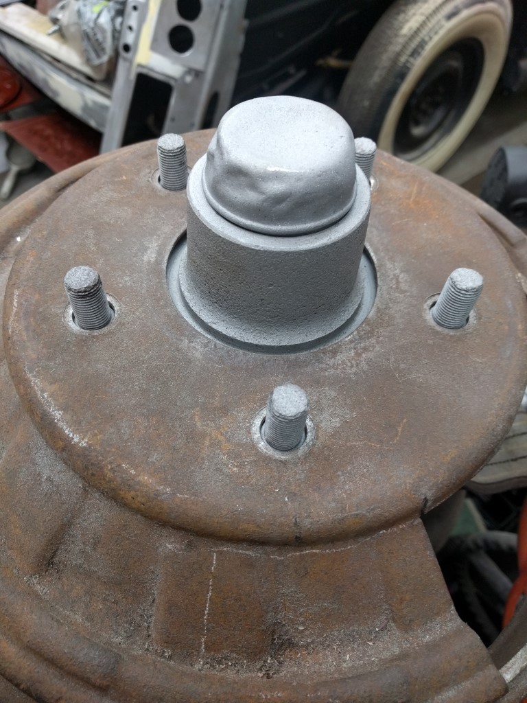

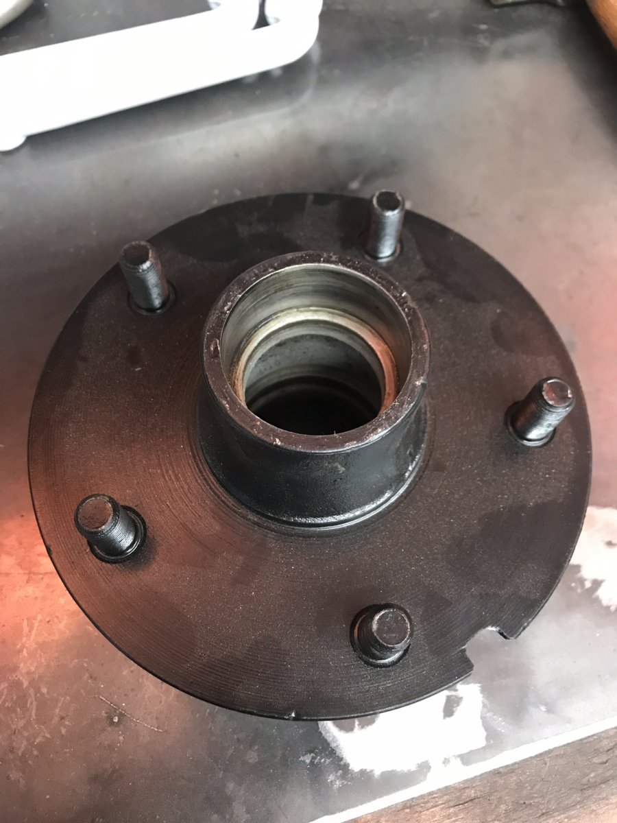

  1. I’m cleaning up a pair of ‘48ish hubs I bought a few months ago. Planning to use them on ‘39 passenger car spindles.
    The bearings (and races) on the outside of the hub fit the spindles just fine.
    The ID of the bearings on the inside are at least 1/8” bigger than the corresponding bearing surface on the spindles.
    A passenger car inner bearing will fall about halfway through the original inner race that’s in the hub.
    The OD of a passenger car inner race is considerably smaller than the corresponding ID of the hub.
    I’m wondering if I have truck hubs here. I’ve never heard that there was a difference but I can’t think what else might be the problem. Anyone ever run across this? IMG_7572.JPG IMG_7573.JPG Bottom line, I need the right bearings and races to get these things ready to roll

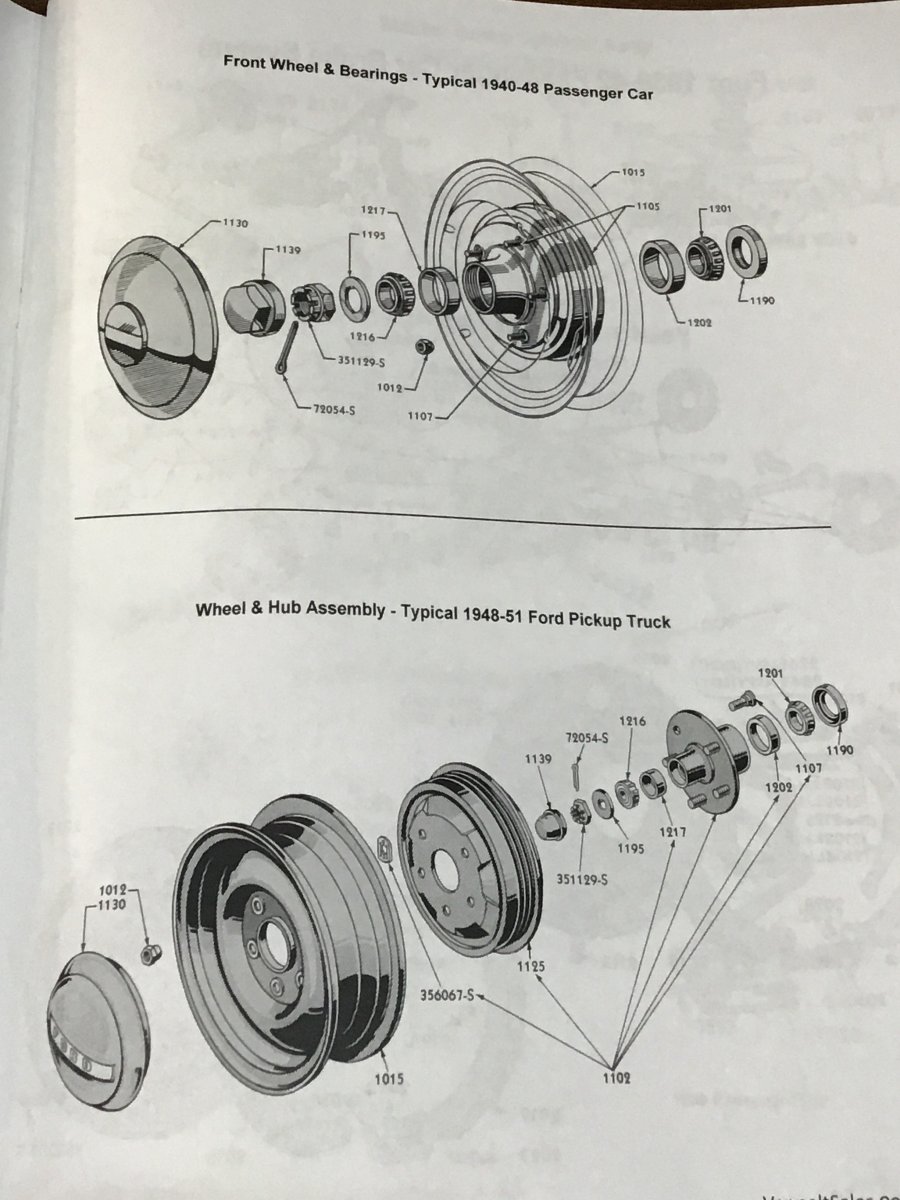

    image.jpg Jim 1946 1948 hubs have the hub outside the drum and doesn’t look correct. With that being said according to the book it shows the same bearing in the rear between the years

    I think the OP has F-1 hubs. They do take a bigger inner bearing. I have no idea if anything would space right. The drum would probably be too far inboard.

    The hubs are machined for outside drums so not 42-48. Not 40-41 because those did not have the notch on the flange. They are likely F-1 or F100 as they had the notches. The flange was more outboard with the F-1’s so that is my guess. The F-1 studs had protrusions that fit in oversized holes in the drums. These are like that.

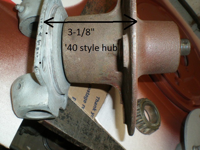

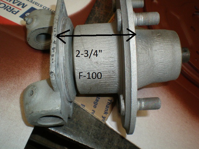

  17. Just to clarify; '48-'52 F-1 and '53-'56 F-100 backing plates/brake assemblies are the same with 11" x 2" shoes. F-1 and F-100 hubs have different offsets; but use the same bearings, races, and seals.
    The F-100 flange is closer to the backing plate by about 7/16". F-100 front drums are readily available from about any parts source. F-1 drums are obsolete in the parts aftermarket; but later drums will fit; '80 Bronco rear is a good application to ask for.
    F-1 and F-100 brakes are self-energizing and are an upgrade from the early Ford Lockheed style brakes.
    @Harrison since the offset of the F-1 hubs is only slightly different from the '40 style inside mount hub, you could use those F-1 hubs with your Lockheed brakes if desired. Need to make a spacer ring to center the larger Ford drum pilot on the F-1 hub. Picture is an old Ford drum; but a new repop would be similar.
