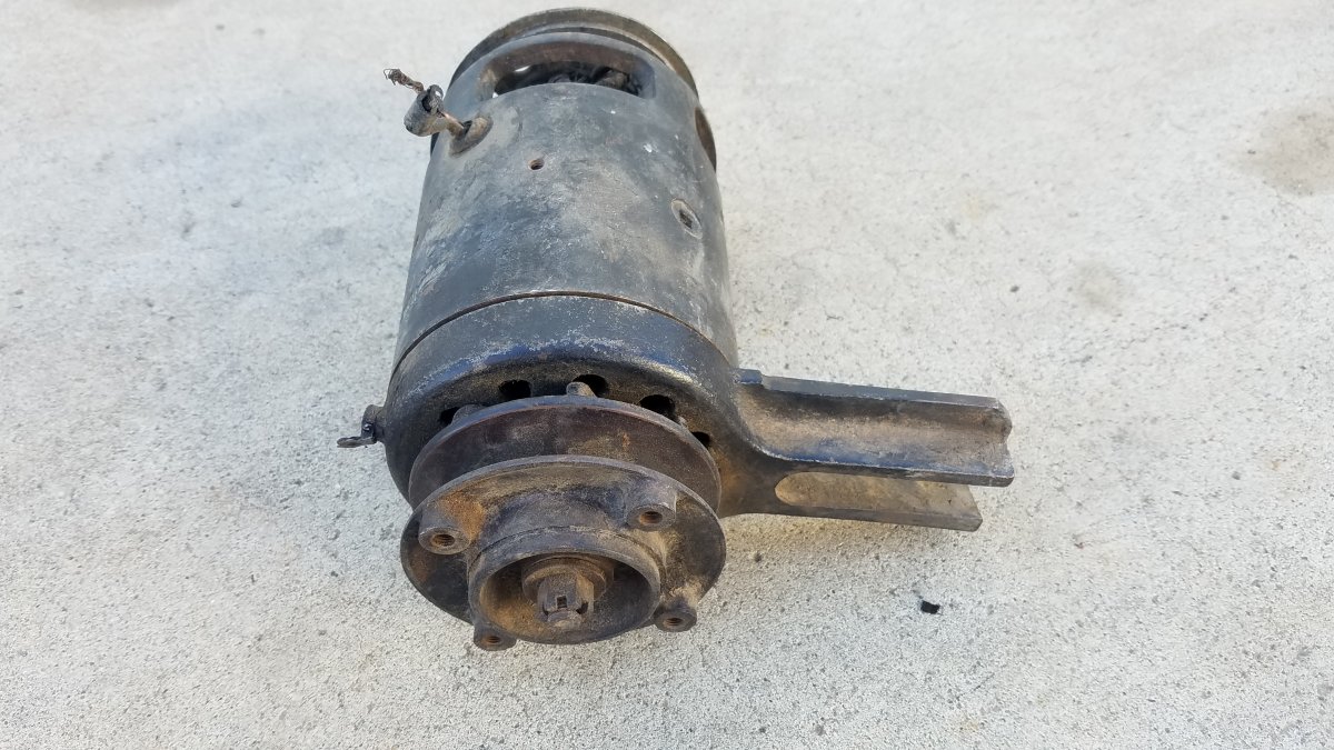

    I got this 3 brush generator brought to me yesterday. Fields look crappy and should be replaced along with the wires. Can I replace them with 2 brush fields and use just 2 brushes and /or replace the end plate with a 2 brush plate? This one has vent holes in front plate and the rear.

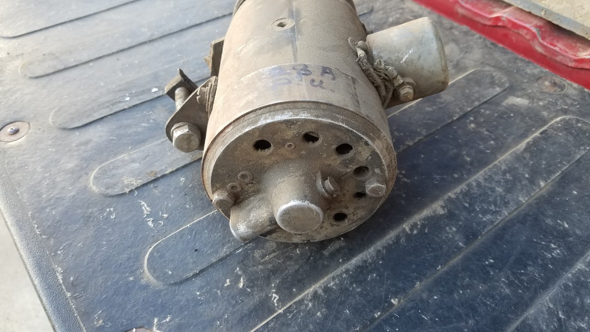

    And....Just a few minutes ago I was putting things inside the shop and I picked this up in a box, thinking I had left the previous one sitting outside. Then realized it was another one entirely! Probably came from the same friend. It looks like a combination of parts that had been used on a '28 Model A pickup but has a ruined V/8 front mount and was either for a Model A or a N series Ford tractor! It also has a larger diameter pulley.

    As I thought, my friend called me this evening and said he dropped this one off too!

    i have not studied the internal wiring to see if one could convert a 3b to a 2b. i do know the case is slightly bigger on the 2bs, so output would possibly be lower with a smaller armature. food for thought

    I have found that the 2 brush has small slots on the back vent with the ones in my collection . I haven’t found one that doesn’t and as. @Deuce Lover noted the pullies have both curved and straight cooling fins I have found the pullies are smaller in diameter . Great conversation going on this subject on the fordbarn right now.

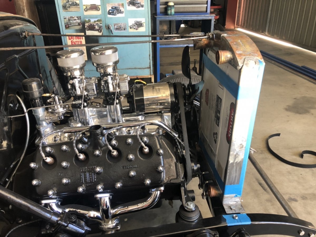

    I bought a used double pulley 2 brush generator off you know where from Canada. It is the large diameter pulley and has the fan mount. I'm thinking it was for a large cab over truck. Number cast in the front mount starts with O1A-***** so it is at least 1940? It does motor so it may be usable. Double pulley is ok as my fan is shorter than I would like. Wouldn't mind finding a longer fan. I'll post pics of the gen later.

    So does anyone have an actual picture of a ‘39 2 brush fan mount generator? How is the pulley attached, nut and washer with key? Are the screw on fan pulleys with a snap ring aftermarket for later gens? The more I research the more confused I get. What’s the correct diameter pulley?

    cant help with a picture, but there is really no "correct" pulley size. pulley size determines fan speed, and therefore charge rate. you may want a higher fan speed on something like a city bus that seldom see's highway speeds, or you may want a slower fan speed , less wind noise, on a highway driven car. smaller pulley, faster speed, bigger pulley, slower speed. the same generator could have come with any size pulley from ford

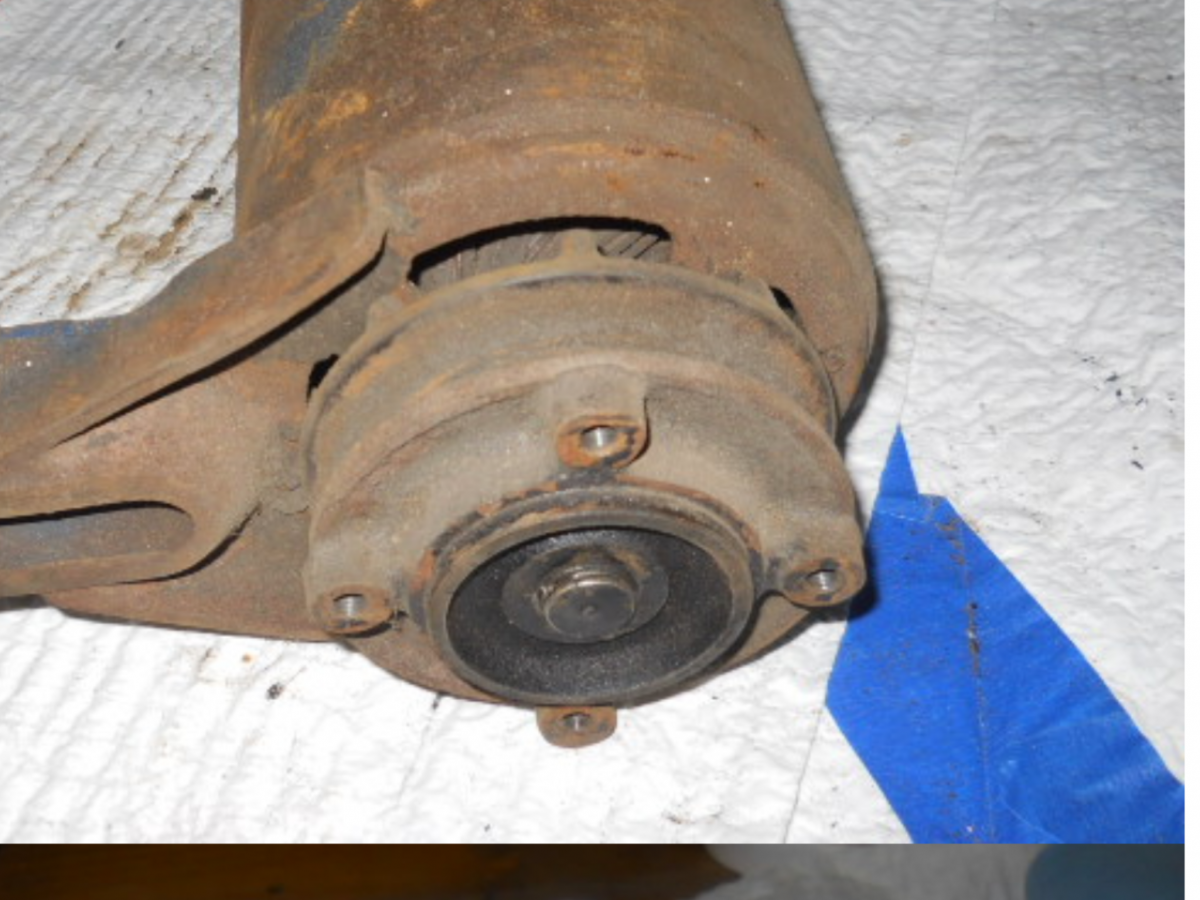

  16. I believe the pulley in the picture posted by @ LSGUN is an aftermarket pulley used to convert '40 to '48 generators to mount a fan. The pulley appears to be the type which screws directly on to the armature shaft and is retained by the snap ring. Ford started using this arrangement in 1940. I do not believe that Ford ever made a single sheave fan mount pulley for the '40 to '48 generators. But, who knows, there may have been some truck, bus, or military version.
    I have attached a photo of a '46 to '48 generator. It shows the snap ring on the end of the shaft to keep the pulley from unscrewing. The pulley is the normal passenger pulley of 3.18 inch outside diameter. The first photo is of a '39 Standard generator. It has the old keyway type mounting to keep the pulley on the armature shaft. There is a lock nut on the end to keep the pulley on. This is a two brush generator and was used on 1939 Standards only. Several parts are unique to this generator. The one shown has a pulley outside diameter of 3.68 inch. It is for a 60 HP, the 85 HP used a slightly larger pulley.
