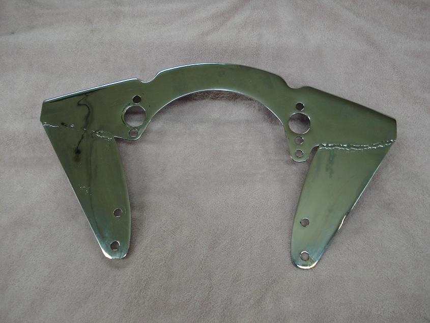

    One of the things that Jim H mentions in his "list" is "modifying the OE engine mount to be a motor plate. He sent me this photo of the one he did. I assume he eliminates the OE cushions. If that is the case, then I think you could modify the top of it to clear the alt bracket

    So as I am thinking about the whole front engine plate, damper spacers, alternator brackets etc, why not just build mounts off the frame to use under the engine solid mounts instead of the front motor plate?

    You could do that, but there will be interference with headers and steering. BTW, I did eliminated the OE cushions because they would be destroyed quickly with my 6000 rpm launches. I made up alum. blocks and lowered the engine about 9/16". That was enough to allow me to run a flat stock hood with an air gap manifold holley carb and a stock air cleaner. Jim

    After looking at this engine mount plate I see that the added lower ears probably help with eliminating water pump leaks due to the stress of hard launches.

    That is perfectly correct. The stress on the water pump bolts is too much for those bolts to not slide in the gaskets and cause leaks. If you look at used front motor mounts, most will have elongated holes. There is no saving these mounts. The extensions help distribute the toque to the 55 chevy mounting holes. You should still re-check them every 25 runs.. Jim
