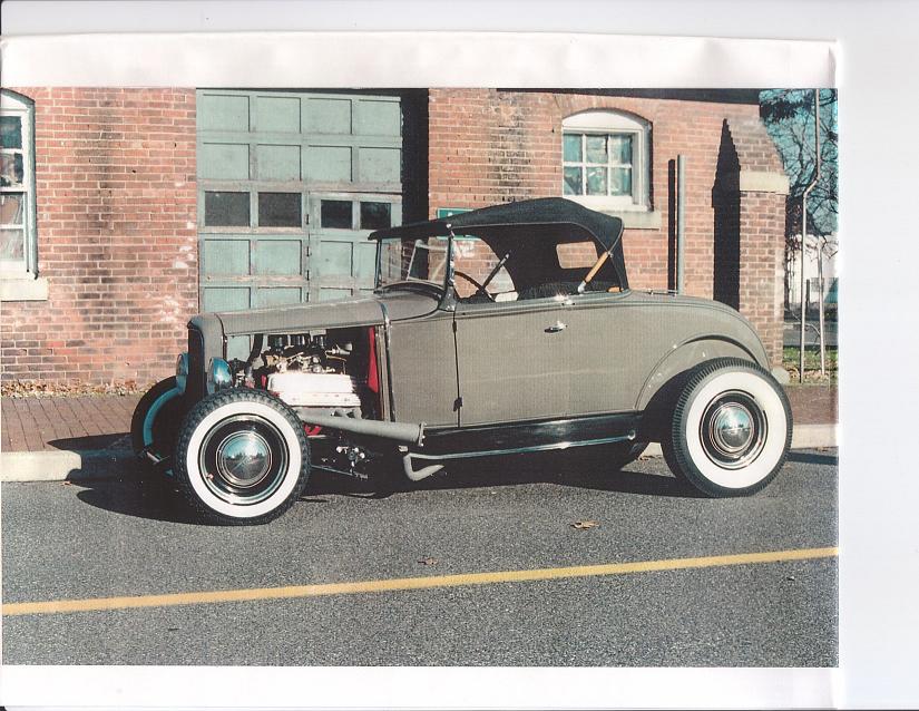

  5. I used an early Bronco rear in my '30 "A" roadster on a '32 frame with forty Ford wheels. The forty Ford wheels are the same lug pattern as the Bronco which is an added bonus for you. I thought it looked good in that car.
