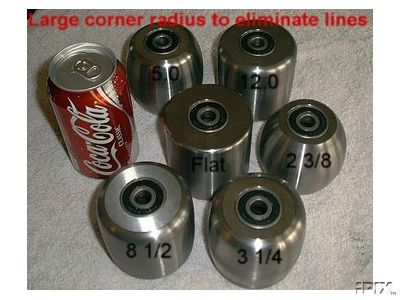

  10. Shiva69
    Joined: Oct 4, 2001
    Posts: 154
    Shiva69
    You may want to radius the corners of you dies so that they aren't sharp... if you have done that just ignore me.
    here is a pic to show what i mean
    Garth
  11. dusty
    Joined: Mar 4, 2001
    Posts: 176
    dusty
    Thanks for the addiotional thoughts guys. The lower wheel was aligned when I built it. The radiuses do have sharp corners so that might be worth a look. Had to do the grandfather thing today so didnt get to the garage at all today.
