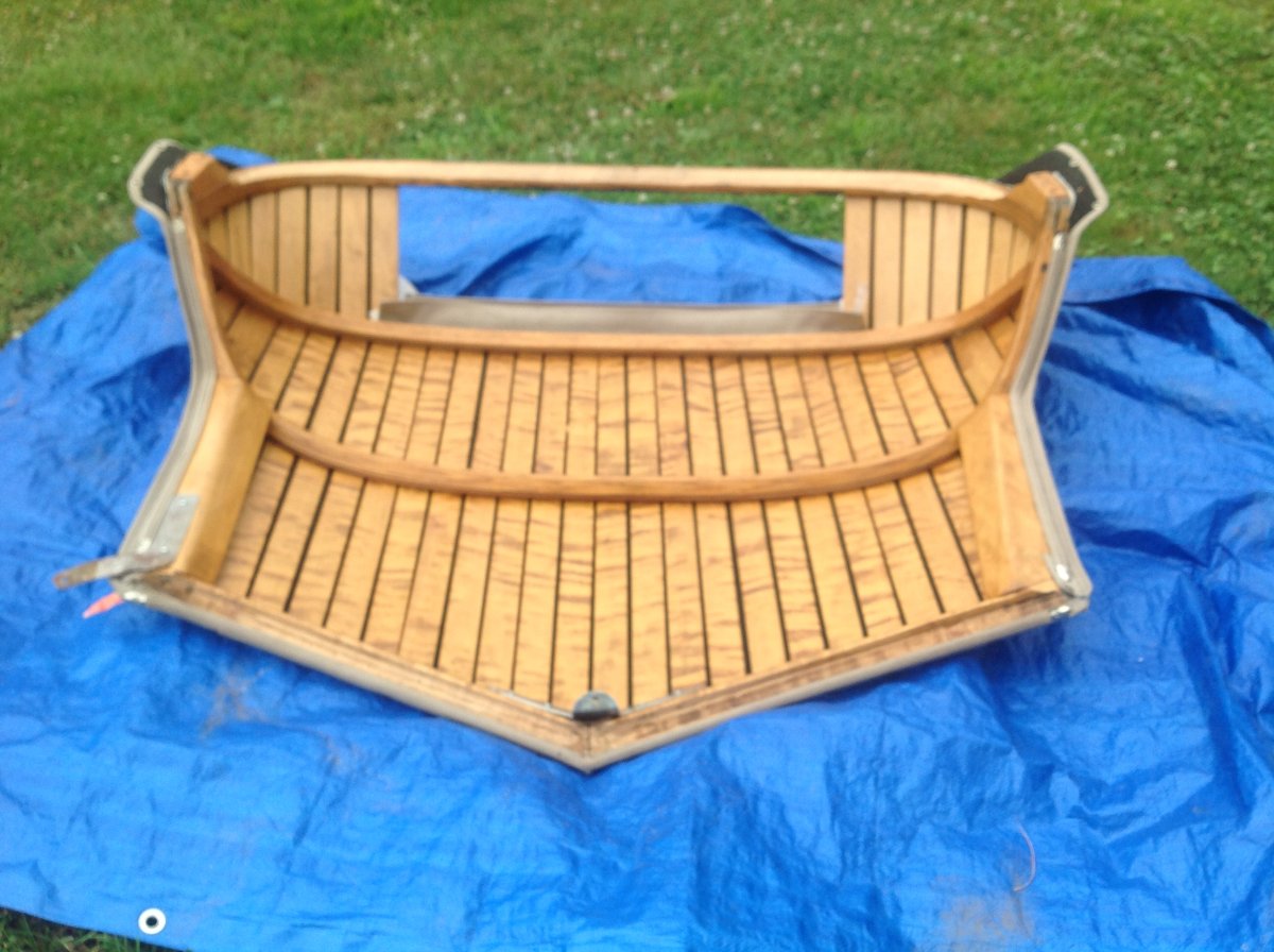

    1. Y-blocks
    Looks in your nice photo,that you have a top?,I'm interested in how the windshield header is made an how it holds to windshield ???Thanks
  17. hfh
    Joined: Oct 22, 2012
    Posts: 477
    hfh
    from Western MA
    IMG_1995.JPG IMG_1994.JPG I don't have very good pictures of the top but it's made of maple and oak. (I wanted it to be like the old woodie roofs). I used steel to join the windshield header parts together in the center. That steel piece is also a way to connect the top to the windshield in the center. I will also have steel connectors to the windshield side posts but I am still working on the design.
  18. dana barlow
    Joined: May 30, 2006
    Posts: 5,126
    dana barlow
    from Miami Fla.
    1. Y-blocks
    Very interesting,nice work too,thanks !
