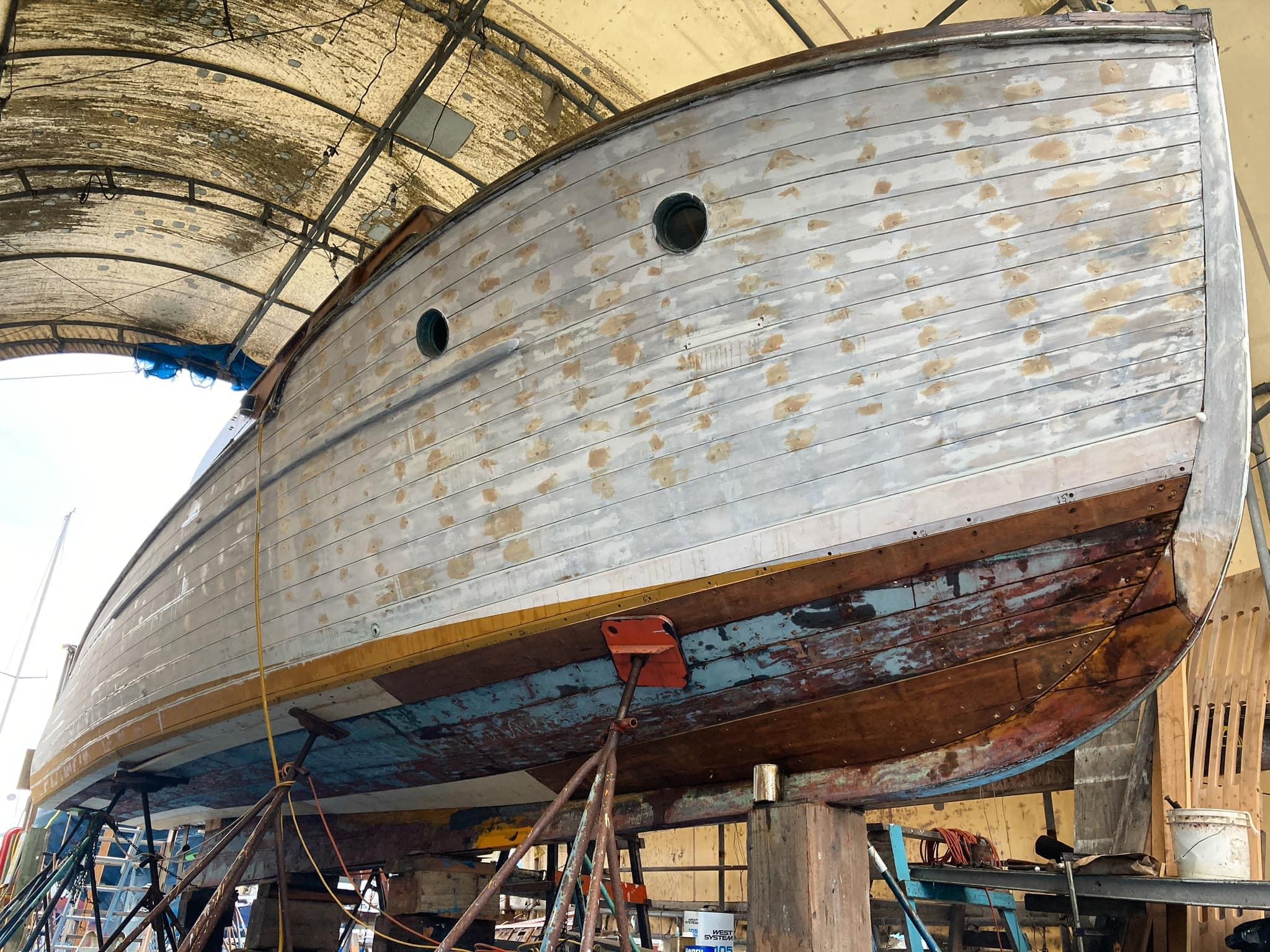

    We started making new planks and putting them on to keep rain and critters out of the new work.
    Then we started stripping the entire hull back to bare wood:
    New engine beds were made and installed:

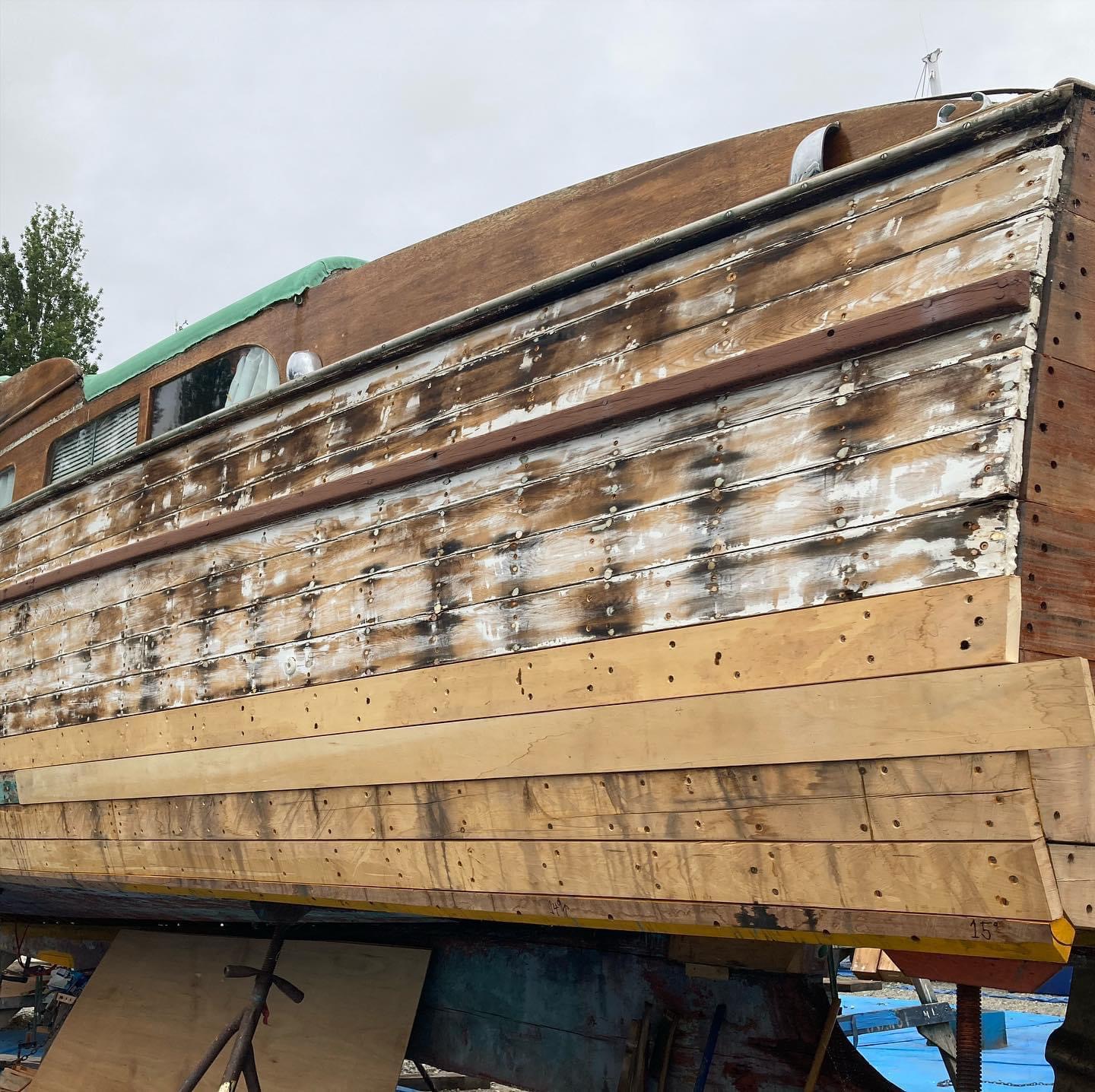

    More planks were made and hung…
    Every plank on the boat got refastened with new bronze screws at every frame intersection, and the hull above the waterline got some thinned primer to seal the wood against sun and rain…

    The next many months of weekends and free time were spent getting the hull above the water line fair and smooth in preparation for the first “good” paint job Duffy had had in a long time. Putty, sand, paint, sand, putty, sand, paint, sand…
    A few more troublesome planks were identified and replaced on the upper hull during this process…
    …and bottom work continued with plank replacement, refastening, and attending to seams and through-hull ports:
