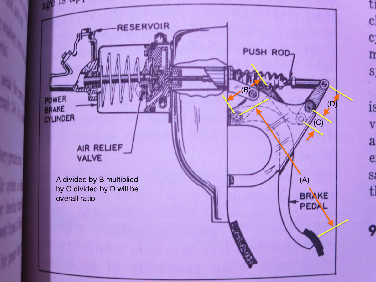

    to find the ratio at the booster you need to find the pedal ratio to the link A/B then need to find the link ratio Al/Bl ( the bell crank ) then its A over B times Al over Bl = the overall ratio basically its the pedal ratio x the bellcrank ratio = overall ratio
    page 71 if anyone has Puhns book as I cannot scan it to the computer

    I took measurements per the specs. A=12" B=3" C=1 1/2" and D=2 1/2". That gave me a calculation of 2.4:1 ratio if I did that correctly, but I wanted to mention a few things that we tried first to see if you have any thoughts...

    If your calculations are correct, and the pedal ratio is indeed 2.4:1, then that pedal assembly has to go.
    You should have 5:1 - 6:1.
    You will never get good braking pressure with 2.4:1

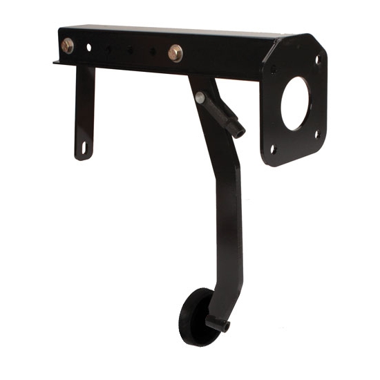

    I have used numerous assemblies from Kugel Komponents, for the weirdest and most stubborn applications: http://www.kugelkomponents.com/zencart/index.php?main_page=index&cPath=4_7
    Like this, but you'd have to trim the face to fit the protrusion, and get the pedal pivot farther from the firewall.
    Or an adjustable one, like this:

    Look at the bottom two I posted (they look identical, except for finish).
    They attach to the firewall via the bolts that currently attach your booster. You unbolt the booster and co-bolt the pedal bracket with it, and the firewall.
    The tab at the far end gets attached to the dashboard, for stiffness.
    The Speedway one is like $90. It may need to be modded a bit, but it WILL fix your problem, provided the pedal is an acceptable distance from the floor.

    After ditching the entire original pedal assembly, here's what I would do:
    1. Obtain on of the pedal assemblies pictured above, probably the lowest one.
    2. Verify that the bolt pattern matches the existing booster brackets. Re-drill as necessary.
    3. Make a template of the studs holding the booster on the plenum.
    4. Transfer that to the firewall, and drill holes in the same pattern.
    5. Obtain some heavy wall tube with the I.D. of the studs that hold the booster on.
    6. Measure the distance between the plenum and the firewall. Cut four lengths of heavy wall tube to that length.
    7. Obtain Grade-8 hardware that is long enough to go through the booster brackets, plenum wall, heavy wall tube, firewall, and the pedal bracket, with room enough for nuts and washers.
    8. Remove the booster studs from the plenum. Carefully grind them flush, and drill them out.
    9. Use a step bit to enlarge those new holes large enough that the heavy wall tube will bass through.
    10. Put the long bolts in the pedal assembly.
    11. Mount the pedal assembly by passing the long bolts through the firewall and plenum.
    12. Slip the heavy wall tube over the bolts.
    13. Remount the booster and master cylinder.
    14. Fit the pedal.
    15. Fit-up the push rod, as necessary, to meet the booster.
    16. Fashion a way to attach the end of the pedal bracket to attach to the dashboard.
    This will stiffen the entire operation, attaching the booster directly to the pedal assembly, instead of floating sheet metal.
    RetroJoeG likes this.

    The two lower pedal assemblies are designed to have the excess cut off. They have multiple bolt holes to hang the pedal from, and you can even drill your own, where it fits best. Same goes for the dashboard brace.
    The heavy wall tubing and long bolts get the booster attached directly to the pedal assembly, sandwiched with the firewall. They pass through the plenum wall, but that metal would then no longer be in-play.
    Attaching the booster in this fashion applies the force delivered by the pedal, directly to the booster.
    As it is now, the sheet metal of the plenum is what is taking that force.
    I'd rather see 4 Grade-8 bolts taking that force, than some 18ga. sheet metal.

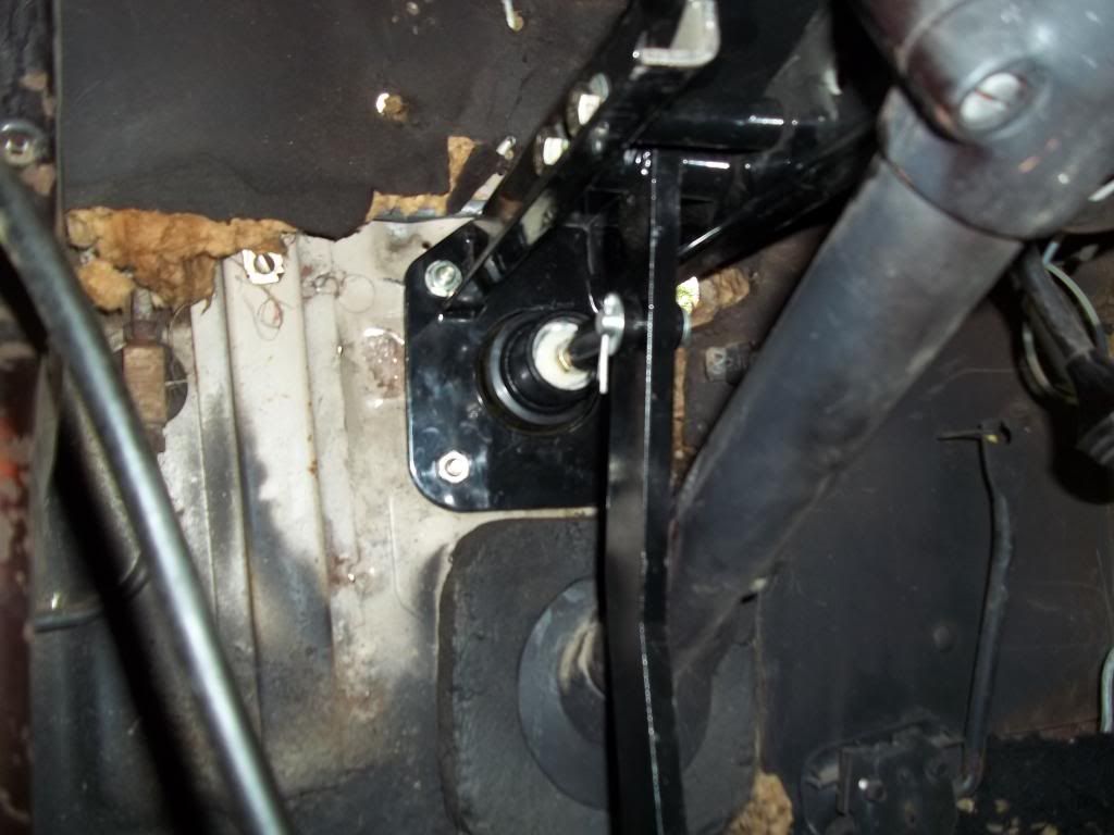

    Here is one of the Speedway units I installed in my 47 Lincoln. I went from a floor pedal to a hanging pedal using their kit. I cut off the channel where the pedal mounts so it fits under my dash, and bolted it to the dash. I tried several of the pedal mounting holes until I got one that felt right. I have 12" drums in front with 10" drums in back, and my pedal is easy, actually too easy. Not spongy, but easy to push. I may even remove the booster as I don't think I really need it.

  28. RetroJoeG
    Joined: Oct 9, 2012
    Posts: 74
    RetroJoeG
    from Upstate NY
    The last photo didn't go through. Can you try to upload again? I see you have residual valves on the lines. Mine doesn't have that, but the shop said they didn't see a reason to put them there because it would probably make the existing pedal even stiffer. Does that sound right or would those valves help?
