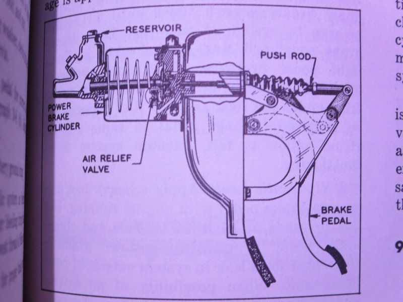

  28. Don't lose sight of the original issue.. the booster does not seem to be working. I'm personally leery of aftermarket items like that. I would have gone with a remanufactured or new GM master/booster combo. Like something off a '66 Riviera for example.
    RetroJoeG likes this.
  29. If you used the original pedal; that is probably the biggest part of the problem, ratio is way out of line for a normal booster and master.
  30. RetroJoeG
    Joined: Oct 9, 2012
    Posts: 74
    RetroJoeG
    from Upstate NY
    Ok, how do you calculate the ratio on the original pedal and what would be an ideal pedal to use? Everything I'm finding is pretty much the same universal design.
