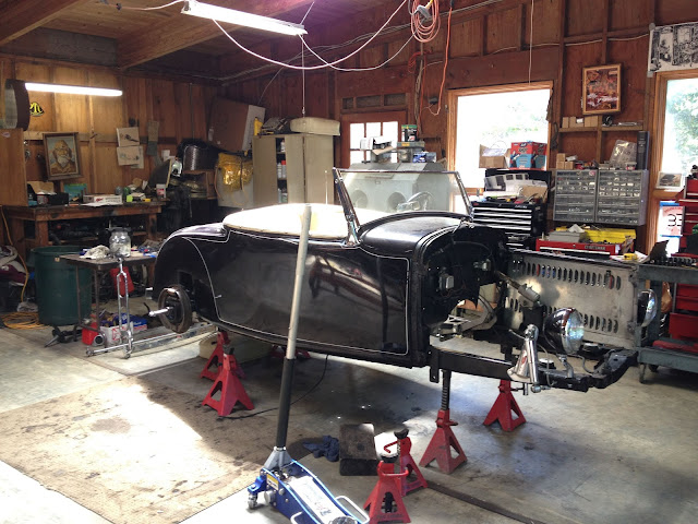

    Here is the front end blown apart, we need lots of parts, swapping out the axle as it looks like weak silly putty.

    The guy before me was going to street rod this car, I am so glad I saved it from that fate. He did hack out the trans mount though so that has to be replaced, We am upgrading the Master Cylinder and Pedal assembly as well as brake lines for safety. Clay made quick work of the old cross members and all the parts are on order.

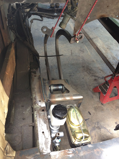

    Clay is making quick work of the new pedal assembly now that he got the old cross member out.

    that is a large hole of nothingness...
    looks like that brake setup should be much more better :)

    Like the front axle, I'd keep the original pedal assembly too, in case somebody in the future wanted to reinstall it.

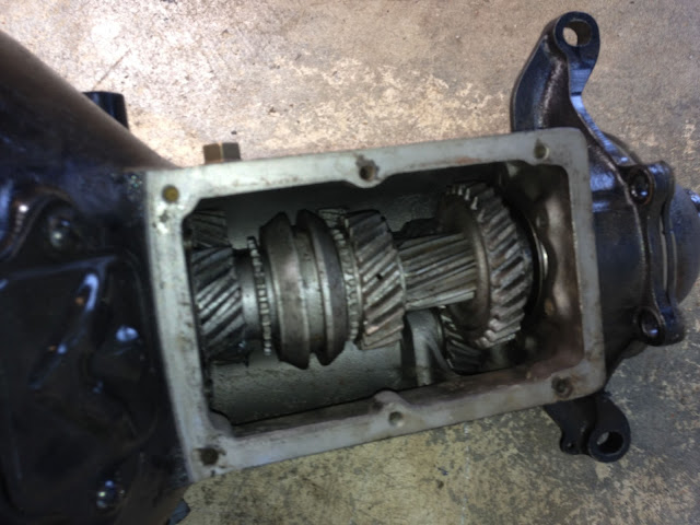

    Trans is pretty roached, so we will be rebuilding it, or if that fails replacing it.

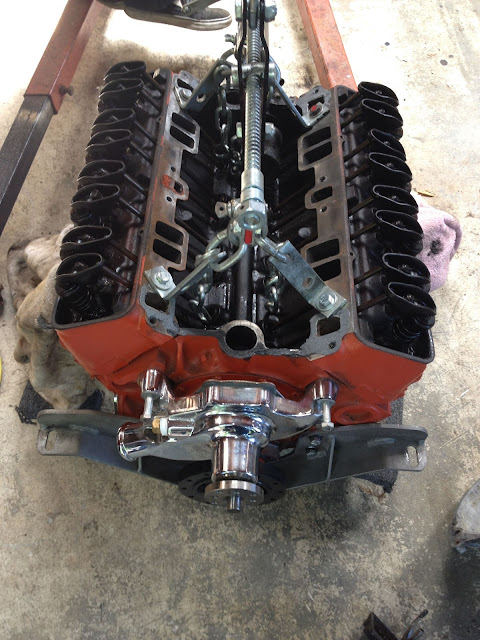

    Engine is a 57 has 2 different heads, also needs a rebuild, gotta find a head for it.
  18. crashtest22
    Joined: Aug 23, 2011
    Posts: 10
    crashtest22
    looks like that has not seen oil for a few decades

    Engines are just air pumps, they dont care what heads are on them. Once when I was dirt broke I had a bronco with one 289 hipo head and one 302 big chamber van head on it. Ran like a top ! Neat piece of history you have there. Personally if thats the way it was Id leave it like that
