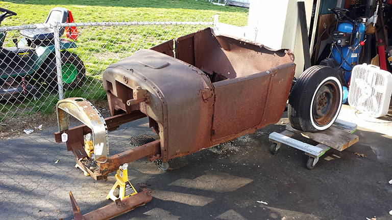

    So, this weekend I went up into NH to buy what I thought was just an average, abandoned T project pile of parts. It turned out to be what I think was a late 40's to early 50's built T modified. And the workmanship is impressive. Look at the welds on this thing; even with as eaten up as the sheet metal is, the thing is still solid. I'm not sure if the pictures will show some of the dime stacks or not. The way it's built is very clever. It looks to me that it was built by an ironworker. Lots of angle iron, plate, & sturdy welds.
    Unfortunately the front end was lopped off but as I understand it, the frame was reversed and the rear crossmember was somehow used up front. (That radiator shell is mine, I just put it on there to dress it up a little while it sits in my driveway).
    Does anybody recognize this car from the Northeast from the 50's or 60's?
    Thoughts are it may have been made on a military base.
    The rear end is a 4.56 Dana 23, which I believe was only used during the wartime years in military Willys MB & Ford GPW Jeeps. The firewall recesses look like they would fit the Willys L134 Go Devil flat 4 too. The springs are from the T front end just cut in half

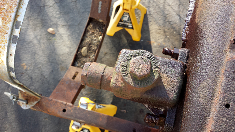

    GMC Delco Master Cylinder from the looks of it. It's mated to a swing pedal setup behind the dash.
    Relocated the stock T brake lever. Looks to have been tied to the parking brake cables at either end.

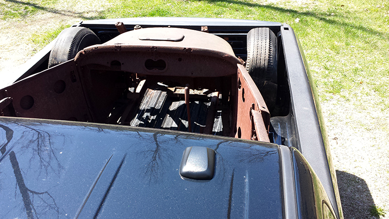

    Here's some of the Channeling:

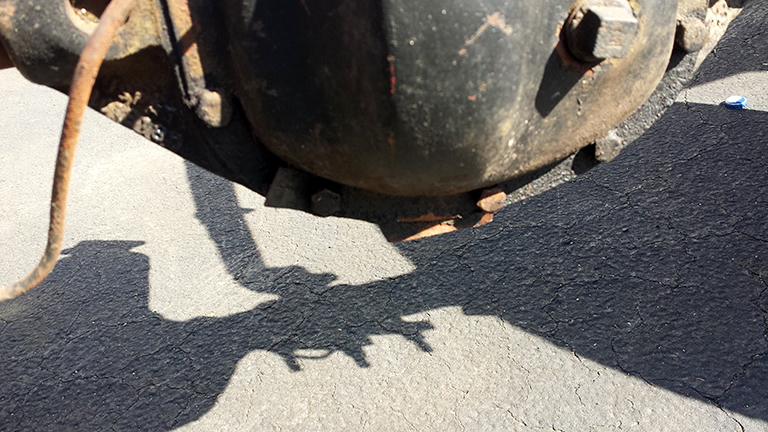

    The 4-link quarter elliptic rear suspension is pretty interesting. Judging from the tires, I have no doubt this car was driven, if not on the street, at least on a strip or street racing.
    Looks like a GM swing pedal setup but I don't really know. I also don't have any idea how this thing was steered.
    The front bones are mounted with angle iron that has half inch bar welded to it and then they ran a taper through it from what I can tell. They are bolted on.
    I dropped the plate on the rear; the gears look pretty good. The impurities in the old oil seem to have helped the oil cling to things back there. I swiped a little off and saw clean metal. I poured it all back in there when I was done.

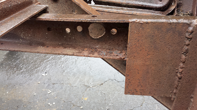

    For clarity's sake in trying to ID the engine and transmission combo from this car, here's the Transmission mount / center crossmember:
    And here is the Engine Mount / Cradle (I think):
    I'll grab measurements when it's nice out (raining today)

    I'd bet $1 that those swing pedals and that master cylinder are Tri-5 Chevy sourced. That might throw a wrench in the late 40's to early 50's build date unless they were swapped out at one time.
    Also, it would seem odd to notch the firewall that deep for the very short Jeep 4 cylinder engine, if I had to guess I would think that car held an inline 6 or bigger. Otherwise, why all the engine setback?

    Well, the MC cap says "USE G.M.C. BRAKE FLUID" and it's a Delco unit. But I agree, the pedals do look like they might very well be tri-five Chevy. When it's nicer out, I'll get up under the cowl with some light and look at the bracket. Oh & BTW, the brake pedal still works! The clutch pedal is locked up though.

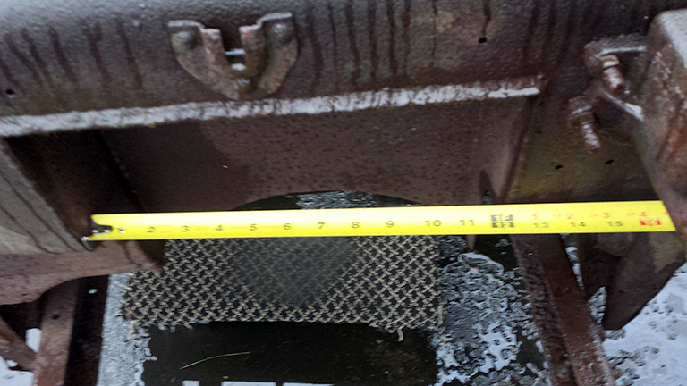

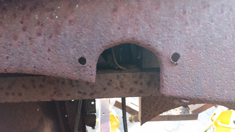

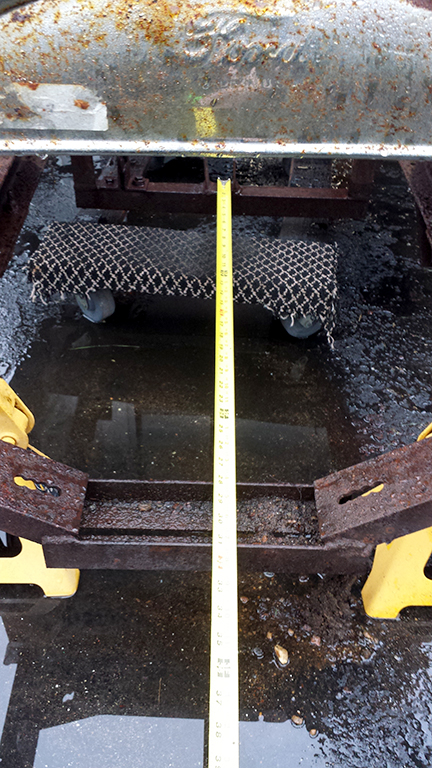

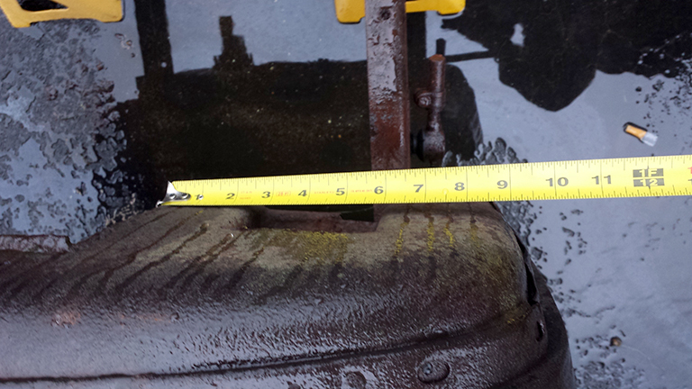

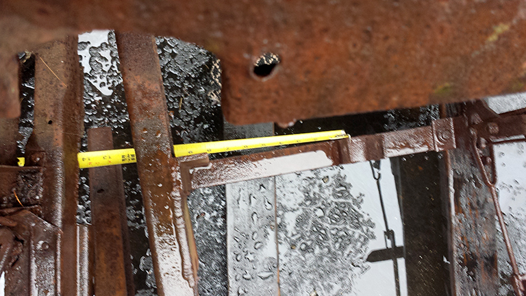

    I am actually starting to wonder about a straight-8 or 6. I took better pictures of the crossmember with a tape measure yesterday. I found it to be offset favoring the weight to the passenger side in the cradle and slightly at the trans. I'm wondering if this was a single seat car and that was done to balance the driver out because I don't think, considering the fabrication and design, that it would have been a sloppy accident.
    The MOPAR Slant-6 is a suspect because of its low engine mounts. The MOPAR Flat-6 is also; I found this picture of a P-15 mount bracket:

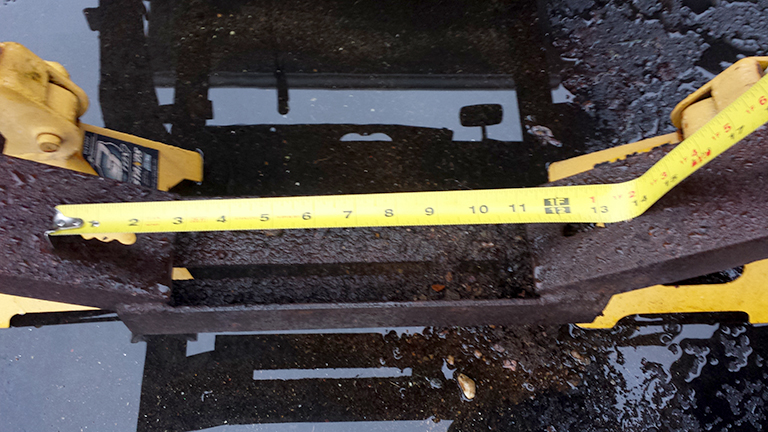

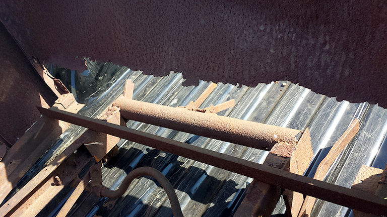

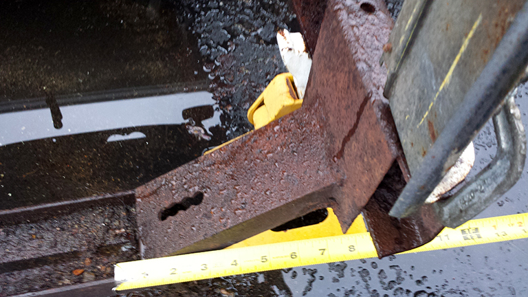

    And here is the measurement from the back of the trans crossmember to the cradle:
    The relief in the firewall looks just about centered though:
    Thanks, Ed!
    No sign of a roll bar, seating, or fuel tank mounts found so far. Those must have been too good to leave on this car and got re-purposed, salvaged, or stolen while it sat.

    OHV Ford 6 mounts are higher, I've got that 300 under my shelf. The Slant 6, like I said above, is a suspect but I'm not going to rule out the Flat 6 yet either.
    The cradle could be made from drilled scraps too and not an engine mount at all.
    [​IMG] <- angle looks wrong but getting in the neighborhood.
    But, it's all academic at the end of the day. I don't own a MOPAR Slant or Flat 6, I don't want to drop my Ford Big 6 300 in it, and I have TWO 265 SBC's that I need to use up or sell ASAP.
    SO, THE PLAN comes down to planning the frame repair and build-up to take the stock 165hp SBC and one of 4 transmission choices:

    I have 2 ideas for the frame:
    A. weld 1" to 1.25" +/- angle iron along the length of the bottom rail (face-in) and then box with 4" plate along the inside. Should/could probably drill and dimple it for strength and access to the inside of the rail to run wire.
    B. Put one of the other T frames under the frame that's there and box with 6" plate as needed.
    I'm more a fan of option A with this car because B would kinda un-do the look of the channeling.

    I would run an spring behind axle with split bones, run this frame, go stout/agricultural/truck style on all matters of frame, run 265 and 3speed, with your rear set up (fixet but as is), and run it bare to the bone! Literally, bomber seats and no cushion or Willys jeep seats like some of the old modified (Dident the Pierson brothers coupe run one also?)
    I like what you got their, I like the heavy brackets and angle iron, in the sense it's crude and era perfect!
    I would love to see a build with a very "Rigid" frame (less flex), with torched out brackets and stick welds. :eek:
    And before anybody yell RR after me hear this; for a guy with the right skill set it's possible to cut with a torch with out have slag or barcode edges, with out have something that screams water jet and Riddler finish (think niekampf rod with out files). Just simple solid brackets with no more then one hole or just one swervy edge.
    And it should be possible to weld a piece of angle bar or flat stock to a
    frame with out it has to look TIG welded or low-flying-albatross-droppings.
    It would be refreshingly different and again, era perfect.
    FYI I like old tubular crossmember, as far as I recall, Dean Lowe RPU ran Seamless tubing as crossmember a in his Frame modified by Kurtis Kraft.
    Did anybody read/understand my weird message about engine mount placement regarding frame length? Or is that just a matter of optic illusion on my eye sight?
