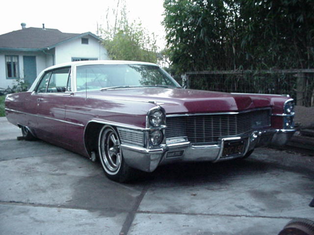

    Ok Here it goes. My buddy has a 65 caddy. We cut 2 1/2 coils out of the front and 3 out of the rear. The car sits low and It handles about a million times better. It takes all the floating sensation out of the car and really tightens things up without making a rough ride. You can thank Caddilac for putting springs in that are like 20 feet tall. Also he put a set of KYB shocks in the car and that helped a ton also. I think the shocks he used are from a chevy LUV pickup. Cause I dont think KYB makes anything for your application. My brother has a 64 Cad and we are doing the same thing to it also. We swapped disc brakes onto both cars so that will be a different story. You wont be dissapointed with the cut springs and you cant beat the price. [​IMG]

  11. Hey SLAMIT we talked in Santa Cruz before, your down south now? Man that car does sit low and is super bitchen with the swap meet Radirs on it. I want to know more about the disc conversion.
