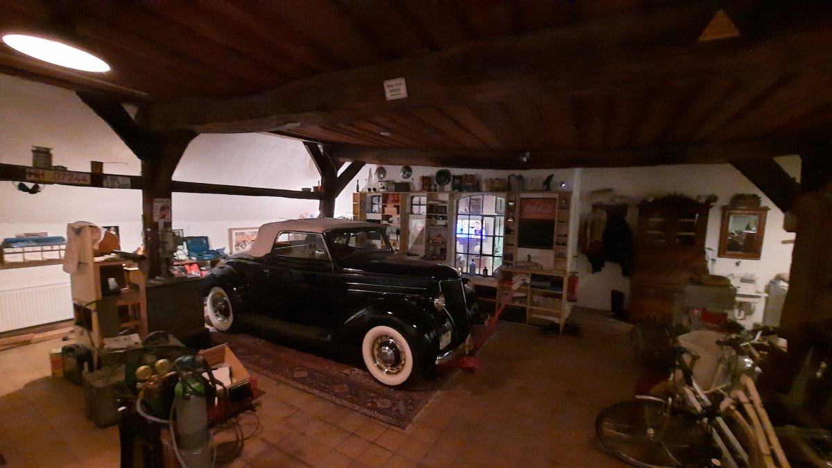

    Need more pics of the garage please. It looks wonderful from what can be seen!!
    Chris

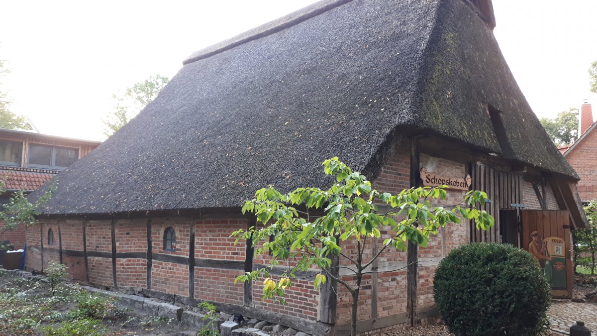

    My family and the 36 live in an old thatched house. 200 years ago sheep used to live in it.
    Behind the garage is our living room. 20210112_201912.jpg 20180730_203016.jpg

    Sounds expensive, since the O/P says he is in Hamburg. Of course, that might be Hamburg, Minnesota, but I've been there several times and haven't seen that particular house.
