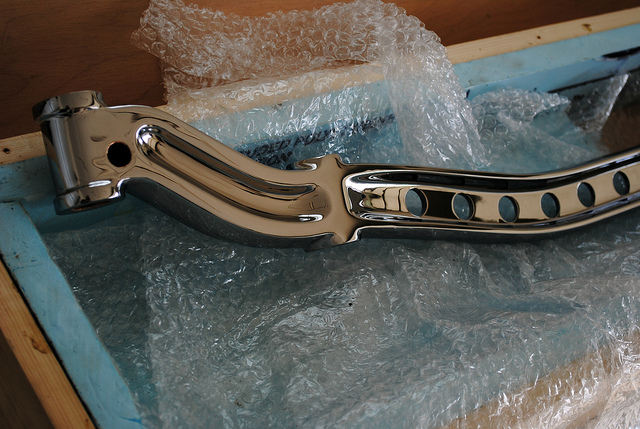

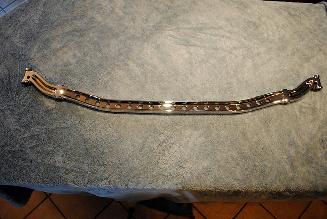

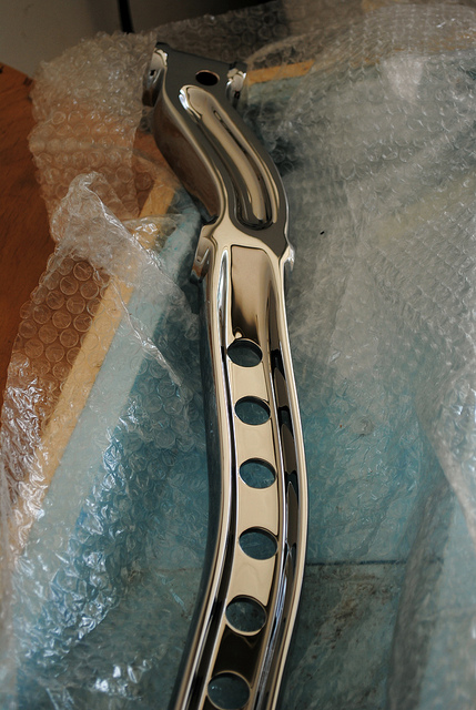

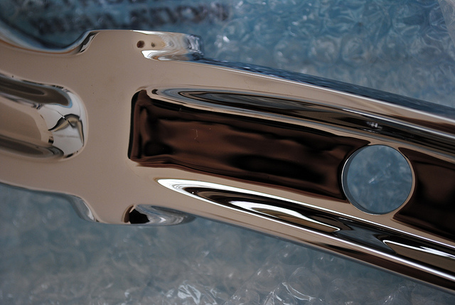

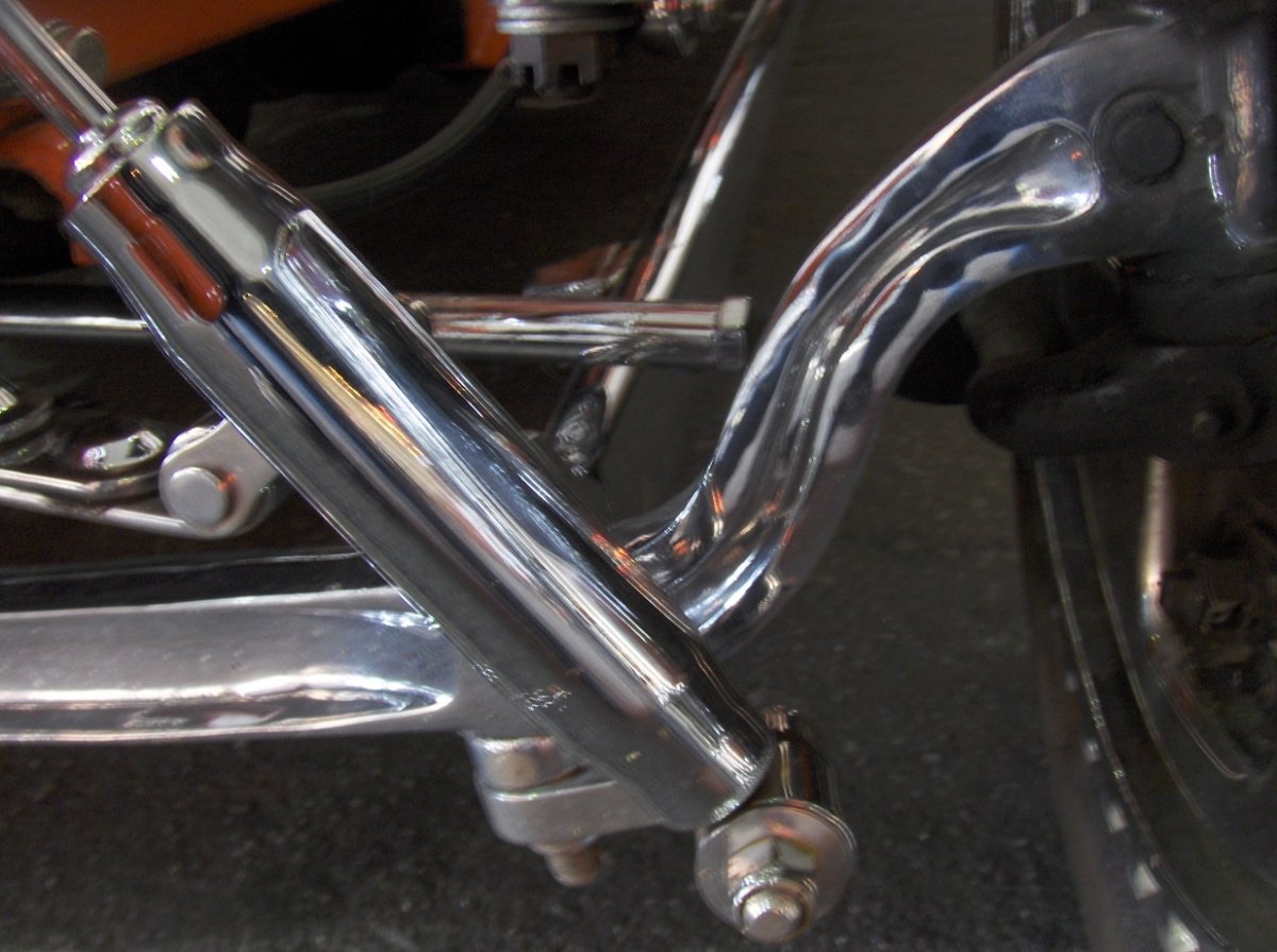

    6888031989_8d5b6b596a_z.jpg 6888037439_b5ba700abb_z.jpg 6888028841_47ae72d0ea_z.jpg 6888034721_a832d5caac_z.jpg Super sexy stock, albeit drilled and chromed early Lincoln. 6888028841_47ae72d0ea_z.jpg 6888034721_a832d5caac_z.jpg

  8. DDDenny
    Posts: 19,136
    Pretty standard for back yard/back in the day axle mods.
    Strictly speaking safety, people that know Fords oem axle dependability after modding would say "what's the big deal", run it!
  9. DDDenny
    Posts: 19,136
    Harv
    I'm guessing you prepped that one, has your signature perfect detailing.
    Who plated it?
    Just beautiful!
  10. 117harv
    Joined: Nov 12, 2009
    Posts: 6,589
    117harv
    Not my work, but thanks for thinking it was. It belongs to member (bib overals) I'm not sure if he did the prep or where it was chromed.
    I am working on an axle now for a member that I will post here when it's done. :)

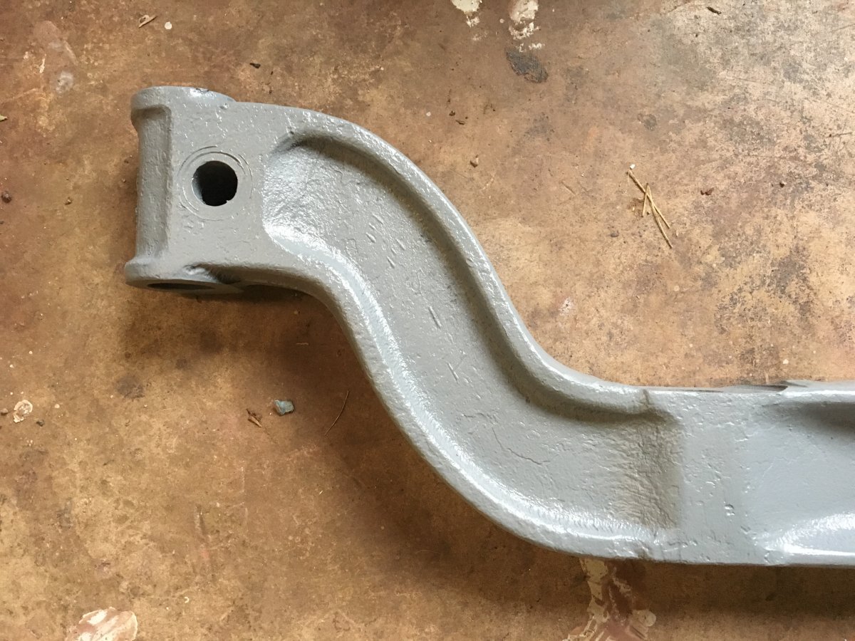

  11. I respectfully disagree, unless backyard involves a 100-200 ton trip hammer (that's what makes the web so 'squished' looking). This method was used by Ed Stewart for his "Dago" axle and I'm 99% sure that's the ID of the piece in question. Homebrew axles were most likely taffy-pulled, just as they are today. Need to see more pics to be sure @Internet to positively ID, but at first glance, I'd say it's a genuine Dago.
    Here are a couple more of mine;
    (and yes, I know the spindle is on the wrong side...was only going for a mockup...)
  12. DDDenny
    Posts: 19,136
    GW
    I figured the backyard part would trip me up.
    I always thought Stewarts operation was a home shop deal, maybe set up more professionally.
    Are you saying Dagos' axles are, or are not "pulled taffy" looking. ? Your photo example?
    Not sure if I understand, the way your statements above read, has me somewhat confused.
    Not say'n your wrong, cuz I wasn't of hot rod age then, and never owned one.

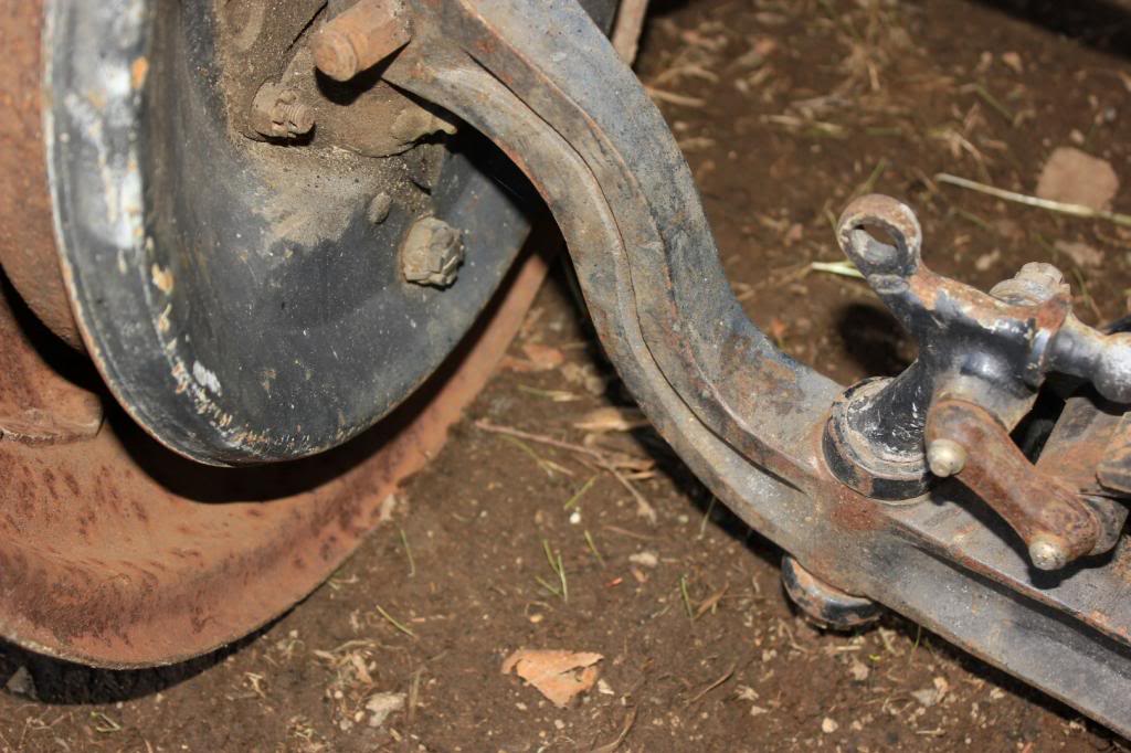

  13. Fortunateson
    Joined: Apr 30, 2012
    Posts: 5,331
    Fortunateson

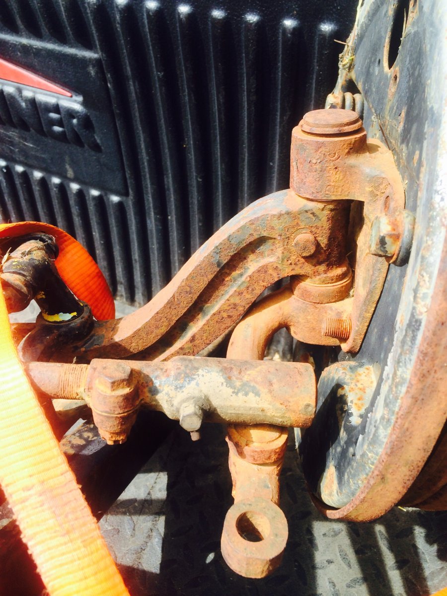

    I have identical as your 4th pic as well as the pic in post #132. However my has been drill for a shock mount just where it sweeps up. Don't know if I'll fill it and run original shocks or not. Where did you filled axle come from? Up here a number of guys have id'd mine as coming original Green's speed shop in the Vancouver area. Now I'm not so sure. Tardel questions the point of filling the outer webs but I know it looks re are two areas that are a little worn where the spring eye has worn on axle. I guess I could just weld those up and grind "to taste"?
  14. Thanks for the opportunity to clarify; unfortunately, some of these terms have been bastardized and/or are used interchangeably. "Dago" is a term most properly used to describe the hammer-drop method popularized by Ed "Axle" Stewart. From what I can tell, Ed's axles were first referred to as "Dagos" in or about the late 1940's after he relocated his shop to San Diego - but since that time, "Dago" has used to describe the stance of a car (that car's been "Dago-ed") and, sometimes, as a generic reference to any dropped axle. (It is thought that Stewart began hammer dropping axles just after WWII, as they show up in photographs in the immediate postwar period...many examples can be seen in the "Lakes Pictures P.R.C." thread)
    If I understand the Ed Stewart process correctly, the entire axle was heated and the ends hammered; essentially re-forging the axle. (Ed was a heat-treat specialist, so I'll assume he knew what he was doing). Other shops and individuals used a different method; heating on the ends only and stretching - to various degrees of severity. The less-sophisticated and heavily dropped "heat & stretch" axles became known as "taffy pulled" due in part to the method used and their distorted appearance; whereas hammer dropping compresses and pushes the ends of the axle to create 'drop', taffy pull stretches the metal out. The famous Mor-Drop axles use a heat & pull method - albeit with a more moderate drop and less stretch than the classic 'taffy pull'.
    Some also used a heat, pull, and 'whack it' method (with sledge hammers) - it said this is where the 'filled axle' comes from (the heat, pull, and whack jobs are often bore the scars of their re-formation so guys would fill the web to conceal the dirty work and make them more aesthetically pleasing)
    While it is true that Stewart worked out of a small garage/shop, his method required more specialized/dedicated shop tools than a simple heat & stretch job. Your average Joe could make a jig, grab a torch, and taffy pull an axle - many did and still drop axles in the taffy-pull (heat & stretch) style; not so with the hammer-drop method.
    Heat & stretch;
    Ed Stewart (Hammer drop method);
  15. DDDenny
    Posts: 19,136
    GW
    Thanks, great getback response and details.
    I think that the reason I'm still (only slightly) confused about the old axles is the term "taffey pull", it's not new to me, I just thought it referred to the way they looked when guys did them with less than professional methods/tooling.
    The photo with rusty assembly won't load, but that is what (to me) looks like an "average Joe" backyard job.

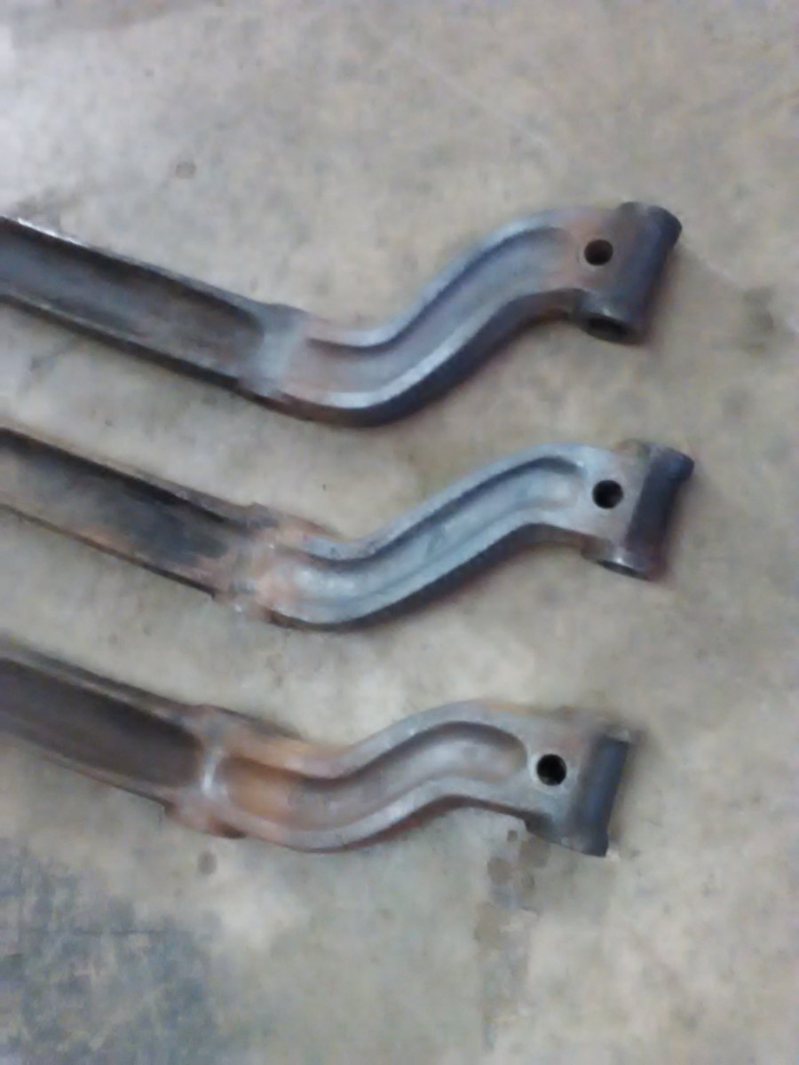

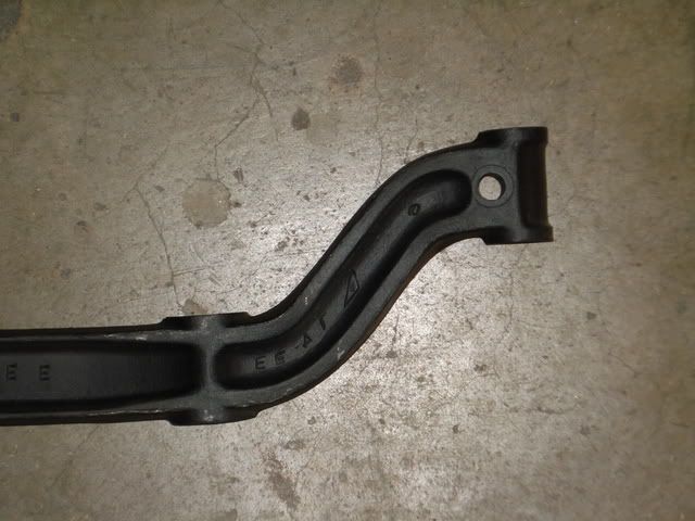

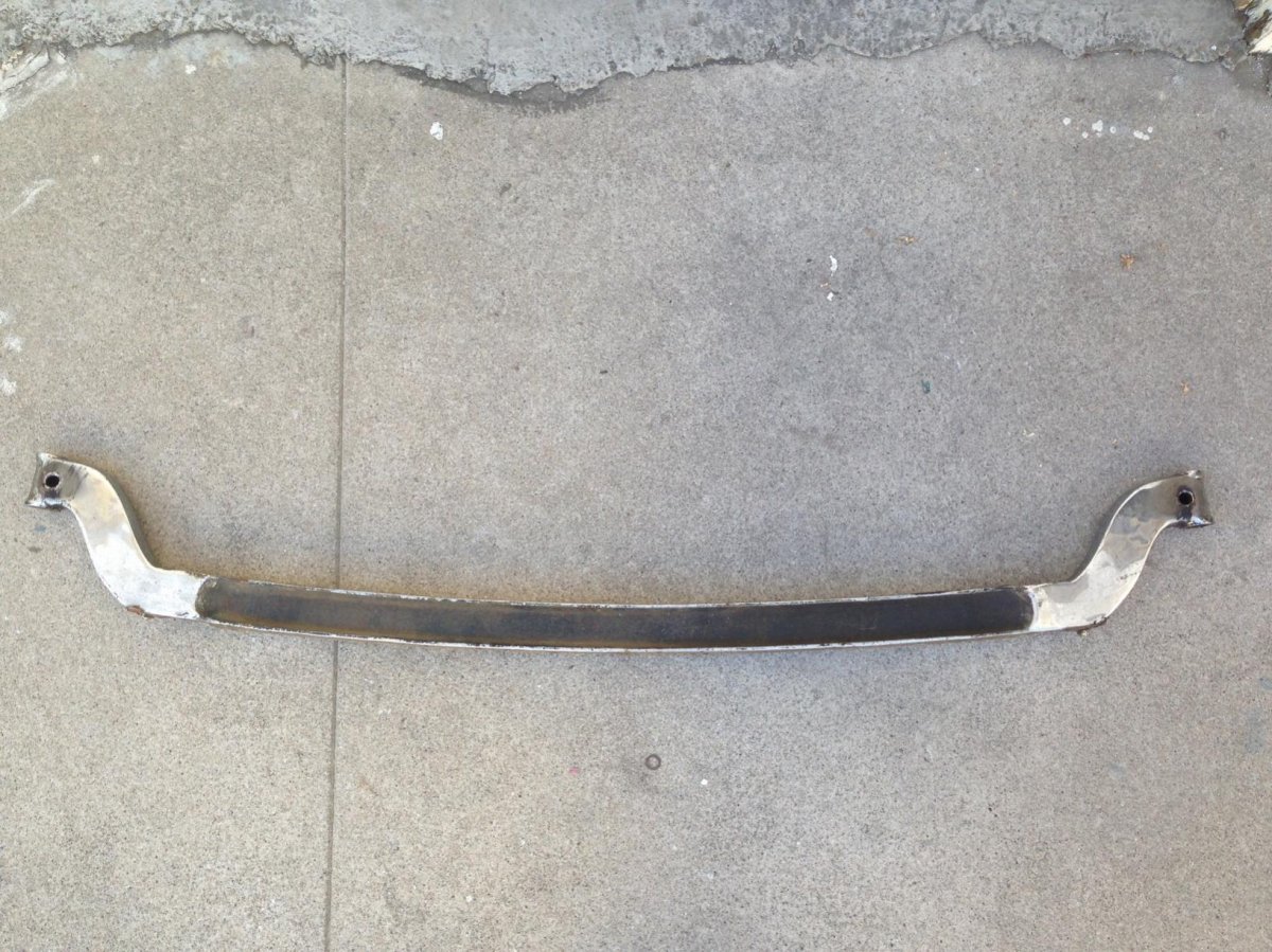

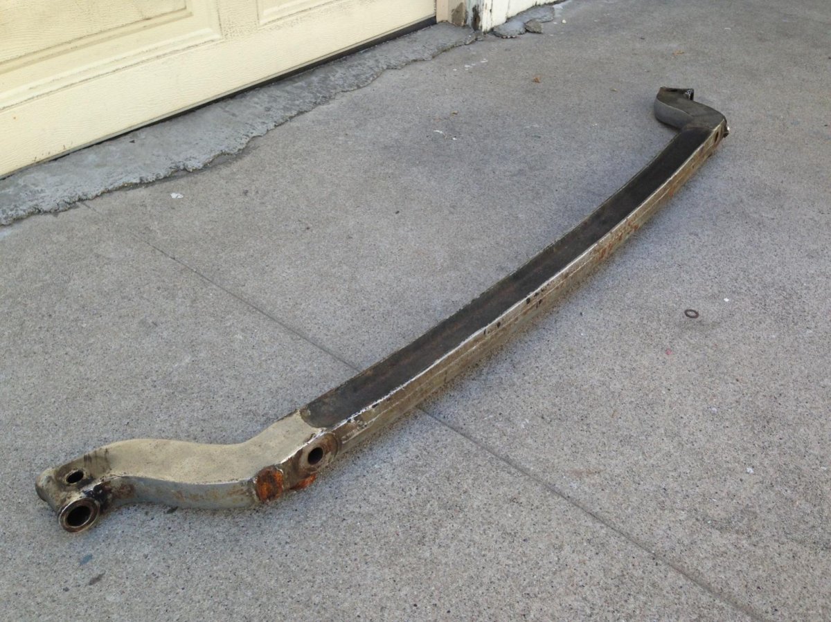

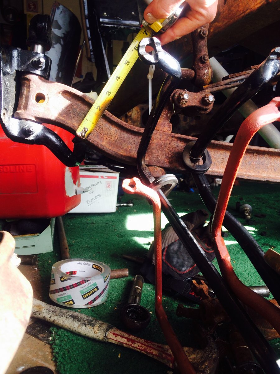

  25. image.jpg image.jpg Here's one I got today with a chassis I picked up... Northern Cali. Anybody got an idea who dropped it???

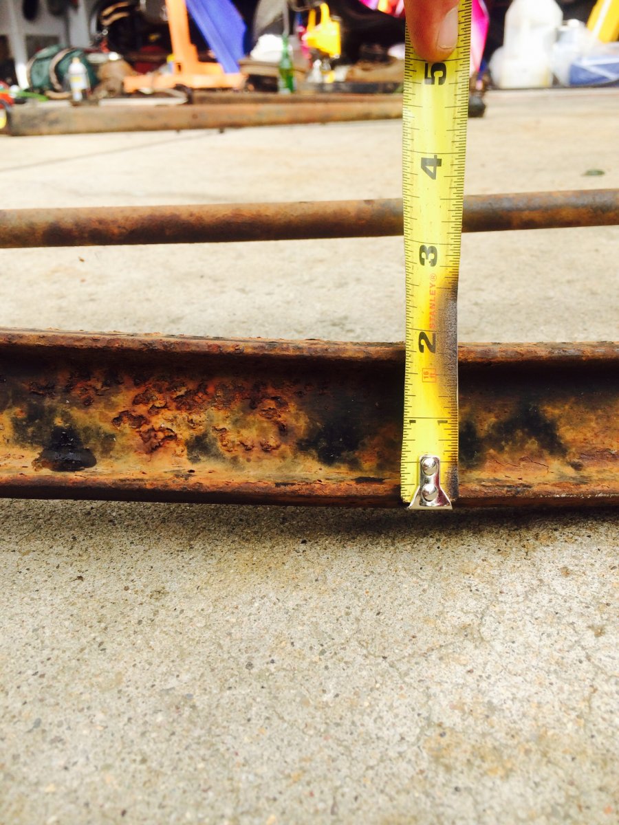

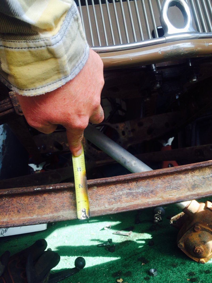

  26. image.jpg image.jpg image.jpg image.jpg View attachment 3157278
    Here are some better pictures. Also look at the difference in measurements between stock heavy and pressed heavy. Not sure if it's true that the dropping process squishes it 1/4 inch??? Bitchin axel anyway. First and second pic is stock. Other two are dropped axel.

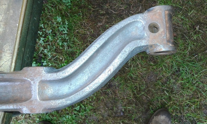

  30. Check this one out.....
