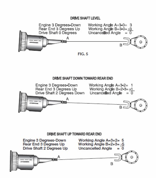

  2. If one builds a hot rod and uses a bullshit pseudo fact as a "standard" without understanding it's easy to end up with problems. In this case, using the rules trans 3* down to the rear and parallel shafts.
    Both regurgitated endlessly and a perfect way to fuck the car up and fuck yourself out of time, money, and enjoyment. Those so called rules aren't going to fit every application, while the equal U joint working angle does and the only one that matters.
    Just for a poll here, who says the top picture has a pinion pointing up?

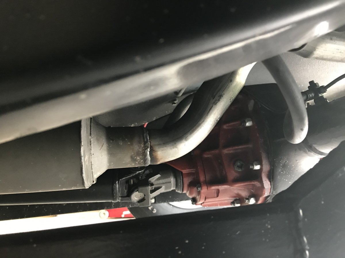

  3. Eric Satterfield

    Does the car need to be at ride height to get this correct even though there is no twist in the suspension?...This may answer a few more questions? IMG_0618.JPG IMG_0619.JPG

    The angles are to each other, NOT TO THE WORLD. There's an over abundance of opinions that think it's from true 0. 31 Vic is right, working angles. Sometimes communication doesn't spell that out fully so if that's what some are saying don't take it to heart.
    After the pictures, I'd have an additional hole in the forward mount and get whatever I needed. The hole might be up or down from what's there to "get there from here" and achieve a working angle. You're not too far off, in fact it's almost home.
  5. This visual aid is wrong.
    I wish it would go away.
    Please don't use it as a reference.
    Read the descriptions and the errors will be apparent.
    The pinion is pointing in the same direction as the engine , the last one is clearly level or at zero

    Joined: Mar 2, 2001

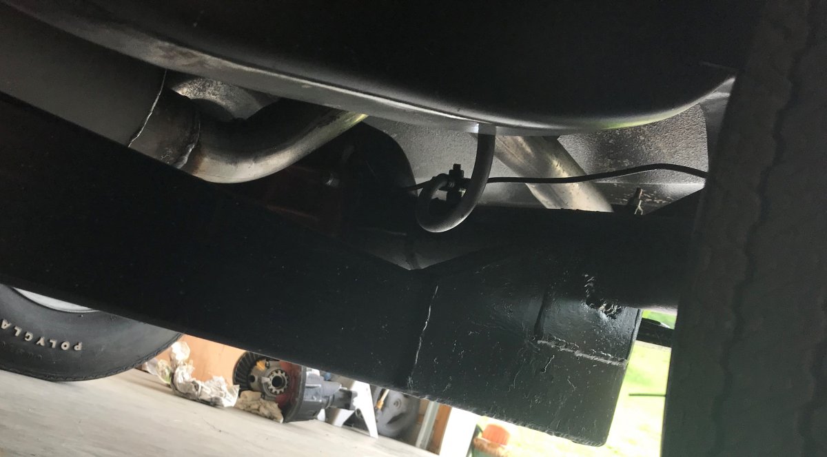

    Ok....I currently have the frame supported on jack stands and removed the bolts holding the rear spring in the mount to allow the rear down on jack stands also..By removing the traction bar/control arm bolts and allowing it to swing up I gained 4 degrees of angle..If only it will stay there..I have to go get a 5/8 bit tomorrow to drill the higher hole in the bracket. It looks as if the spring mounts will need some tweaking in order to get the spring back in the mount at the new angle.All hopes this will cure the problem.Thank you all again

    Ok so how big are those joints at the front? how are they mounted, tab on both sides or just the outsides? When you cycle the suspension does that arm ever make contact with the frame? Ladder bar or does it have upper arms too?

    Can anyone explain how the rear spring works being flat like it is?

    Thinking aloud, presumably the spring mount on the crossmember could be (wedge) shimmed to eliminate the spring bind thus avoiding making alterations to the spring mounts on the axle? Still concerned by the lack of flex in the truck arm arrangement though. particularly as we've now learned it's mounted with heims.

    I think we have given a solution to fix the poor guy's minor problem (the pinion angle and maybe driveshaft length), but the problem of the arms being too wide at the front and causing stresses during big articulation will probably make his head explode.
    He already said his wife is riding his hide about the fixes the car needs, lets not suggest he rips the whole rearend out and builds a total new suspension system.

    Before you do this,
    Look at this photo...
    The verbiage stated would lead one to believe the transmission and the pinion are running the same direction. Trans negative, drive shaft negative, the pinion negative,, right?????
    Well that pinion is going up hill to the rear. Let's assume the numbers are right, and just the NEG/POS description is bassackwards. Remember the working angle of the ujoint need to be , it important, it's imperative they are equal. The front joint's working angle is 0.3* the rear ujoints working angle is 7.4*. Grossly un equal.
    The Internet crap about Trans down, pinion up is missing the part where you turn yourself and your angle finder around an do the Hokies pokies. Fuck it pisses me off to no end. That because guys do this shit above,,, I got news for you guys, that pinion is up, it's not negative it's positive. That rear ujoint angle is botched but good. The pinion needs rotated 7* just to start getting close. All the brackets need to get cut off and redone,,,bars, hangers, shocks.
    From what I gather here is that it was already cut loose and rotated 7* - it needs 7* more.
