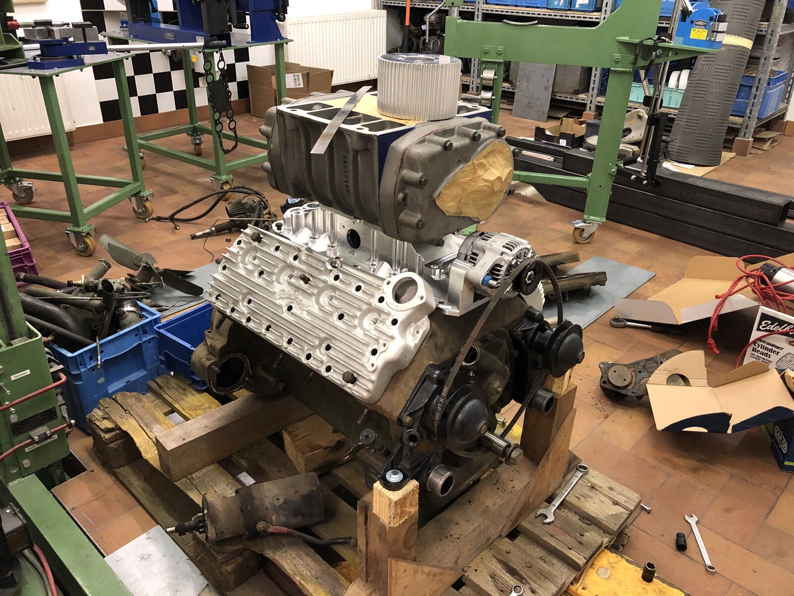

  7. The “tool” used to hold the lifters stationary is at best very hard to use. Drill the holes as low as you can get the drill motor in a low position. It’s not that critical to be precise with your new holes/much easier than using the “tool” that slips off the lifter too easily!! Flatheads Forever! 6E8D339B-4502-40F1-9464-7C11D930ABA6.jpeg 47EBF12A-2773-4BD0-AC23-1CFA502140FC.jpeg 24E93E2C-34CD-4B88-A408-BAF5413955F8.jpeg

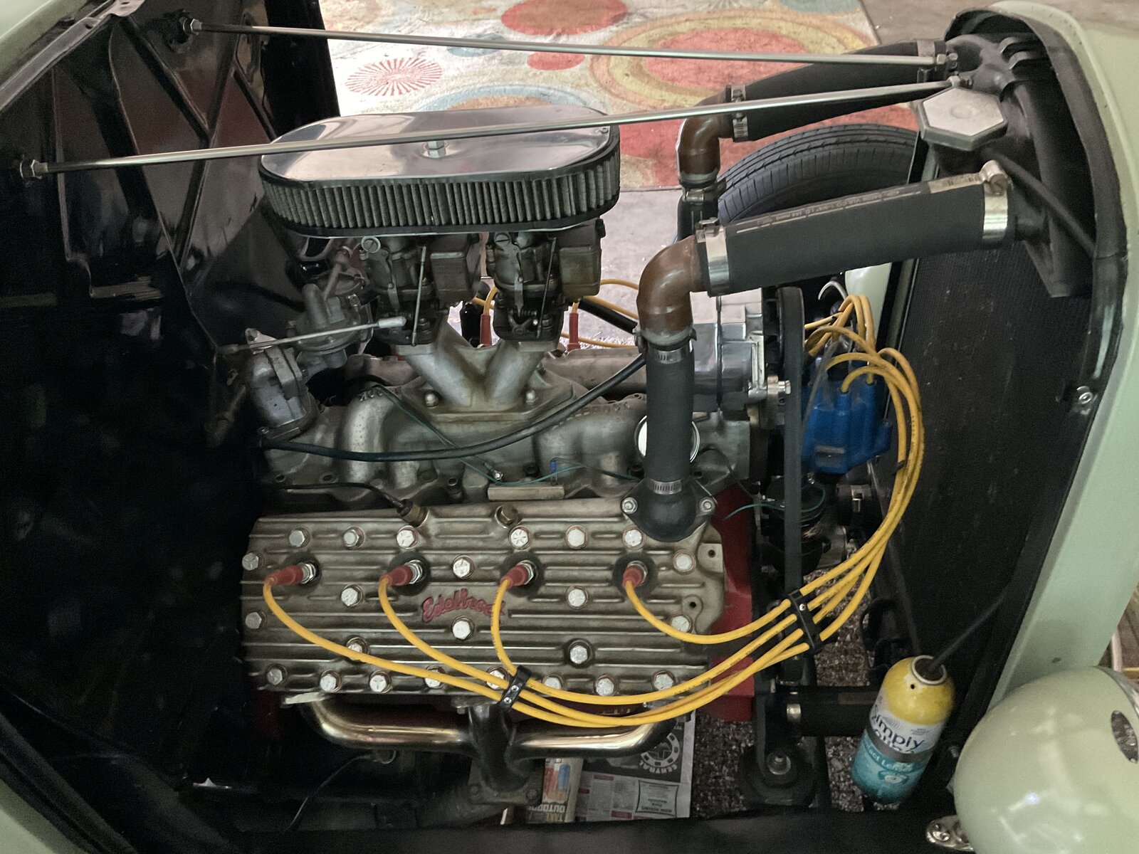

  11. GordonC
    Joined: Mar 6, 2006
    Posts: 3,141
    GordonC
    Here's a pic of where I drilled mine. No specific measurement really, just where they will work ok and make it easy to get at.
