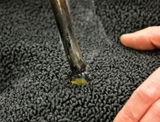

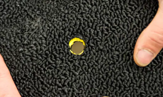

    I place the seats in position before adding carpet or jute and pre-drill the holes. When the jute and carpet go in, I take an old punch and heat the tip with a torch and put it through the hole from the bottom. It goes through the jute and carpet easily and melts the edge of the holes so they don't unravel and I know it's in the perfect position.

    Soldering iron. Burn through, way easy. I also used soldering iron to punch holes through vinyl I covered my headliner as well.

    I use a phillips screwdriver, heat it with a propane flame and melt the hole I need.

    I burn em. On carpeted door panels I use a pointed awl, heat with torch, poke through the carpet and align the small hole in the door for the screws, works perfect.

    From a professional point of view? Screw holes / bolt holes I use an electric soldering gun. Makes a nice melted edge , never seen a flame in over 50 years at it

    When my wife wanted seat belts in our second 1940 Ford Sedan Delivery, the whole area was carpeted. Under the seats and behind, matched the carpet in the back of the sedan delivery. My neighbor had installed some carpet in his old car and used an old Weller soldering gun with that curved blade that looked like a little toy pistol.
    I told him that I needed to install the seat belt bolts and huge washer. He suggested that I use the Weller Soldering Gun tip to open the hole as wide as I need for the bolt. The big washer could go under the bolt head and small hole in the carpet, so it would not be seen. The carpet strands would be melted and not fray, like drilling. It was simple and neat. Besides, it was a very small hole.

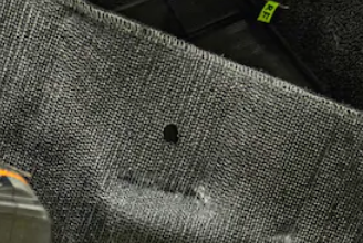

    wow!! i guess it wasn't a dumb question after all. i have tried most of the ways in the replies. my concern is the holes are already drilled and i was going to heat up something and go up from underneath. it doesn't yet, but it will have the sound deadening and the jute/carpet backing on the floor. i was worried it will catch fire and burn up. i think what i will do is, put the sound deadening down and cut it however and then put the carpet down and cut it with the x way. i do like the soldering iron style.
