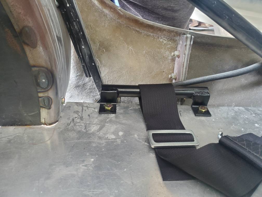

    Well today we sat out again to bleed the brakes and clutch but didn't quite make it. We sort of got caught up in fabricating the safety belt side mounts.
    When I say side belts I mean lap belt. The outer mount was a no-brainer.
    A couple of heavy angle iron brackets with a length of roll bar tubing welded between them. The brackets are spaced to bolt directly to two of the chassis outriggers after going through 3/16 aluminum plate floor pan.

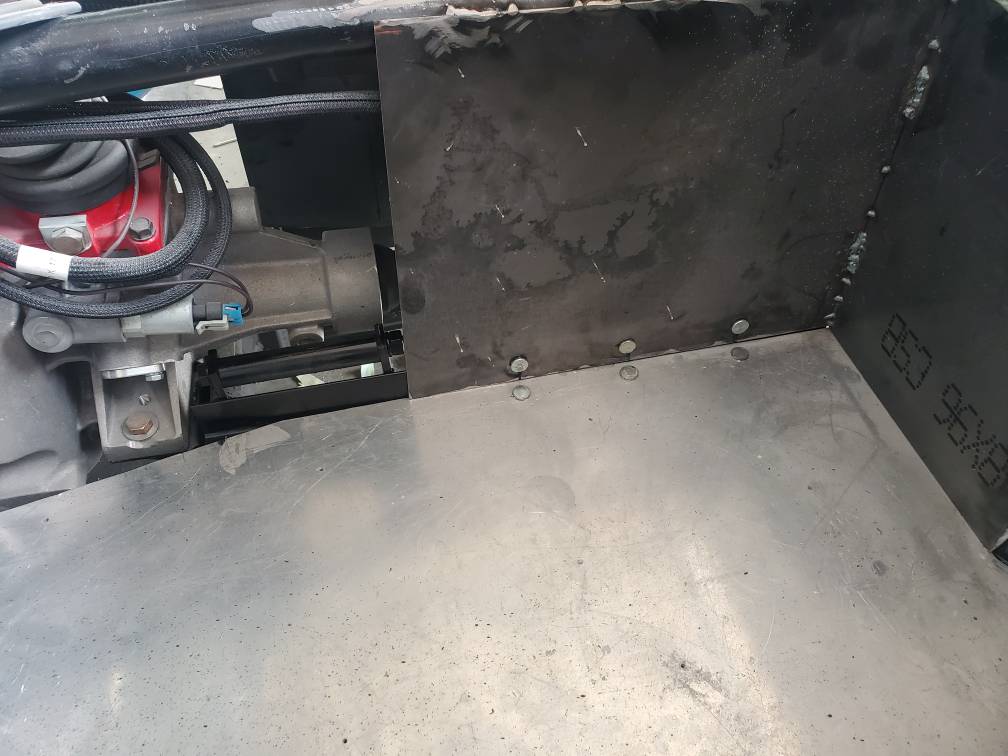

  7. Deuced Up!
    Joined: Feb 8, 2008
    Posts: 4,206
    Deuced Up!
    The other side was a serious pain in the back side. There was simply nothing other than the trans cross member to mount to. After an hour or so of studying the area we decided the only way to make a solid safe mount was to utilize the floor pan and the side plate of the driveshaft tunnel.
    We took a a piece of angle iron and secured it to the 3/16" aluminum floor and the 1/4 inch steel side plate. (The steel plate is protection from the drive shaft.)
    Now the seat has to be squeezed into that area so we used flush fitting bolts. This really made it a very strong corner and the front of the angle iron sits on and is bolted to the trans crossmember. In that area we fabricated a similar lapbelt mount from the other side and welded it to the angle iron.
    Sent from my SM-G970U using The H.A.M.B. mobile app

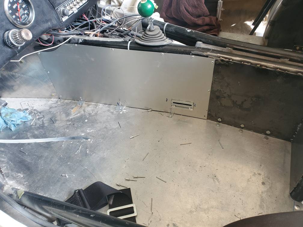

    Then we finished the tunnel sheeting on that side and installed a matching turn buckle piece same as the shoulder straps

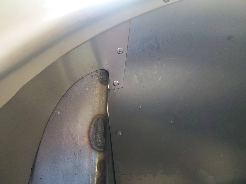

  9. Deuced Up!
    Joined: Feb 8, 2008
    Posts: 4,206
    Deuced Up!

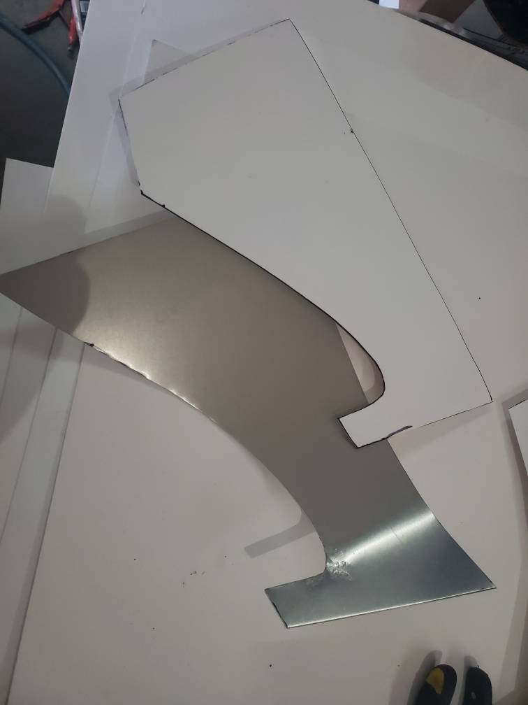

    We also did some cockpit housecleaning. We have several small, complicated areas to address with aluminum sheeting.
    This is the transition of the rear firewall as it makes the turn at the rear wheel tub. The first thing we did was create a poster board template.
    After several tries and edits I cut the final pattern out of aluminum and pop riveted it in place.
    It looks really clean.

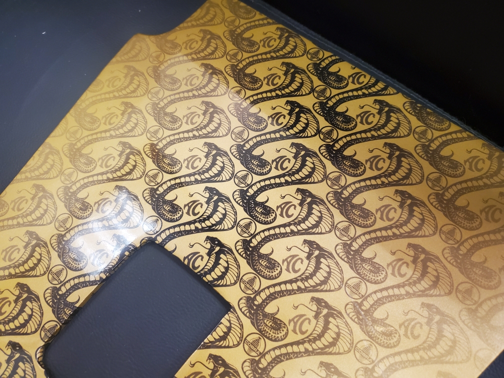

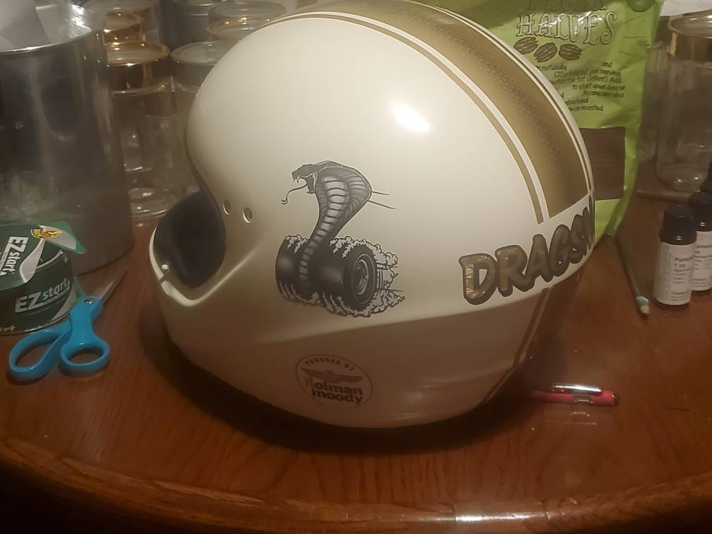

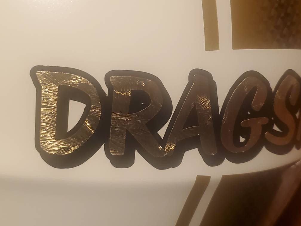

    I have a few more graphics for it. Then we wait a few days and clear coat the living daylights out of it, graphics and all!

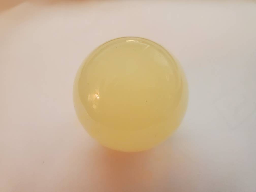

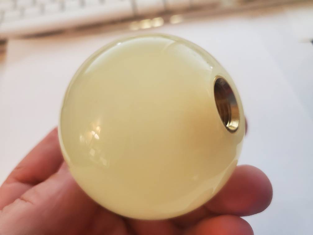

    Man! What a disappointment on the shift knob.
    When I opened it it was more of a murky yellow green than off white.
    The box said off white and part number was correct. But this stupid thing looked like a cheap glow in the dark toy out of a cereal box. After looking at it for a while I decided to test it. Sure enough!
    Yep...this is not what I ordered! LMAO
    Sancho, Nostrebor, loudbang and 5 others like this.

    Jackson, I am keeping the glow in the dark knob just for you buddy. At least at those night races you will be able to find the shifter if not the actual gears! LMAO!
