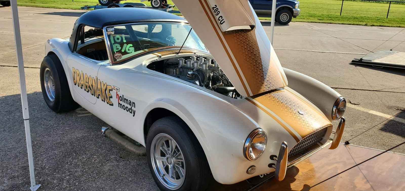

    Well the Cobra awoke with a very nasty disposition, LOL. Pretty much the same one it had when we put it to bed. We are a bit behind on our schedule for the season. We missed the Daryl Starbird Show this year because of some craziness at work and then the Hot Rod Reunion at MoKan totally snuck up on us. It seems like it was early this year? Maybe not. Either way we missed it.
    Our first outing was a couple of weeks ago at the Stray Kats 500 in Dewey, OK. It was our first time at the show. I have heard about it for years. When we got there it seemed like half the folks we saw were friends from Missouri. I was thinking hell we should have just all went down to the Wal-Mart parking lot and had our own show versus driving 3 hours in to OK. But it was a lot of fun and hosted by some great folks. We actually won an award, "Built For Speed"...although I think that was simply inlu of a disturbing the peace ticket. LOL
    Here we are across the from Tom Mix Museum. Pretty cool place. Fun Show.
    We are getting ready for Jackson's little soiree in Ark City just a handful of weeks away. I pulled the center console cover yesterday, took it all apart and made the shifter hole larger. I could feel the first and second gear shifter throw rubbing a bit. We are going to get it up on the rack this weekend and nut bolt check all the suspension and driveline etc. then head to NSRA Nats in Springfield, MO the following weekend. If you are in the neighborhood drop in and say hello.

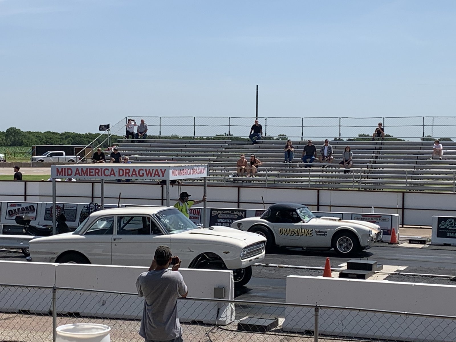

    Well not a lot to report from the great Battle at Midway Vintage Race, sorry for the delay, it has been nuts around here. We did not get to race the great red Mopar heap but it was just as well. It would not have been much to write home about as I don't think either car ran quicker than about 90 in the quarter...lol. Hell, I didn't even get the Cobra out of 3 gear in our two attempts. Jackson struggled as well with both his rides.
    We blew out of there after a couple of runs, hung around for the Prayer and National Anthem and then got out heck out of Dodge...I mean Ark City. A friend called to check on us later in the afternoon, we were just leaving my favorite steak place in Joplin. He asked how things went and this is what I typed:
    "Well we burned $300 in gas to get there and back, the car ran like crap, made two runs and done, 102 in the shade, no shade, decided to get a steak in Joplin and put the weekend behind us, Red Hot and Blue no longer serves steaks, heading for Pineapple Milkshake if they are out of Pineapple going to burn the place to the ground, get bail money ready!" LMAO
    But we had a good time and got to connect with lots of old friends we have not seen in a while. It was a fun event, better if the car had ran! It is a really nice track Mid America Dragway with some really cool history. It was prepped very well, reminded me of Byron and the House of Hook. Just wished we had something to with us to hook.
    The car is having several issues this season as we finally get the chance to work out all the bugs. And as of right now I feel like an overworked exterminator. We have two major issues, fuel and clutch. The very unHAMB like device in the car that does the fuel is a total POS. We have basically known this from the beginning but thought for our application it would work. We are about to give up on it and try something different. Right now the car idles around pounding the ground and making everyone's mouth water. It launches like a Banshee but then falls on its face quicker than a Fat guy in flip flops. (I think I actually speak from experience on both sides of that snide remark).
    Then after we do get it rolling again it does not want to shift. The Ram clutch guys have been scratching their heads trying to diagnose the issue but today I may have figured it out. I was talking to Tilton (the guys who make the pedal set in the car) to see if they had anything that would bolt onto the clutch pedal that would allow for some pushrod pick up options. They did not but their tech guy was really pretty sharp and asked what master cylinder we have on it. When the set came new all of them were 5/8" However when we upgraded to the RAM clutch I bumped it to 3/4" but he said that was not enough. He said I needed 7/8" to move the thing so I have one coming in a day or two, maybe that will get us shifting!
    Check our number at Midway...101. I told Zoe it was pretty fitting Drag Racing 101. LOL And as far as B/Gas we really needed a slower class with the way it ran. Unfortunately they only went down to D/Gas and I think we probably need to be around the K or L area! LOL
