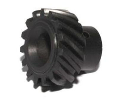

    Nope, correct gear, not sure what happened to it. High volume oil pump may have caused it. Looking at a composit gear for it now. Mixed reviews for COMPS offering, going to do some research.

    Cam gear doesn't have a mark on it. But it was seated correctly because it took every cog out top to bottom.

    High oil pressure will eat gears really quick. Buddy of my had a Buick 455 quit running right in the middle of the road, it sheered the gear clean off. He said at start up when cold, the gauge would show 95 or more psi.

    So ding ding ding @RmK57 you guessed it. I would have bet big money against it but that is exactly what I did. I changed the gear out on my Model A, I change it out on Dad's Coupe, I locked down the distributor and changed it out on the Austin and then I locked this unit down, installed a phasable rotor and dropped the stupid thing in just as it came out of the box, cast gear and all! You know there have probably been 2500 steps or more in this build. I suppose missing one out of 2500 is pretty good. But it is certainly a pain in the back side. LOL
