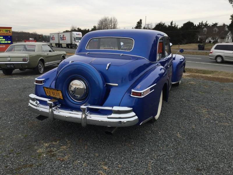

    Jack, thanks for the response. I rebuilt my pump and it's good to go, I was just not sure what to do with the vacuum ports.
    Desoto291Hemi likes this.
  8. Thanks for the reply. I rebuilt the pump myself and it's good to go, but I wasn't sure about the vacuum ports. I figured they've been open since I put the Cad in, but I wanted an opinion from someone smarter than me! Steve

    Nice Lincoln, Steven.

  11. Worked in a wrecking yard in L.A. in about 1960. We had one of those Lincolns in the yard with a flathead Caddy & hydro. Guess it wasn't too successful.
