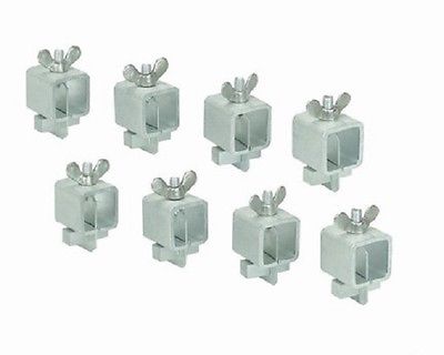

    I'd do a 1/2 panel sheet metal replacement from the stainless strips down and fold (Hammer & dolly) the edges like OEM. Not a fan of those flange tools although they make it easy. The gap between the panels traps moisture. I've always butt welded the new section(s) in where practicable and used these clamps to secure panels together. It's a lot easier to dress up a single panel layer than a double panel layer. A lot also depends on your skills and access to tools etc. A good template is a start. When I did body work many moons ago we were taught to not finish them once tack welded. Fit the panel(s) and check all your gaps, it's too late once its finish welded!

    I DONT LIKE THOSE CLAMPS!THEY LEAVE TO BIG A GAP.
