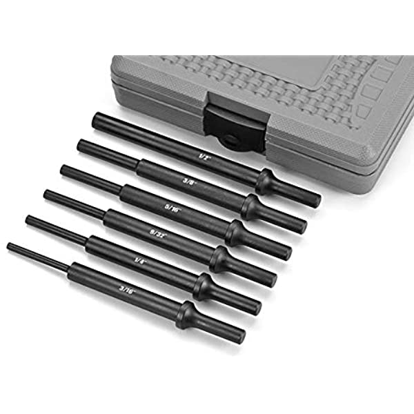

  4. You can make one that works better. Soak the pins while you building one. Take you air chisel and weld a piece of a 1/4 inch punch to one of the straight chisels. Soaked pin maybe some lite heat and hit it with the air chisel. Was a thread here are the barn showing the process to build. Son made one that worked great.
    I’ve always used a punch in an air chisel .

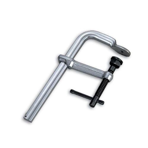

    or get a heavy duty welders/fabrication clamp with a hunk of pipe on one end and the correct punch on the other and drive it out with an impact gun.
    A make shift pin press. Always worked for me.

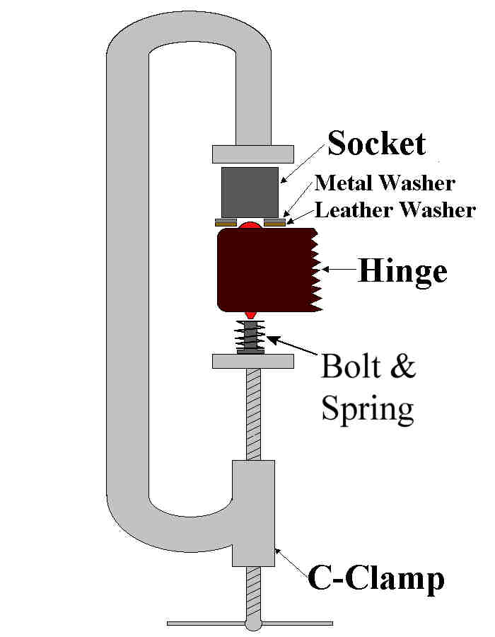

    This works with a good old heavy duty C clamp....new overseas cheap stuff will bend.
    Credit: Bob Johnson
    You will need a "C" Clamp the larger the better, a 1/2" socket, metal washer with a 1/2" hole, leather or rubber washer with a 1/2" hole, 1/4" bolt (cut off). The "C" Clamp has to be large enough to span the socket, washers, hinge, and bolt. The 1/2" socket should be tall enough to receive the pin when it is pushed up by the bolt. You can start with a regular socket and then use a deep well when extra height is needed. The metal washer distributes the pressure evenly around the hinge, it should have a hole bigger than the hinge pin head. The rubber/leather washer will help keep the paint on the hinge intact. It should also have a hole just larger than the hinge pin head. The 1/4" bolt forces the pin up into the socket. It is cut off to about 1/4" to 1/2" length. If you were to use a longer bolt it might not stay in place when the pressure is applied.
    This procedure is used if the pin is stuck and can not be removed with just penetrating oil and tapping. The drawing below shows the setup. Make sure that everything is lined up vertically. You should start with a regular 1/2" socket and a 1/4" bolt that is no longer than 1/2" long. Apply pressure and the pin should move upward. If it does not you can tap on the top or bottom of the "C" Clamp to help. As the pin is driven up into the socket eventually the 1/4" bolt head will reach the hinge. You can then remove the bolt. Most of the time the pin can now be tapped out. If it is still stuck then use a longer 1/4" bolt and continue driving the pin up with the "C" Clamp. You may need a deep walled 1/2" socket if the top of the hinge pin hits the "C" Clamp.
