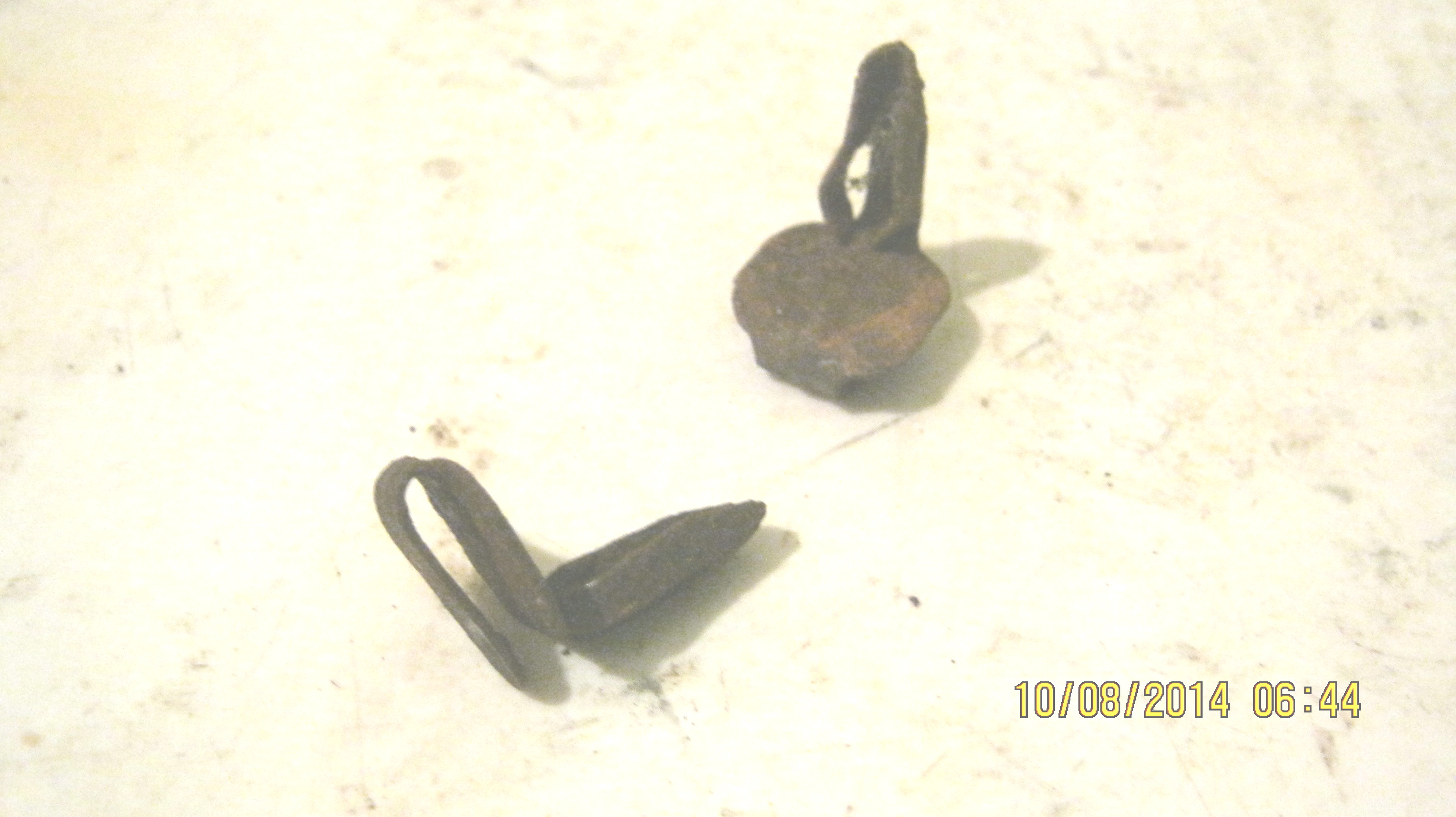

    here is a pic of the clips that were holding the door panel on . I just went thru all my clips accumilated over the past 40 years and I have enough to do the panels with this style clip.. just wondering if a better style clip is out there nowadays .

    yes 56 . those plastic clips .......... the ribs wear out / flatten out after a few time and loos there grip. right .
    I beginning to like the original metal clip I have . least they won't wear out.

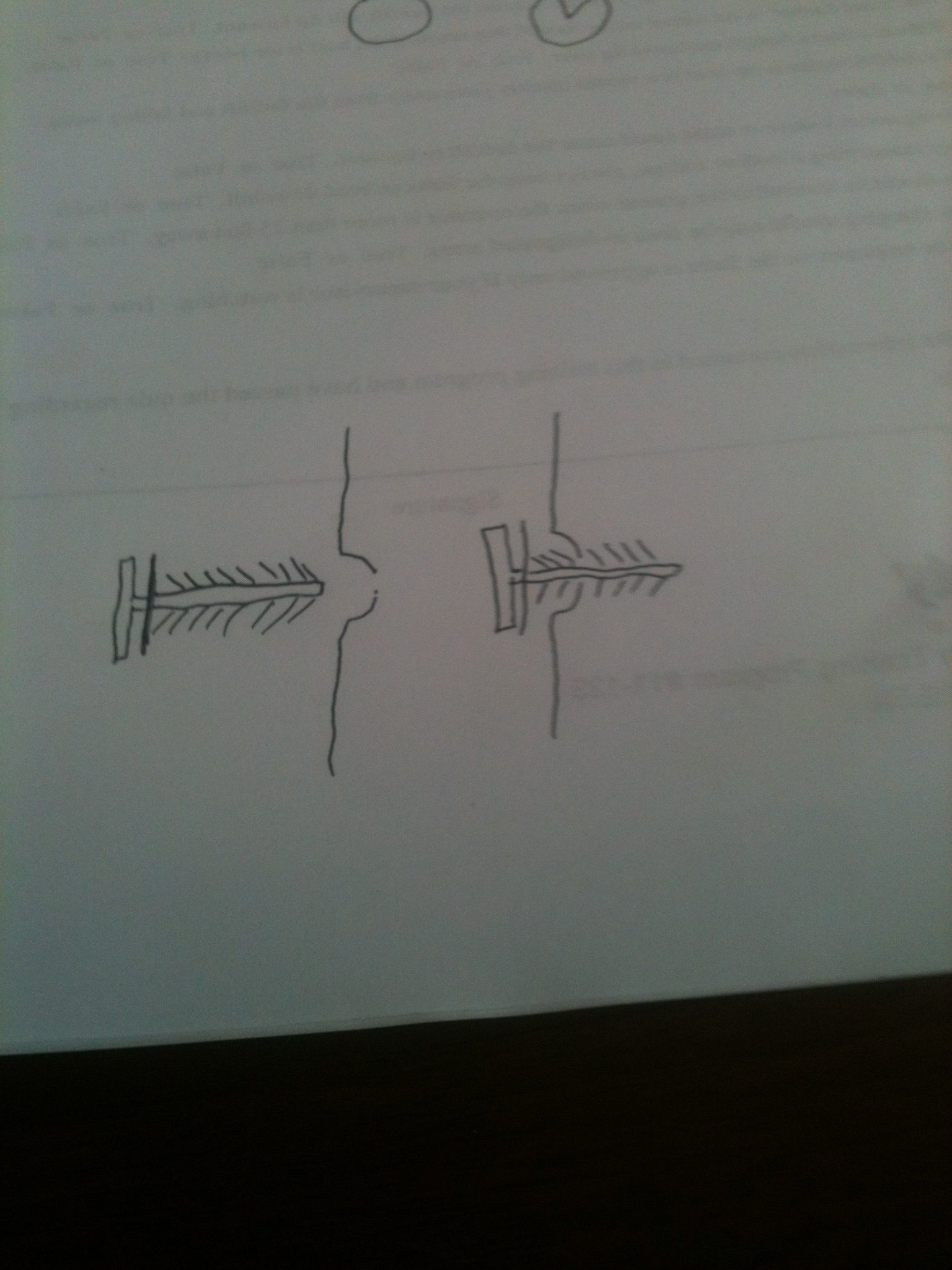

    Sounds like you are already going with metal but I just saw this and After working with the Christmas tree fasteners for 25 years I thought I would add my 2 cents.
    First of fasteners wearing out?
    How many times do you plan on taking the door apart?
    Secondly the tree fasteners ar easyer to line up especialy if the hole is sunk in a small dent. View attachment 2733347 Will they wear out? Certainly.
    After removing the panel 4 or five times.
    But that takes me into the next life.
    dodge59 likes this.
    Secondly the tree fasteners ar easyer to line up especialy if the hole is sunk in a small dent .Will they wear out? Certainly.

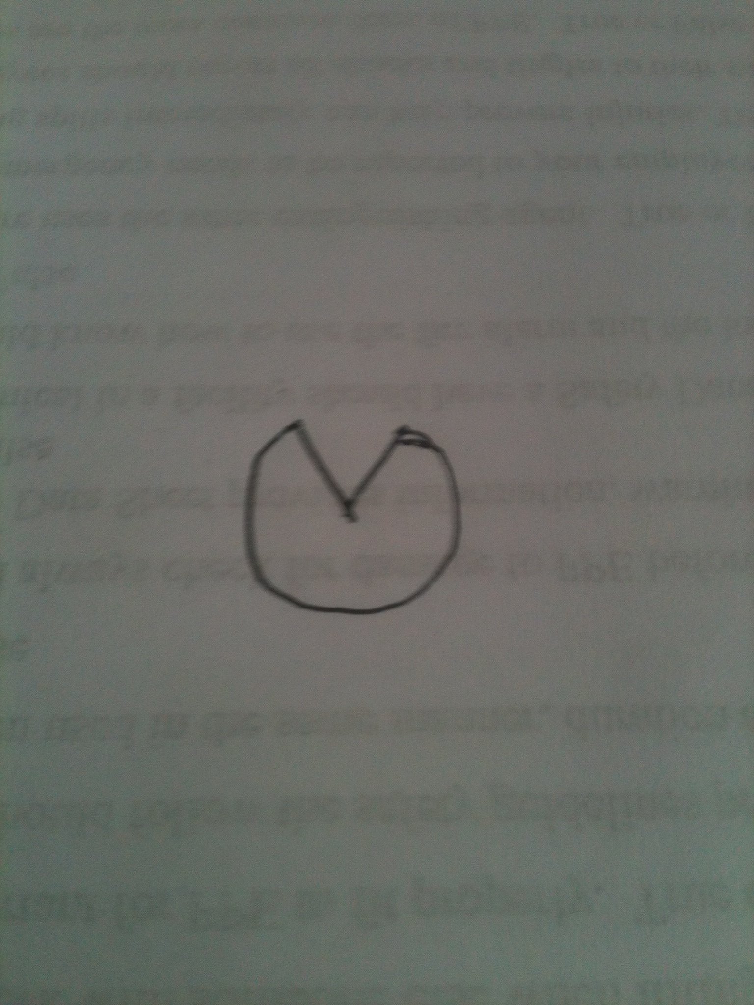

    If you cut a section out of the top of you tree type retainers like this.
    You can spin them in and back out of a round hole.
