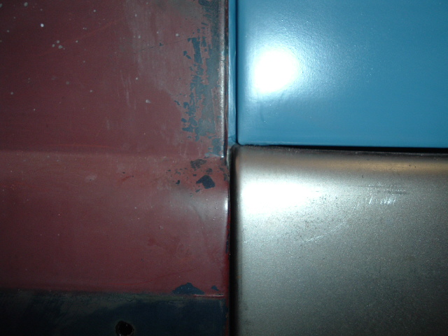

  1. This is a pic of the closed driver door of my 50 Mercury. The Co-driver's door has the same problem.
    I have tried to align it, but without success.
    Should I have my door hinges reworked? is there anything else that I should replace? Or is there maybe some other problem?

    The dreaded sagging old car door problem. Search here on the HAMB, there was a good thread about installing new hinges and a special way of adjusting them. I don't have the link handy or I would post it. Search for adjustiing Merc hinges.
    You can loosen and slide the door latching mechanism to close the door more. But you need to fix the sagging first.
    Fixing floorboards and sagging doors, the hardest and least noticed fixes in my opinion.

  3. You might try loosing the lower hinge that is mounted on the body and use a flat washer between one of the bolts and the hinge.
    You may only need to use just one washer on the bottom bolt,,,you might have to do this several times but this method has always works for me.
    I little adjustment makes a huge impact. HRP

    What you will probably have to do is remove the front clip. Once that is done, check the door hinges for any play. Remove/replace as needed, then align the doors. Once the doors are perfect, align the rest of the front clip to the doors. I had to do that to my '52 Chevy. It was a finished car when I bought it. The original owner had the car stripped to bare metal and all the rust repaired. The company that repaired the rust on the doors and removed the doors to fix the rust. When the doors were replaced, they weren't aligned. The owner painted the car without correcting the alignment. Another thing was, the core support was shot and needed a new one.

    The lower hinge has to come out a bit ( shim under hinge ) to get the back of the door up.

    Open the door part way and try lifting up on the door at the back if there is play or movement no amount of adjustment will solve the problem. You need to repair the hinges usually the pins or bushings. Then you can adjust. The bolts that go to the body are for up and down. the bolts on the doors are for in and out as a rule

    First thing to do..Open the door a few inches, does it wiggle up and down? If so, probably one or both hinge pins are broke. You should be able to tell if you which one is shot by getting down and lifting the door up with your knee and see which one wiggles..pretty easy to replace the pins or drill and use oversized ones if needed...
    Now if the door does not wiggle the doors have sagged or been tweeked at one time or another. They have no adjustment, so the only way they will fit into shape is to twist them... in, out, up or down. Your easiest solution, is to open the door 6" or so and place a block of wood under the door for a spacer in the jamb area at the opposite end of the hinges, and use a jack to lift the door up, (quite a bit past the top of the gutter sometimes) being careful not to let it fling out from the lifting force or hit the raingutter on the A pillar when its going up..Might have to lift it 2" to get a 1/4".. I have even had to bounce in the car to get some added weight to allow them to twist just a bit more... 70 lb door on spot welded sheetmetal..it moves. I have to do it all the time before a chop and i just did this to my 50 a few days ago

  10. A good way to cure the situation with the sag in both doors is to check the body mounts at the front of door[nearest the front] of the door....if they are the least bit crusty or rusted they settle down....this allows the door to set lower as a result.
    if they look all right,loosen these two mounts and the front "cowl leg" mount bolts and take the bolts out and replace with a tad longer new ones and slip in an extra shim between the frame and these mounts.....
    may require a block of hardwood on your floor jack to raise the mount slightly =insert shim/shims and let down on it....leave the two front[cowl leg] mounts ,shimmed as they were.... that will raise the rear of doors only=
    this is the correct way to fix the problem.....

    Ford/Mercury bent the door hinges to adjust them. to raise the top of the door they would place a block of wood in the area of the lower door hinge and shut the door on it to expand the hinge. or to raise the top of the door you can compress the top door hinge by tacking it off and squeezing it in a vise. Also the hinge leafs can be bent forward or backwards to move the door a like direction. Another way is to cut out a shim to place behind the hinge to move it towards the rear. More than likely the pins are broken. I have found that on the Mercury's 65% of all loose hinges are in actuality broken hinge pins. I overhaul them all the time. You can check here on the Hanb for feedback on my work, I have done many Hambers hinges.

    Although it sounds crude, I have used the procedure that T Fritz describes to raise
    the sagging doors on my '40 Ford coupe successfully.
    Place a block of wood in the door jamb below the bottom hinge.
    Close the door slowly to pinch the block of wood in the door jamb.
    The door should be held open about 2 inches by the block of wood.
    Experiment by shoving the door toward the closed position a few times, pinching the
    wood block. This should be done with the hinge screws tight...not loosened.
    You will be amazed at the results.
    And yes...this was a factory procedure at Ford for some time!

    It looks like the gap will be too tight after you raise the back of the door. If that is the case, loosen both hinges (top & bottom) and move the whole door forward until the gap at the back of the door is 1/8"-3/16". If moving the door forward slightly causes a gap that is too tight at the front, you will need to adjust the front clip to accommodate.
    Getting good gaps takes patience and lots of nit picky work, but the end result is well worth it.

    I had a similar problem with my 1951 merc. before restoration. New body mounts made a huge difference. Replacing the hinge pins made the doors liveable. I sill needed to add a shim of about .10 on one of the doors.

    DO WHAT CHOPRODS SAID!!. the other methods mentioned work too but...start with the body mounts.Best way for a long term fix IMO...and I've done plenty of these. Hell you could even lift the car under the middle and see how much things move. sometimes its even necessary to porta power the top hinge forward .

    Your door fit can be caused by several things. The # 1 issue is door pins/bushings. You say they feel good. # 2 is bent hinge plate between Pin hole and first mount bolt in the hinge plate. It don't take much in either of these to do exactly what you have. The "correct" way to repair is to remove the hinge and flatten them in a press providing you don't have a frame issue or Rust issues in the Rockers. Another thing often is replaced rockers welded in creating a distorted Door opening in the body, probably not your issue. Fix your hinges the right way, not with a Block of wood please.

    Since both doors are sagged, I'd look at replacing the body mounts first before doing more damage with jacks and wood blocks.

    I have had to do every trick to align a door on a merc to get it to fit the body..From, more shims at the front, this side, or that side, especially after some bodies end up with new patch panels or at least attempted ones..
    But..if you have a Merc with body mounts that are in great condition, or brand new, with nice door gaps all around, all it takes is an idiot to hang on your door to screw that all up..Now from what i understand, that to fix this i need to place more shims under the body to correct this?? I don't think the idiot affetcted my body mounts, but they stressed the sheet metal on the pivot points of the door instead..
    Think what you want about a block of wood and a jack, but 90% of the Mercs i mess with for myself or customers, might have no body or mount issues and have door sagging problems. Unless the car has seen alot of rust repair in the floors and substructure, the problem is that "swinging" thing has been openeing and closing for the past 60 years and who knows how many kids or other idiots were swinging on it...Is shimming wrong? No, especially on hardtops and converts, but if I have a stack of shims on one side to fix a sagging door and none on the other and now my front clip doesn't want to line up because the body is tweeked from left to right where do we go from here?

    I have a strong feeling that there's a problem with the body mounts as both doors are sagging the same way, but I have yet to check them.
    As I've said the hinges have absolutely no play. The rockers (and the rest of the body) are rust free. The frame looks good.
    I don't know how much metal was replaced when the car was restored some years ago. Unfortunately I do not know who did it, but it looks like a professional job and I do not think (and hope!) that the body was distorted.
    However, looking at older pics of the car that were made shortly after the restoration also show the sagging doors.
    Interesting is that the gap between the front fenders and the doors is completely straight on both sides, so I will also have to adjust the front clip.
