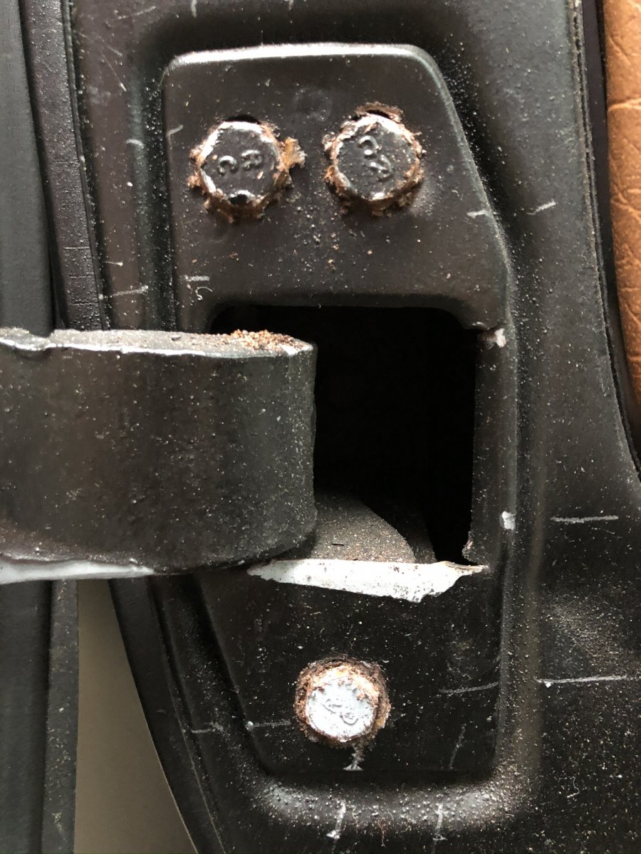

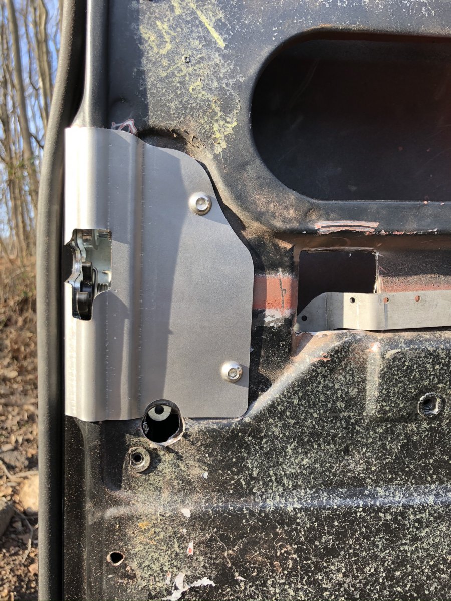

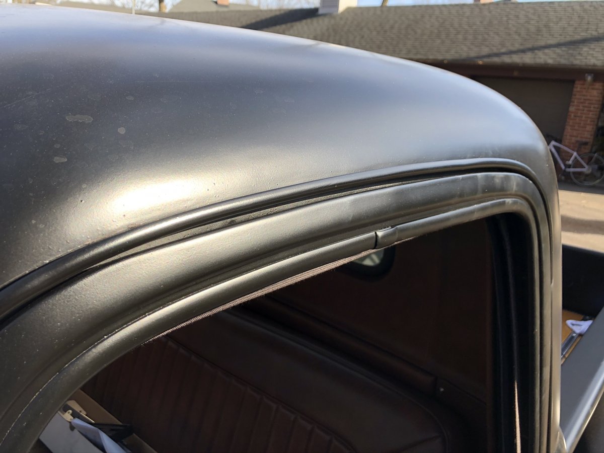

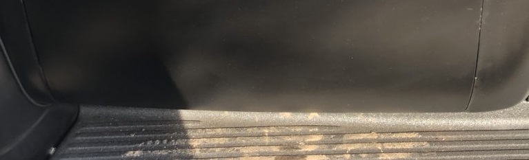

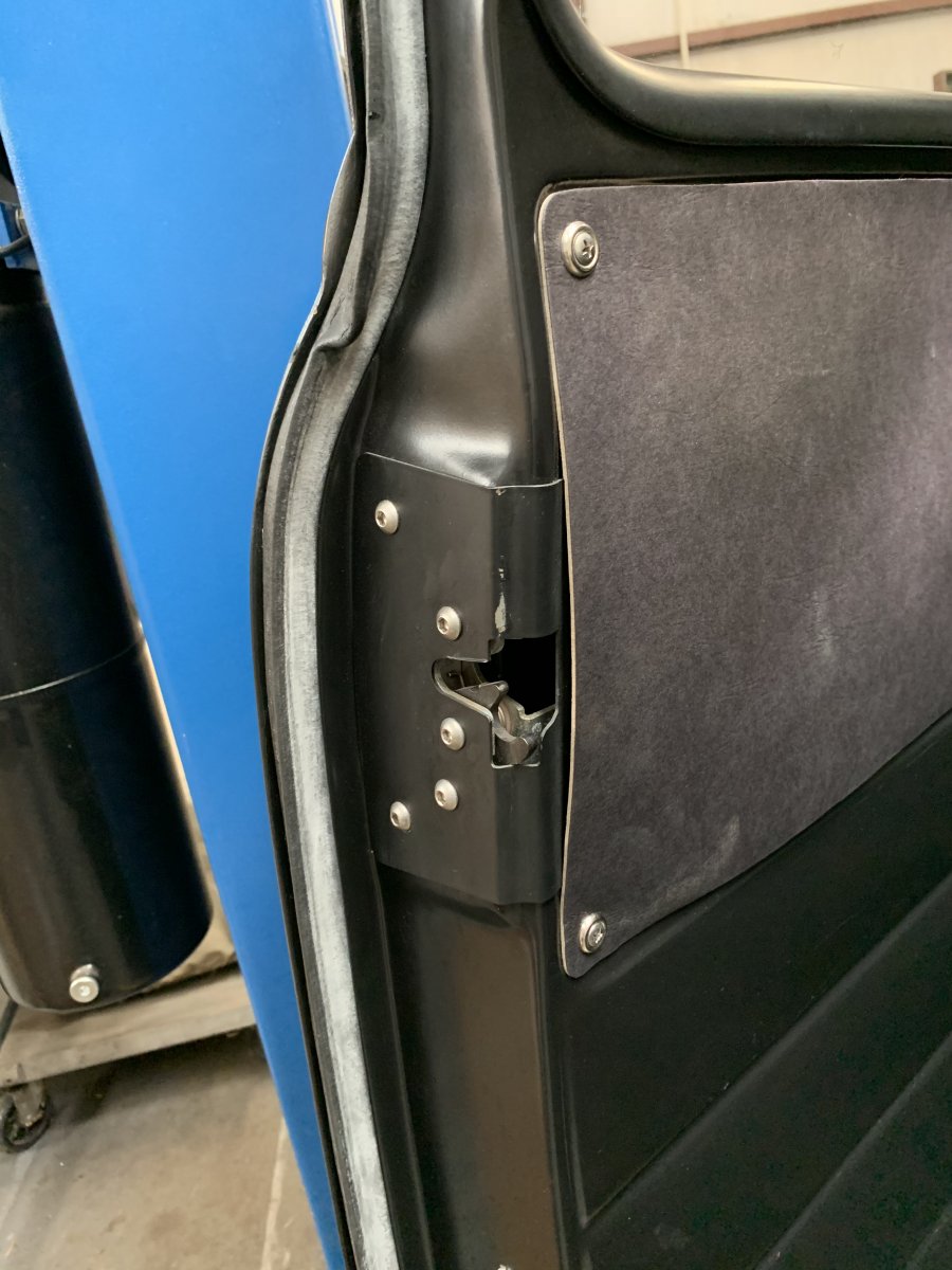

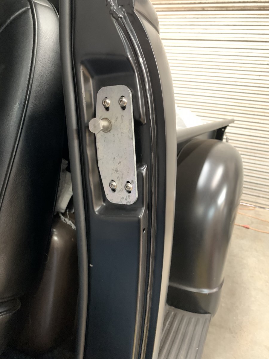

    Hi guys, I was hoping to get some opinions here. I wanted a nicer solution to shutting my doors than what oem was providing so I decided to give Altman Latches a shot. Install was pretty straight forward. Using existing holes, I don't think you can really mess it up. Which is why I'm a little confused here. What am I missing? The strike bolt seems to be about 1/4" too high (or my door is 1/4 too low lol). But when I look at the door gaps, they look ok to me. What do you guys think? And if you don't think it's the door adjustment, do you guys think I should just drill another hole in the striker plate and lower the bolt to the appropriate area? Truck is a 49 chevy 3100. Any input is greatly appreciated, as always! :)

    Looks like the door is up to 1/4" low at the back, eh?
    But the fore/aft gap is pretty small towards the bottom of the door, too.

    Yea, The back of the door is probably a little low. I just went out and looked at it.
    I also measured where it was hitting the strike bolt and it's actually more like 1/4-1/3" off, not 1/2 like I originally thought.
    I guess these latches are really exposing the other little flaws I was looking past.
    I've never tried to align the doors before. Any tips for me, based on what you see here?

    The problem is that I can't get the door to close and latch. The top of the door plate is hitting the strike bolt. That's why I thought maybe drilling a second hole in the strike plate and simply lowering the strike bolt would be a possible solution

    If I go this route, I think I will swap sides. Using the striker plate originally intended for the passenger side will place the pre-drilled striker bolt hole on the bottom when used on the driver side. This will keep it far away and allow me to measure and drill a brand new hole towards the top, hopefully in the right spot on the first try :eek:.
    This will also allow me to swap striker plates again in the future should I wind up working on door gaps to get them right. Then all I would have to do it undo the striker bolt, place it in the other hole and back on the other side of the truck.
    Does that make sense?

    Checked my truck just now, is your striker like this?
    Can’t see your door alignment being a problem with this much adjustment. 46D170C1-371F-4DAB-9CA9-CA44EEC55235.jpeg 2D5BD7E6-81E9-4593-BC5B-E4AF1C5ECD07.jpeg

    Nope. I wish it did. In fact, your whole setup looks different. What year truck?
    Even the door jamb, where the Altman strike plate bolts to, looks totally different. Under the plate, mine looks like this. (Pic borrowed, again)
    If you look at my second picture in the original post you can see the strike plate. The holes are only for the bolts and doesn’t allow for adjustment.
