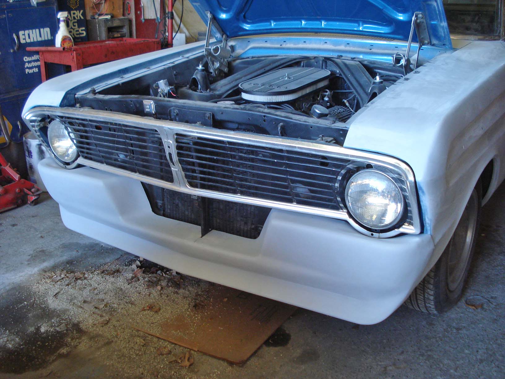

    Here's somethin' a little different on the Falcon I'm doin' ......... Road race style... Shelby Drop on the A arms, etc..... she STICKS !!

    Im digging that front end. Is that all glass or did you build sheet metal onto the front bumper?
