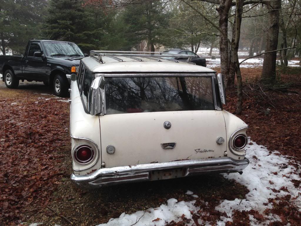

    OK, I might be posting in the wrong spot, if I am, I am sorry. I just picked up a 1964 Wagon, I am planning on doing a low budget "SURF WaGON" theme and I don't know much about Falcons.
    I want to run 60's style rims and white wall tires, but I don't want to use 14" or 13" rims. I like the Salt flats rims and I'm trying to figure out how to go 5 lug first, how to drop the front end w/o cutting coils, I'm not a fan of that, I plan on using a 2" block on the rear.
    I will stick with the 6 cyl and auto that is in it now, it has A/C, but I want to get the stance right first. Then I 'll consider a V8 swap
    Any suggestions or advice on how to achieve the look I want and what size tires/wheels I can go with would greatly be appreciated.

    The last Falcon wagon I did ran 195-60-15's, on 15" x 6".
    You don't want to over-do it on tire height. The taller the tire, the bigger the circumference. The bigger circumference will make it seem like it has taller gears. This is not good for the six.
    There is no way to lower the front end without installing shorter coils, or cutting coils, or both.
    Might I ask why you don't want to cut the coils? I have been doing it for about 30-years, and getting paid to do it for about 25. Done properly, it works just fine, and is a time-honored, traditional practice.
    My daily-driver '60 Falcon runs 560in.-lb. springs, intended for a 65-66 Mustang, with one coil cut off, and custom 6-leaf rear springs from ESPO, which have 2" less arch when loaded. Your car can use everything from the Mustang parts bins for suspension.
    When you do have the front end apart, it is the perfect time to relocate the upper control arms. This is called the "Shelby Drop". While it does not really "drop" the car, it does "drop" the control arm. In the process, it radically alters the camber curve on suspension cycling, and during body roll.
    It is all of measuring and drilling 4 holes. The transformation is from grandma's grocery getter, to canyon carver. The cost is one drill bit. This is the single biggest, most cost effective modification you can make to a Falcon, or any other car that shares it's chassis parts.

    Cool idea on the "Shelby" drop. I have seen it mentioned on other blogs, had no idea what it did. On the cutting of coild, I just have had bad experiance on a 61 invicta I did and have always tried to use lowered coils since. I assumed I could by a "lowered" coil from some dealer and just swap it out when I do the brakes and any linkage changes I might need to do once I inspect the front end. I have not really been under the car yet, just broughtit home on monday. Thanks for the info on the tires too.
