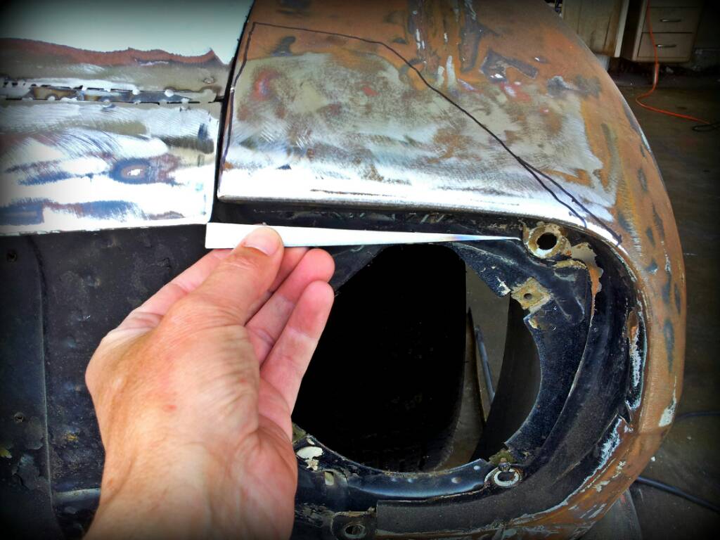

    Was able to work on her again :)
    I have the basic line finished so no on to figuring out the rest

    Falconizer why is the hood longer than the fenders is that some custom stuff you did or just removing various pieces if trim. Looks good by the way those drawing really have it looking right.
    Parkinson looks good from here driving it to the bar is the same plan I have with my 4 door
  26. falconizer_62
    Joined: Mar 2, 2007
    Posts: 637
    falconizer_62
    I lengthened and peaked the hood more to match the line of the 63 Comet bumper that I wanted to use. I think there is a post about it a few pages back.
    Once I got those lines straightened out, I can doodle around as to how to fill it :)
