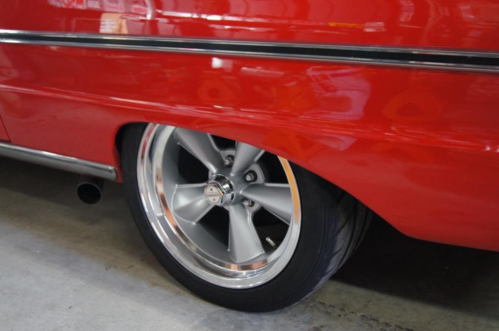

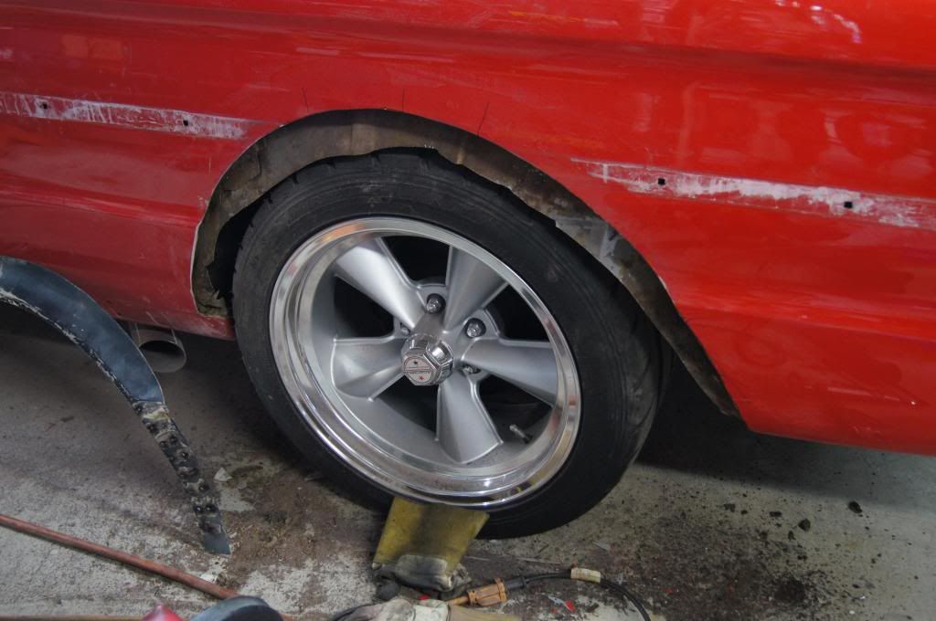

  11. Although I've always liked the round body cars, I've never been a fan of the little rear wheel wells, and you can forget wide tires. For gasser's it's easy, just radius the fenderwell. But for a street roadrace flavored car like mine I don't care for that. I am currently running a 9" wide wheel that i made fit with a bit of hammering, but the tires still rubbed and the bulging from the sledge didn't look that good.
    So after looking at many different styles of fender treatments and flares, I decided to use front fender openings on the rear.
    I started by cutting out the opening to about the radius of the tire.
    I then modifed some front fender parts - I took 1" out of the center of the opening, and then pie cut the rear edge to tighten up the length of the opening as the fronts are longer than a normal rear. I then butt welded them in and metal finished them. I still had a little work in this picture to do on the bottm rear but it was close to done.
    I like the more agressive look, but it still looks like it could have been factory original.

    Those look real nice! Nice job. Had to be hard cutting it up with what looks like a nice paint job.
  13. Thanks - it WAS a nice paint job :D But to be honest, I F'd up the other side when I bulged the fender for the wide tires and found an old rust repair that had a little plastic filler that cracked :eek: It made the decision to cut away really easy ;)

    Looks good. Looking forward to a picture of the complete car when it is painted..........[​IMG]

    Looks good Don! I've always liked that mod on round body cars.

    Great work on that rear wheel opening!! You rock.
  24. Thanks - Now I gotta do the other side :eek:

  26. I did that first, and the rust repair that was previously done cracked all along the wheel well opening. I didn't really like the look as well as this anyway, but was originally hoping to not have to repaint the car.
