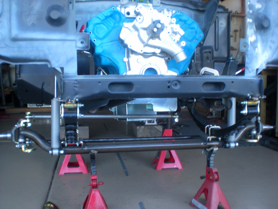

    Here is the progress on mine.
    305 w/ a mild cam
    Fender well headers
    Saginaw 4speed
    9" rear and Ladder bars
    Pie crust slicks from hurst
    Whats next ???? I think a spool and some 4.11's outa do me ok then I have no idea where I am going with this. Figured I would share in case anyone needed some low budget gasser inspiration :D[​IMG]

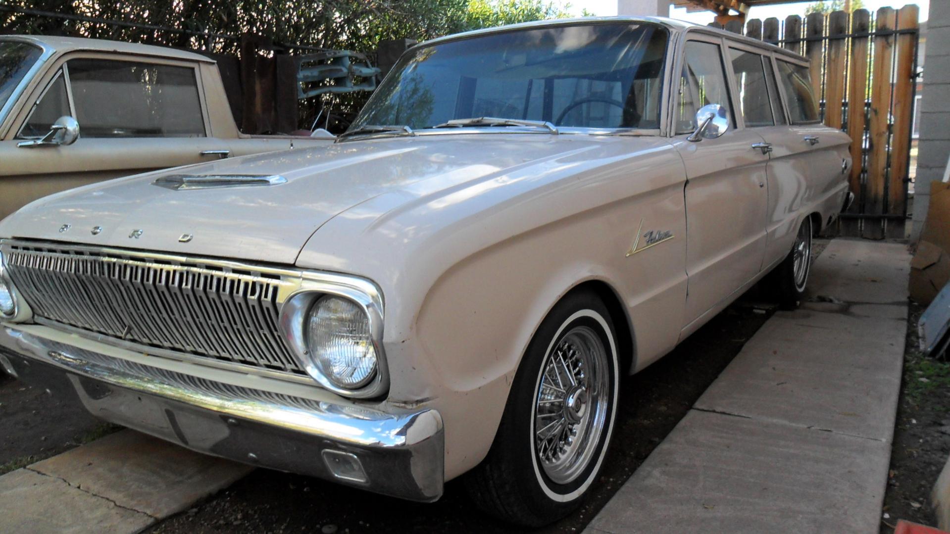

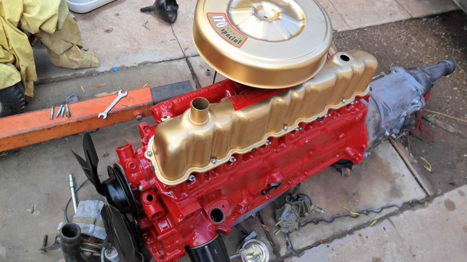

    Hi gang! I have been talking for off and on for a couple of months about my girlfriends '62 wagon that we picked up after Christmas. Here it is! I suddenly have my picture posting super powers back with the new computer! So this is what I have been up to...
    200/C4 combo
    Weber 36/38 DGV
    Mallory distributor
    Late 2" exhaust manifold and 2" exhaust
    14" Tru-spokes
    Shelby drop with 11/2 coils cut
    original paint shined up pretty well
    will have A/C by summer
    Getting just a bit excited to get this on the road, and hoping for Good Guys spring deal here in Scottsdale.

    I'm jealous of your wagon!! very nice :)

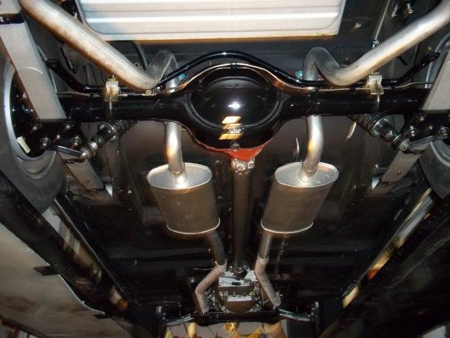

    just a couple of picts of my little truck.that's a 302 roller motor from FMSand a '74 maverick axle assembly w/ 3.40 gear and eaton tru track.frank

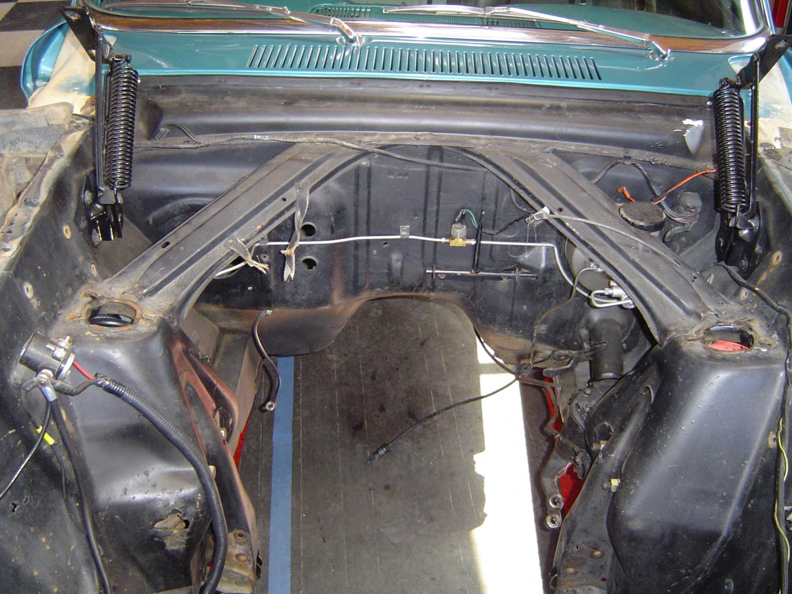

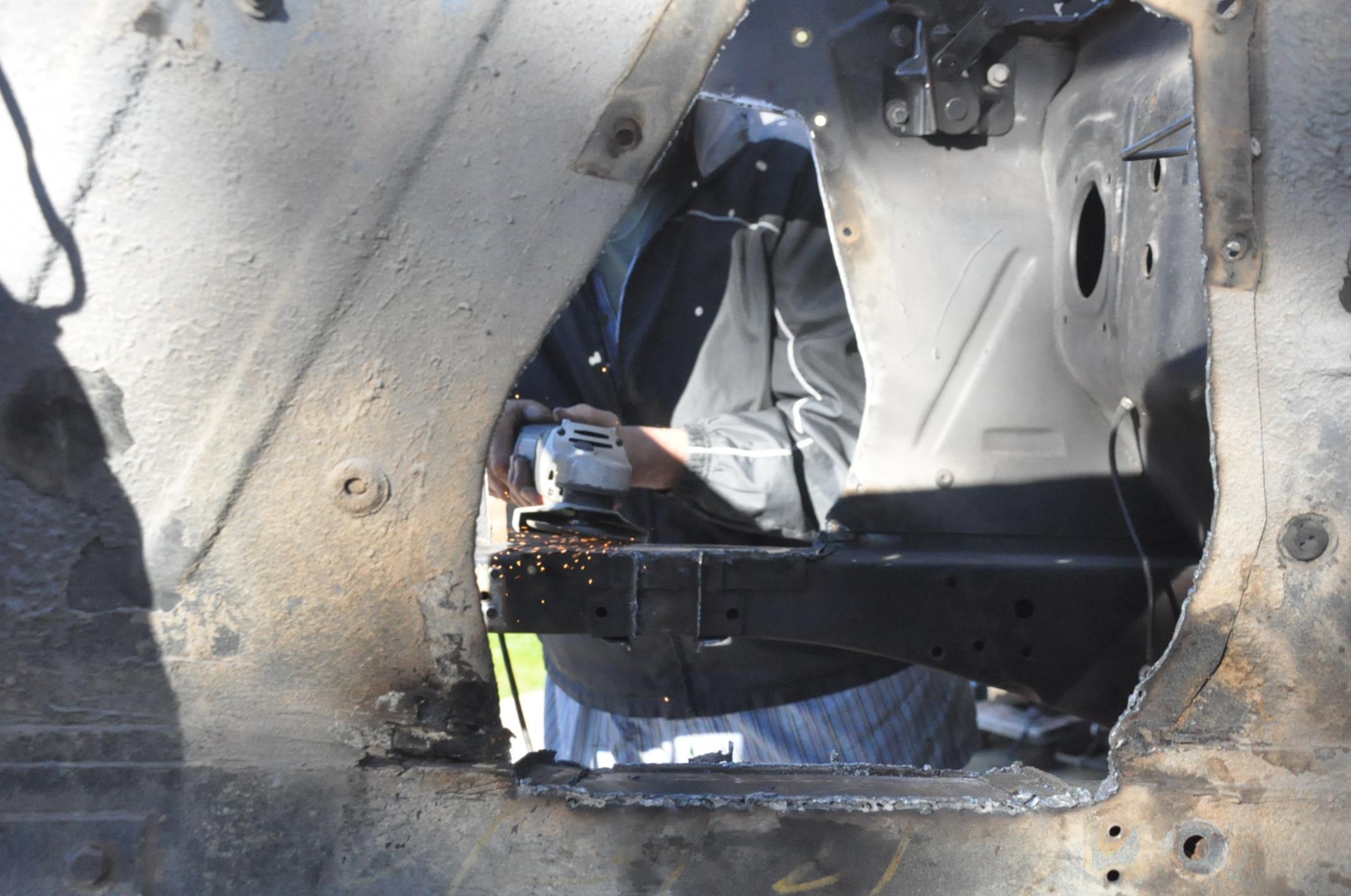

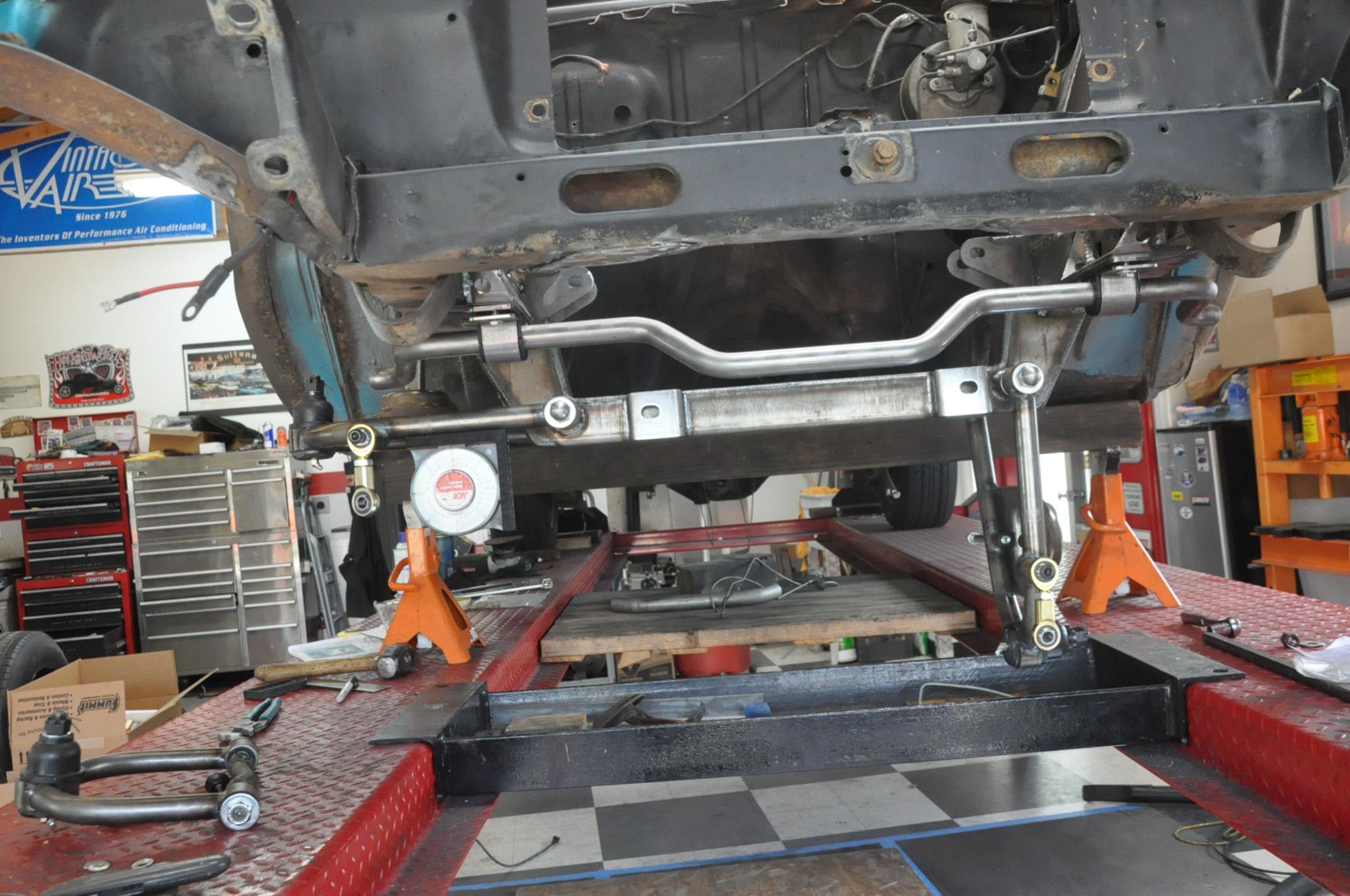

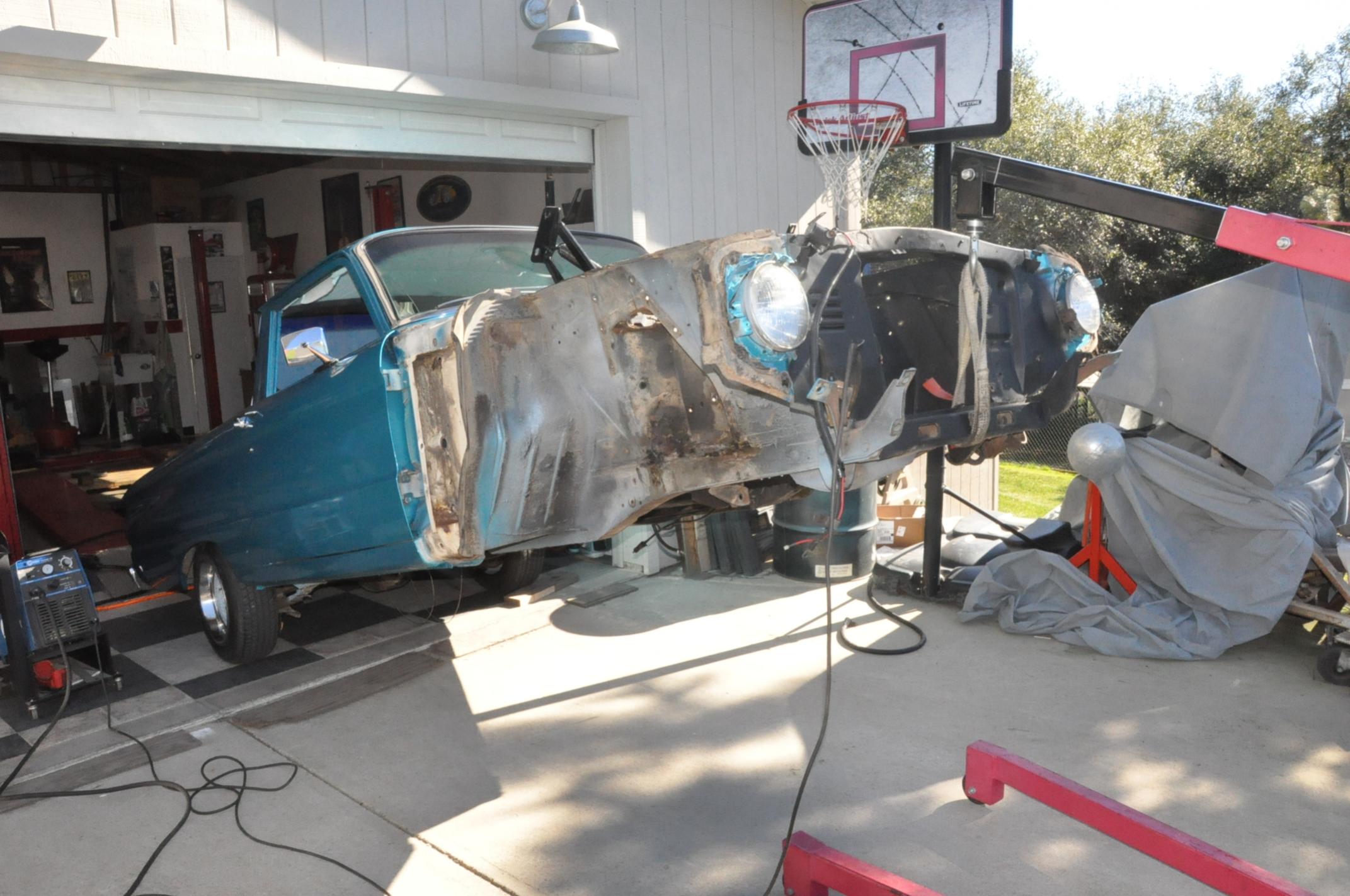

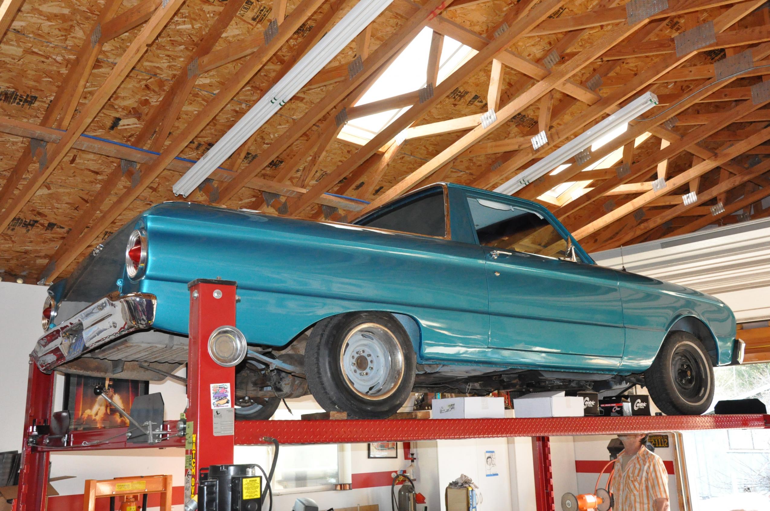

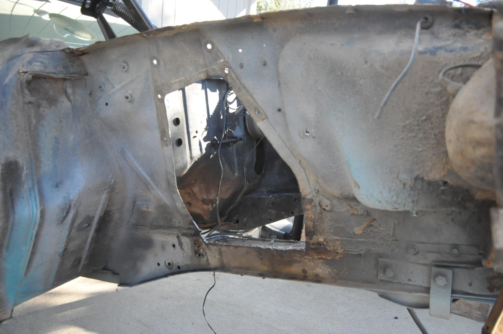

    Here is a '63 i'm putting one of the new TCI Mll kits in. You get a lot of room after cutting out the tower's and cross brace's.. You have to weld new boxing plates on four sides of the frame rails because the stock one's are very thin.. It's coming along good with some painting before putting motor back in... i'll post more as it get them.

    cwayne...nice. Thanks for posting pics of your work. I dig it. It's nice to lazily click through hours of grunt work.
