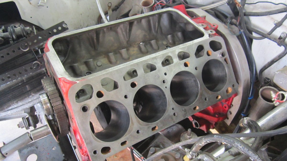

    I did this one in 1965, in the barn in the background. It had a 54-324 engine, bought the kit from Montgomery Wards. I had a lot more desire back then. 2012-11-27 165602.jpg
