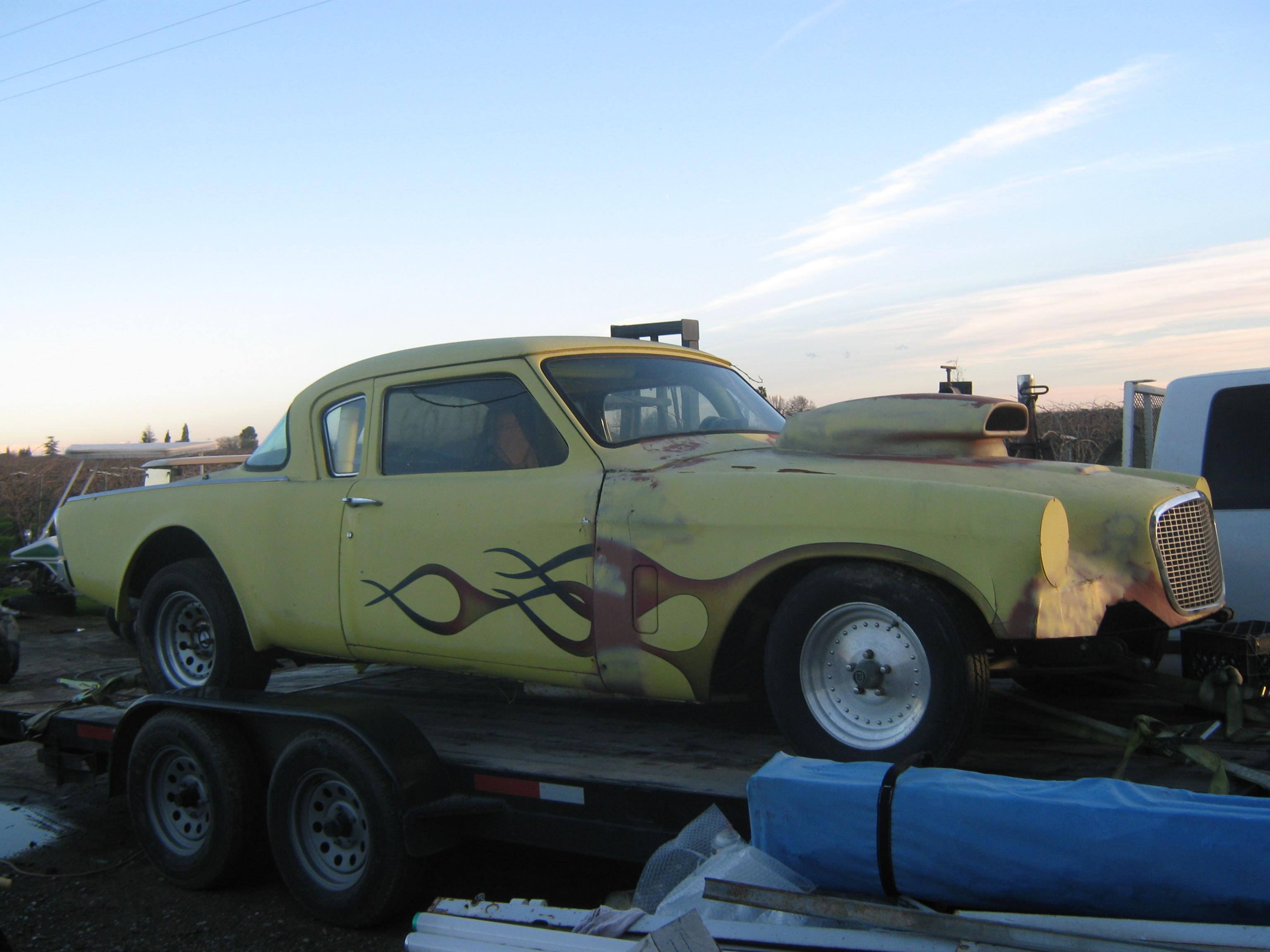

    This car is a true gasser from the 1960s. In 1968 my senior year in high school we srarted attending or local drag strip. This car was a regular runner with a big inch Olds injected alchool. Ran prety good untill a couple of the 1955 chevys switched from injected SBC to injected BBC. Poor little olds never had a chance. There is a econline stright axle under there. The car had sold a couple times. It went from Olds to BBC to wedge Mopar. My buddy ended up with it and put in the mopar. And set about lowering the front end and changing the scoop to make it look more modern.so he could bracket race. I will be trying to get it back to its glory.
