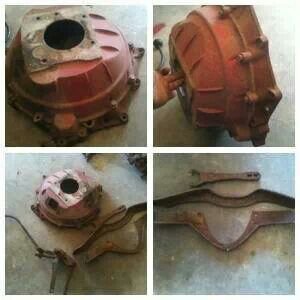

    Ok pete rose has this for sale it is to adapt a sbc to a 3spd. But i was wondering if i could just unpolt it were the 2 peices mate, and bolt it to my glide.?
  9. Why don't you just get a cast iron 55 glide and 55 rear end.
  10. kustomclassics
    Joined: Apr 10, 2004
    Posts: 450
    kustomclassics
    That looks like the one that comes on the v8's with a cast iron powerlgide so it should work as long as the bolt pattern is the same as your powerglide.

    That wont work the pump and valve body bolt to the bell. You may be able to use the bell off a 55 and install it on your tranny.
