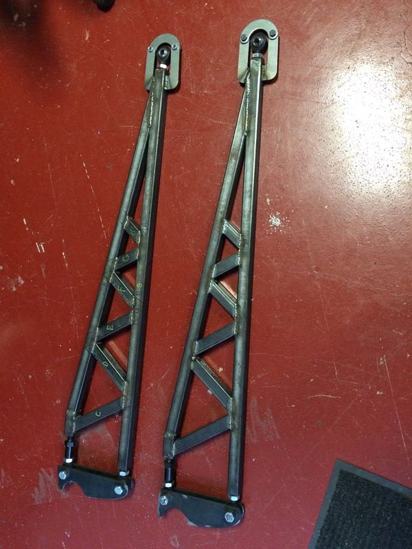

    Finally got these ladder hoop things on :
    I used a Speedway straight axle for now because the 33 Plymouth axle has wandered off o_O Where the hell is Shawn anyway? If I had the Chevy spindle nuts the front wheels would be on. Had to move the front spring back about 2 inches to get the wheelbase back to stock. Need to move the shackles still.
    Maybe it will be a roller by the end of the week.

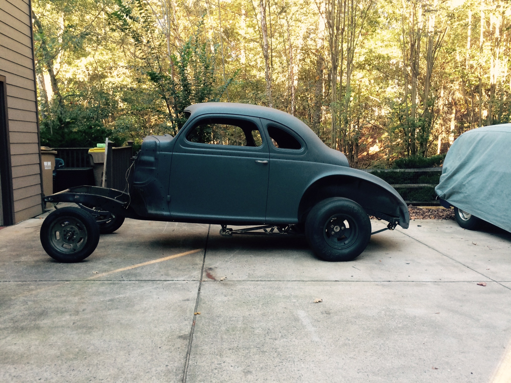

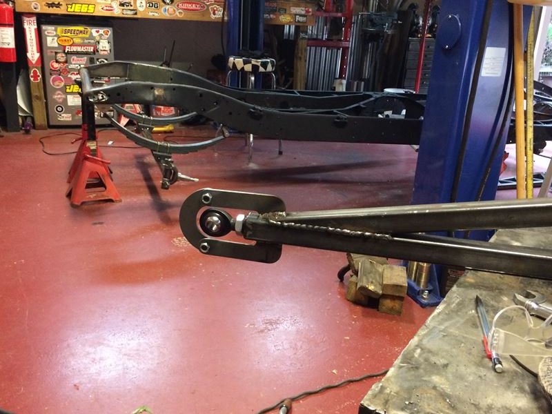

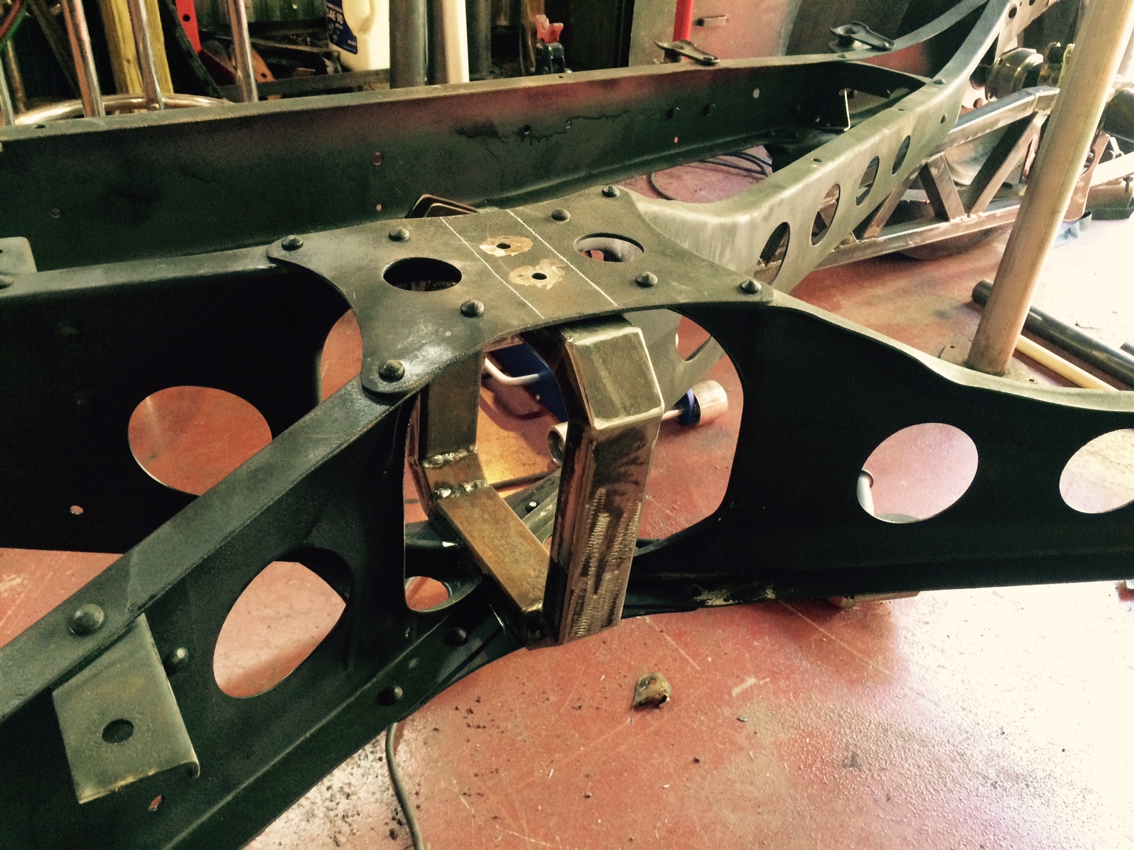

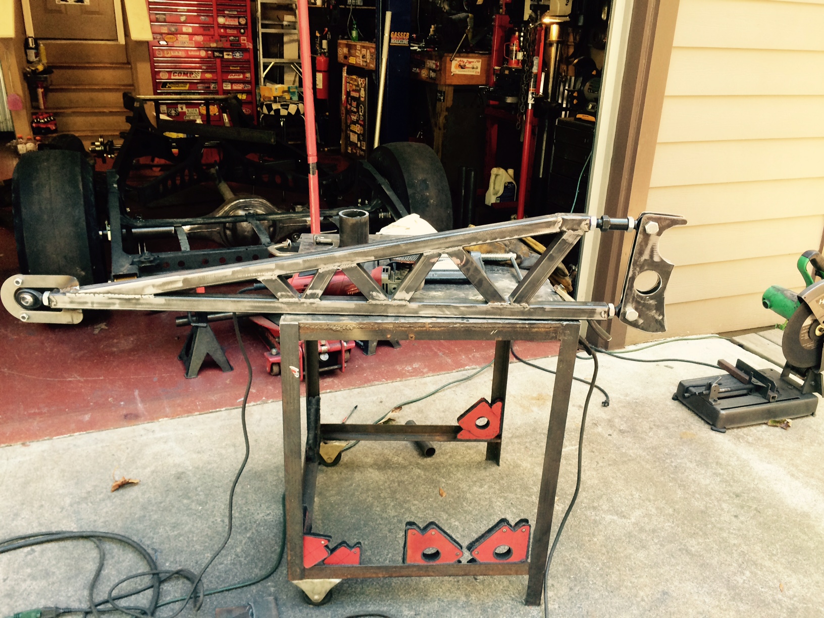

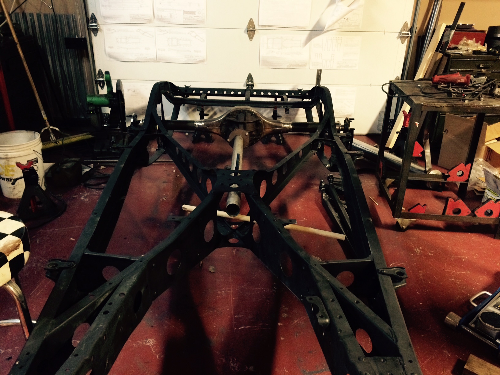

  24. A little progress here. I have made the rear ladder brackets 3 times and the fronts 2x :confused: learning as you go can be full of u-turns. The next car will be a piece of cake :)
    Making these again because the tube under the housing had no place to connect to. Crawled under the Pale Rider at the Atl 10,000 and realized something was wrong with what I was doing.

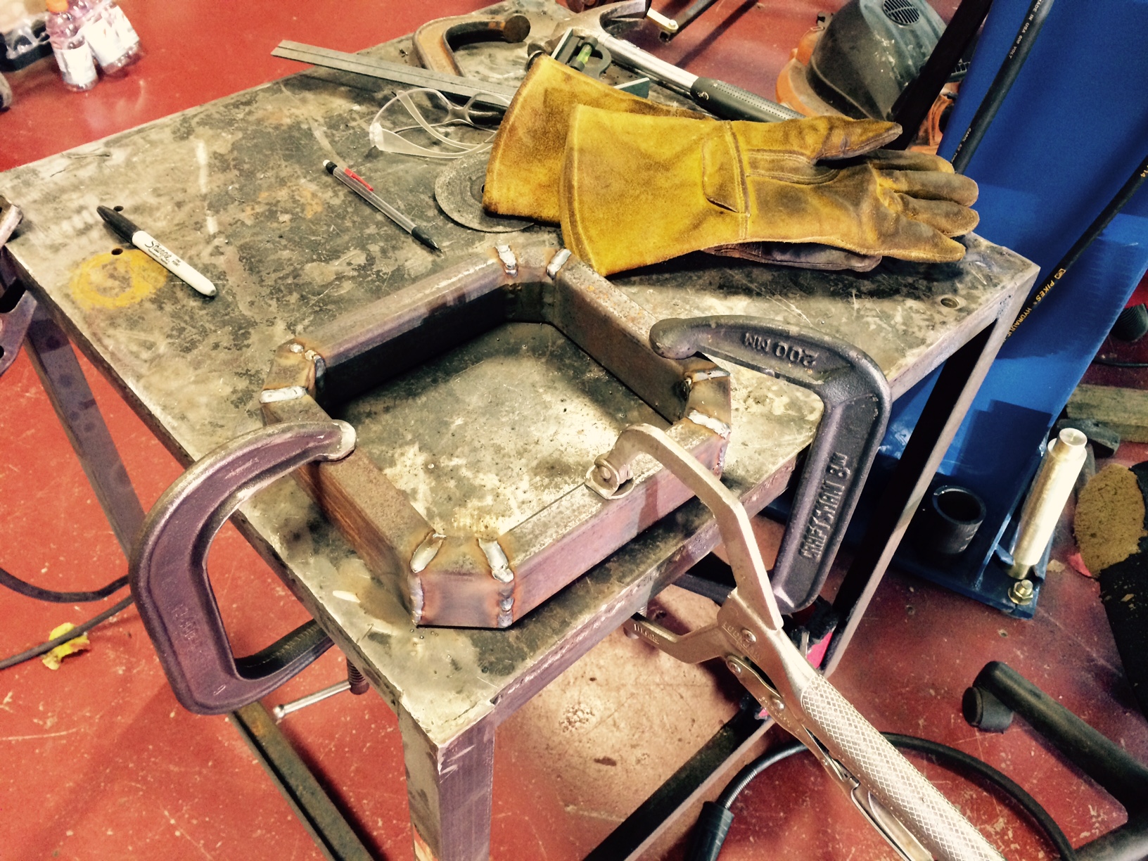

    The front had no place to mount to so making a box :
    Moved these 4 times - they ended up on the top of the rail - hope I'm done here o_O
    Mocking it up. The rear wheel looks too far forward but the axle lines up with the rubber bump stop. Need to try a fender. The ladder bars have 4 more holes higher on those brackets so they probably need to move up. Too many leafs in the front probably. Tonight the plan is to cut off the cowl.

  28. As you assemble the car and add weight, the rear wheel will move up in the wheel well, and point the ladder bar further down hill, so you can move them up a couple holes now, if it helps with the rest of mock up stage.

    Personally, I'd like to see the rear of the car a little higher. But I may not be seeing your vision clearly. Looking forward to seeing this one near completion.
