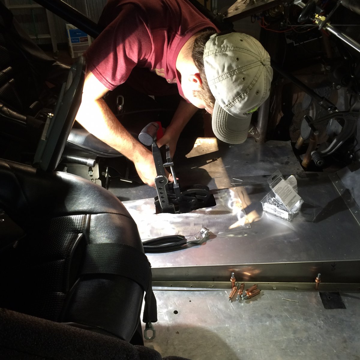

  17. Taking forever to get the car back together. Maybe its the 95 degree days everyday now. Jack came over to help get the trans back in.
