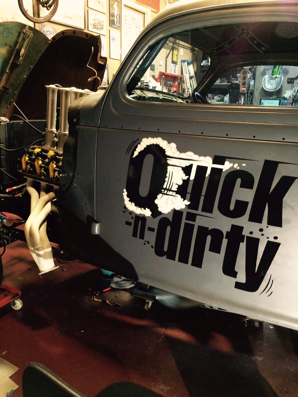

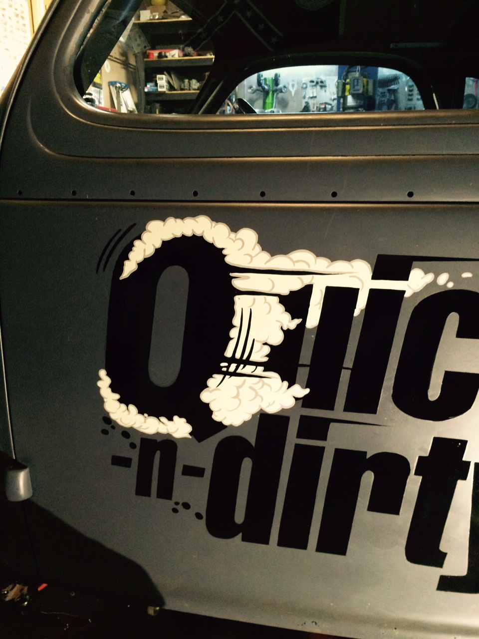

    Last night was another late one. The door art got its outline and a few details. Lots of long lines in a very dim garage plays tricks on the eyes : ) Tony is still fighting a gang of rebel gremlins that have held up tight in the big Chrysler. We think the last strong hold has been located and will be purged soon! Stay tuned.

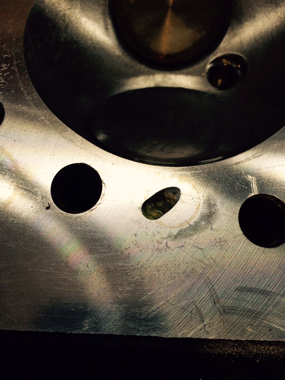

  17. Too tired to throw a punch at Yesterday's News :( so the shit talk will be limited . I didn't post this because it was not clear what the cause was, but - the radiator emptied into the crank case on the first start. It only happened when the pump was running. So a picture is a 1000 words and I'm only putting it here to hopefully help someone avoid this.

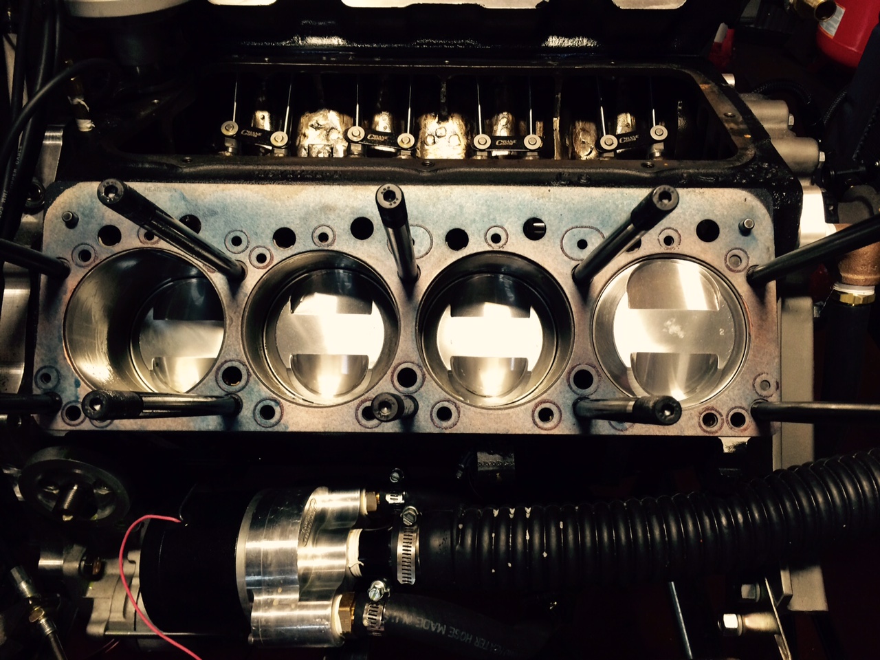

    Here we go - saw milky oil in the valve cover Sunday while messing with something - forget what now - decided to drain the pan.
    Yummy lets make pancakes!

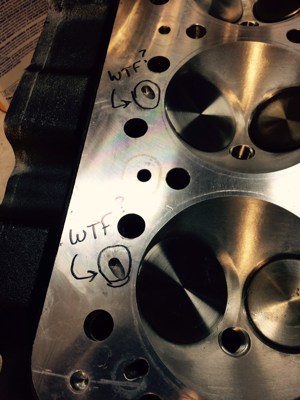

    No choice but pull the heads. Not sure if you recall the earlier pics but the SCE Titan gasket has a built in seal - no extra seal needed - check the website.
    Well the seal was expecting a stock water hole. The Hot Heads hole is WTF ? You can see the seal and the oblong hole are not gonna match. Check the witness mark on the head.
    So after a couple of calls to Nick Smithberg, the plan was to clean the copper gaskets and spray 3 coats of Hylomar on them and re-try.
    After one damn long day - the leaks are gone! Tyler stopped by and we got it running.
    So the take away is - fill these damn holes with JB Weld and save a day :rolleyes:

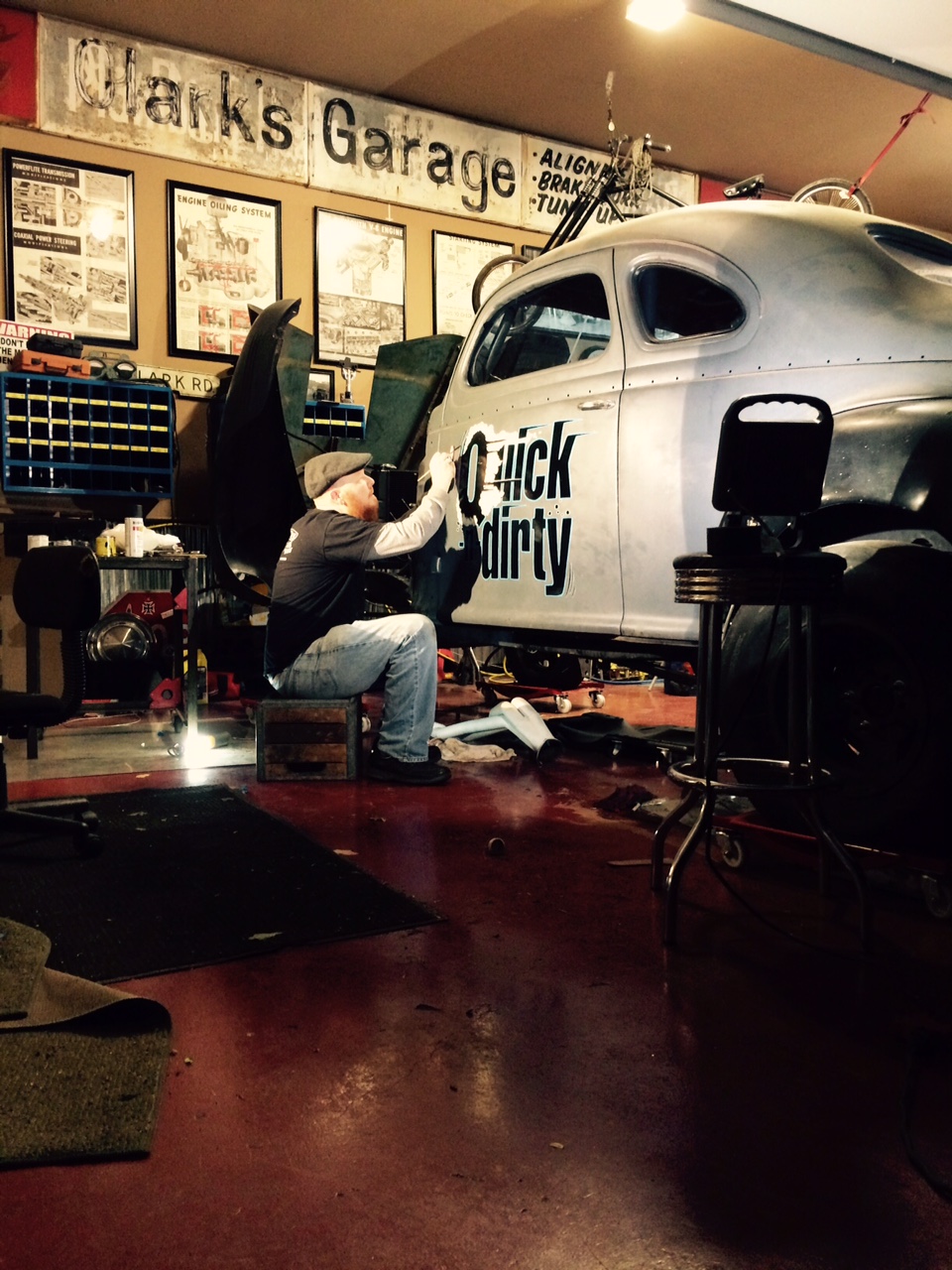

  18. The artwork is looking bad as hell ! Here are a few shots
    FlatJan, lawman, elgringo71 and 4 others like this.
  19. Glad you got it figured out Tony.
    Great shots of Russ layin' down lines with Betty in the foreground!
  20. Thanks Brett! Cellphones are killing the camera business. Here's a nice one too -

    Guys--I hated to see all that "milk"--hey nothing is hurt so keep on keeping on--been a pleasure to watch ya'll thrash--FWIW I think the Hylomar is the best stuff ever made--I spray Cometics and use them again and agian--that stuff is great! I have never trusted the built in seals on the Titans--Copper leaks water!!--I NEVER use it unless block is o-ringed already and I just HAVE to--Blown? Yea maybe but otherwise I like Cometics or good old O ringed Fel Pro--a little secret on copper is to run a radiator cap with very low pressure--it will help stop water leaks in their tracks--Don't be shy about using RTV around every water hole as well--it is usually needed in my experience.

  30. Awesome dusterdave ! I have a set of Cometics but the bore notch is real tight with them. I almost pulled the plug on the copper and tried them. They are there for an emergency pits gasket swap :) also bought a spare can of Hylomar. Looking forward to seeing you run too!
