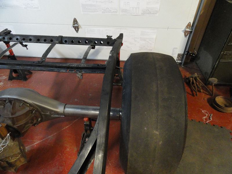

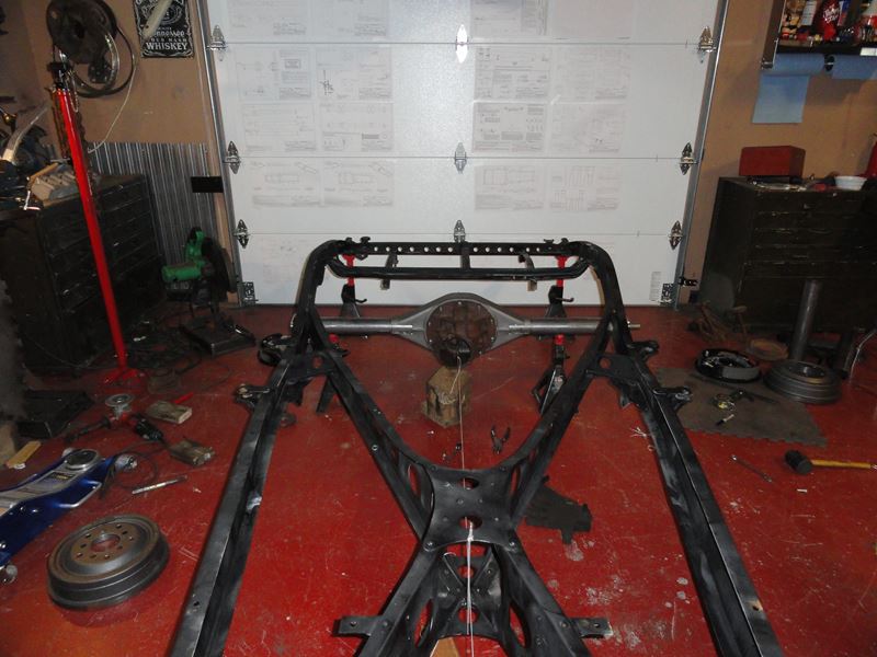

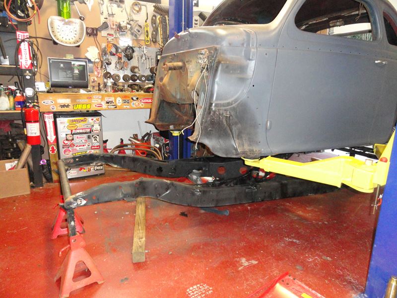

  1. No worries Ric! Its been a crazy week here too. Today was better than most days - got the frame and body back together so the rear axle seems like the next best job to tackle. After looking at the Moonlighter thread, this is my attempt at learning from the best :)
    Body going back on to mock up the rear axle :
    The Palamides were cleaned up and painted on the inside and then I got lucky and the tire shop wasn't busy so they swapped the slicks over in about 30 minutes
    Next the rear tires were mocked up and almost fit the stock 61" rear width. Might need to be a little wider to allow for axle rotation.

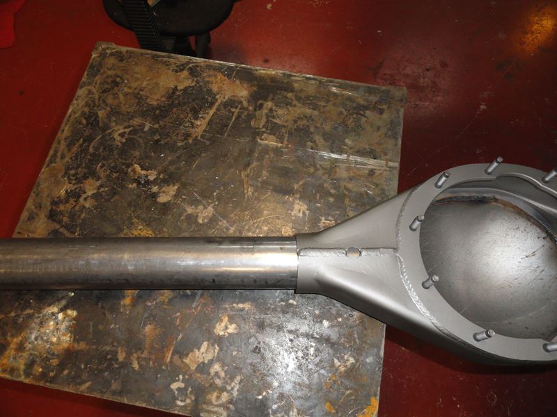

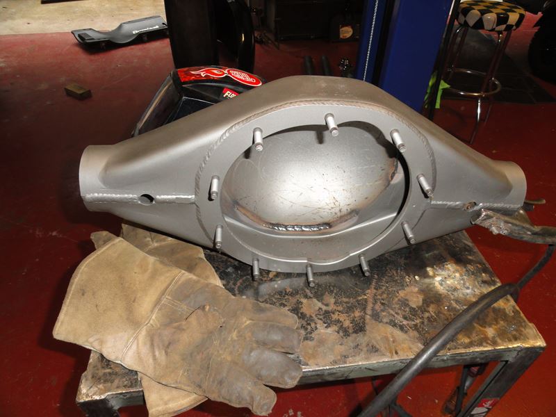

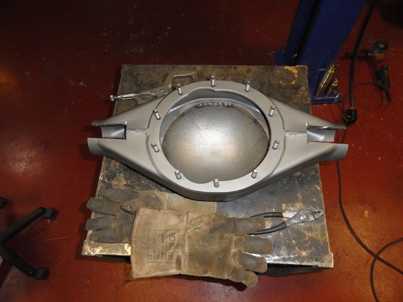

  2. DSC03734 (Copy).jpg Again studying the Moonlighter build, the inside of the housing is welded up
  3. This new HAMB is wacky.
    The slots are done. Now I need to get an empty rear chunk from LAYDRAG tomorrow.
    One item I am not sure about yet - where to center the rear ? I know on a T-Bucket or something where you can see the axle, the rear should be centered, but on a drag car should the yoke be centered on the trans ?

    What's the function of the slots you cut in the housing?
  7. Not bad for $600 eh ? :D Little salt in Jeffy's wound.
    I saw on Quain's thread he cut the housing like this to give it more weld area. The orig housing had 1 tiny little hole for a rosette weld. The slots are cut on the front and the back. Lots of weld support now.
    So sounds like Bean Dip recommends a centered pinion - works for me.

  10. That makes sense. After the fun-n-games PBRmeASAP had with the axle in the old '31 chevy I'm thinking you need to watch how much heat you put on there when you're welding.

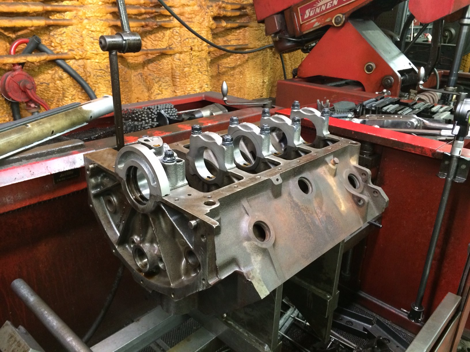

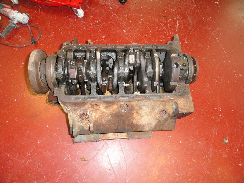

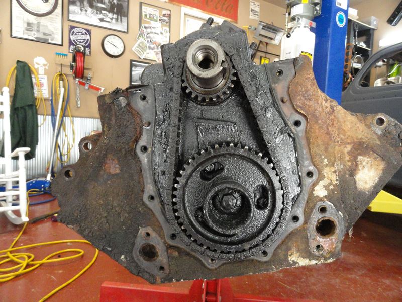

    Anyhow - stopped in at the machine shop and grabbed a pic of the block on the line bore. It was sooooo crusty it was vatted twice or 3 times. The crank turned out sweet though. I have been trying to figure out the stroker crank options but the price of shipping cranks around is crazy. Probably going to leave it stock stroke on this go around.

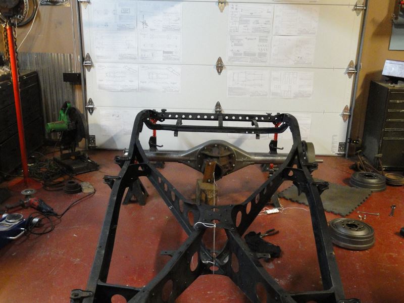

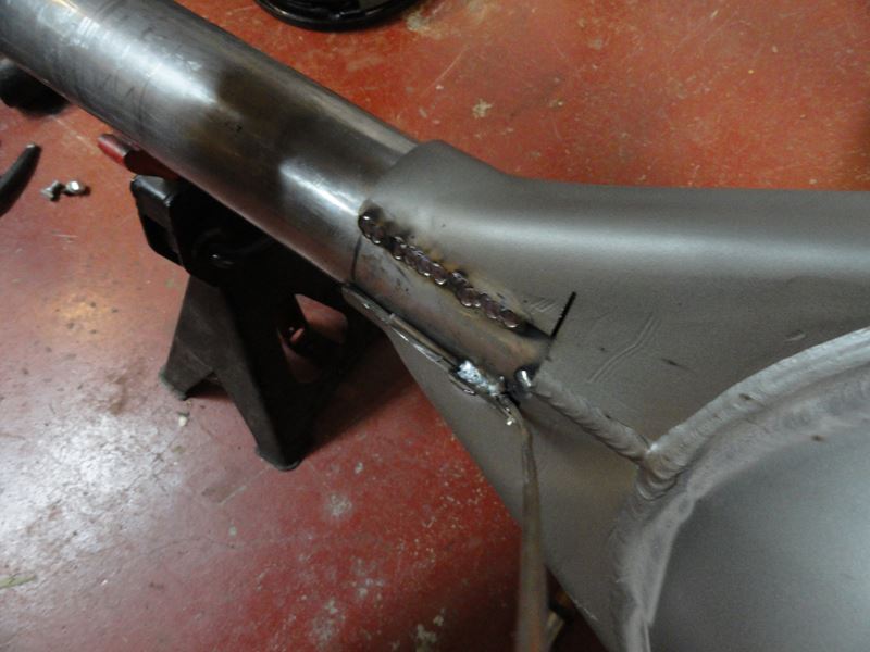

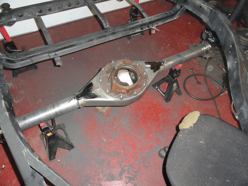

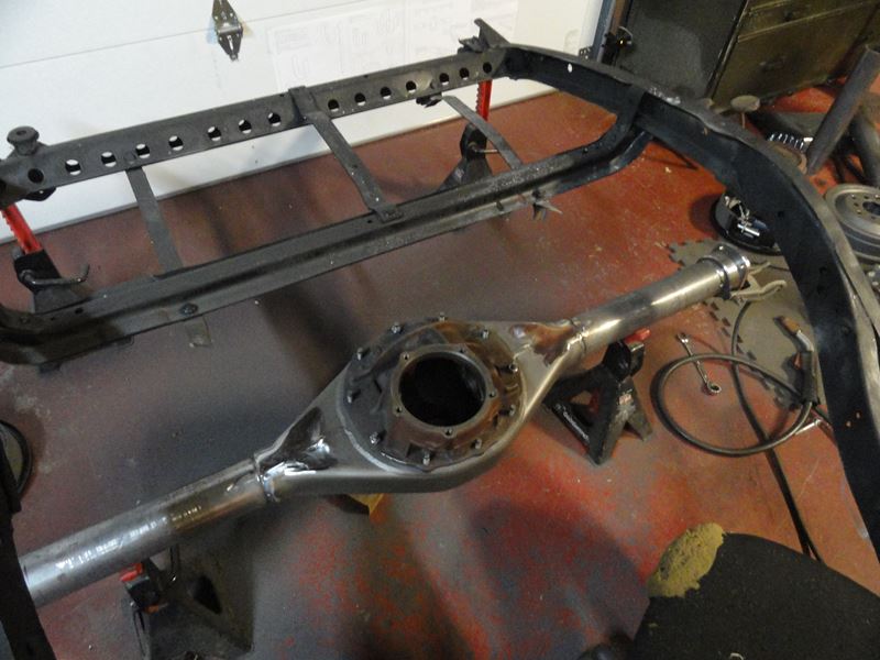

  21. Got the rear end measured and welded. I had ordered 2 DOM tubes from Speedy Metals at 36" each - but turned out that was way overkill. Only needed 19" per side. After eyeballing and moving and measuring again and again - got it where I wanted it - measured the exact same as stock! I guess the Palamides were intended to fit under the cars of the day without an axle mod ??
    This Tudor's axle jig. This is a shot of the chunk plus the guides for the jig.
  23. Sometimes the picture upload is goofy. Had to add some filler rod here. Also notice the bar for the jig is out now.
    All welded - now to fill it in. Thought about using bondo here - maybe I should have -

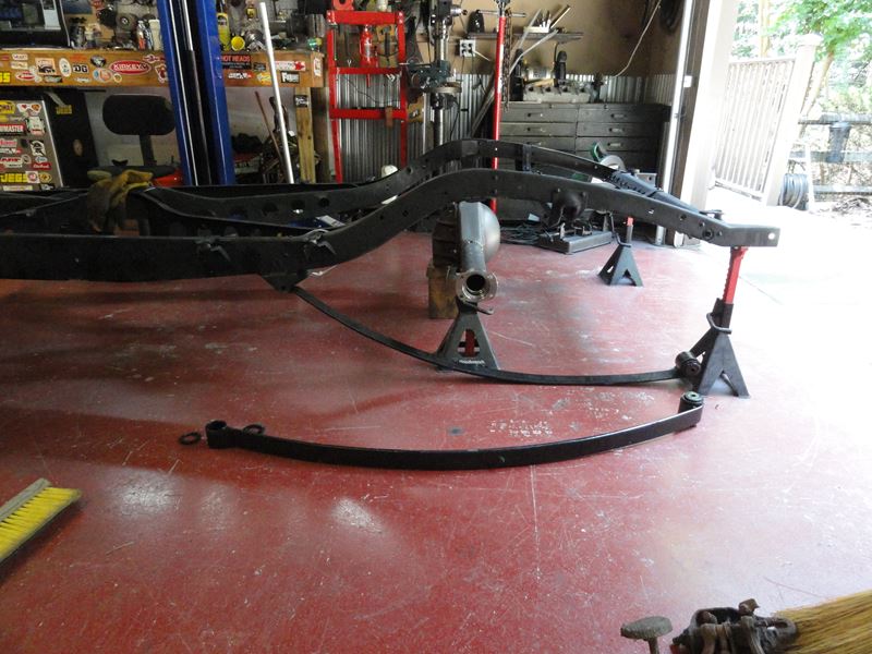

    Next item - hang these leafs .....

  28. These are about 1" wider than originally mocked up. Hmmmm wheel spacers? Gotsta start somewhere or you just sit and look at stuff and wonder - what if o_O
