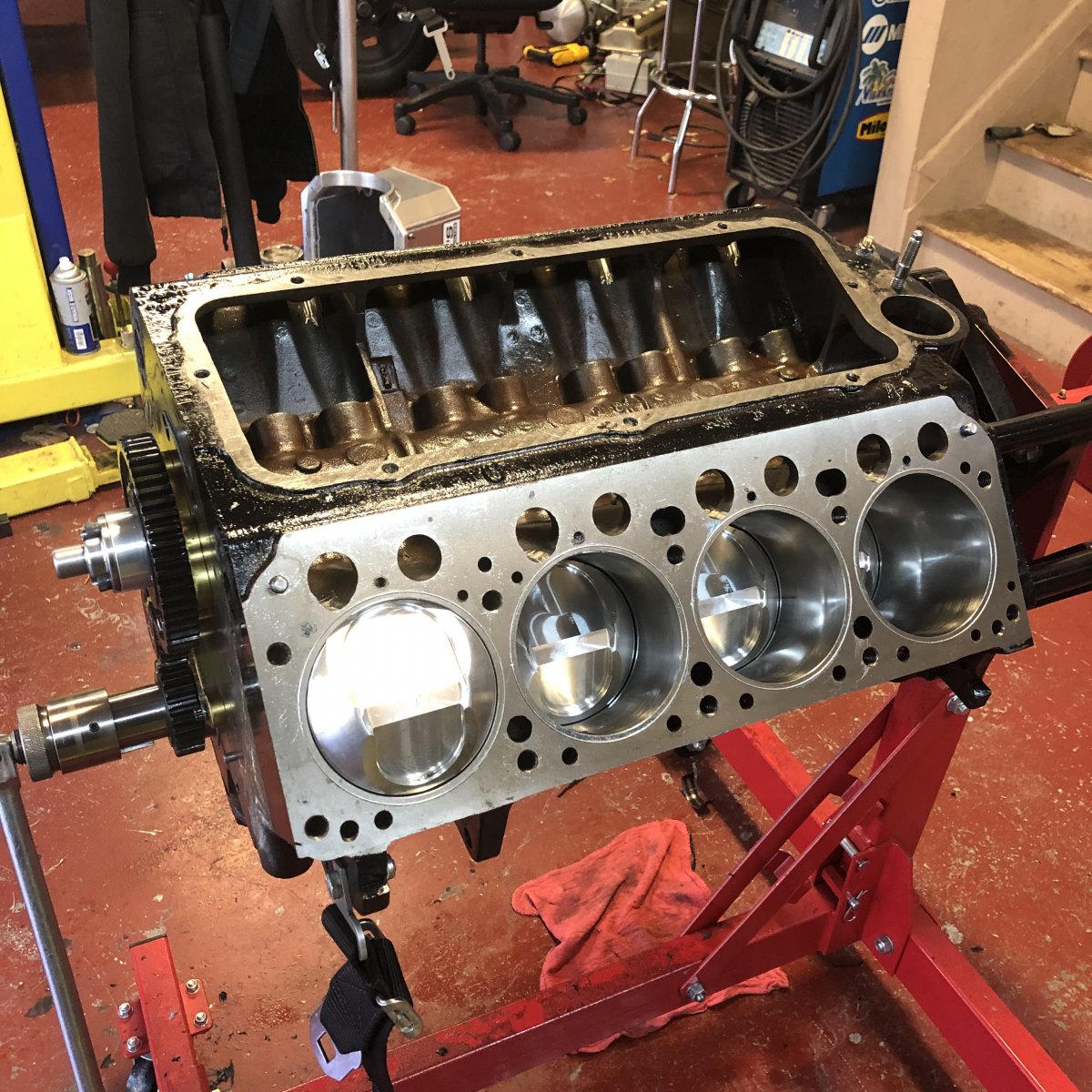

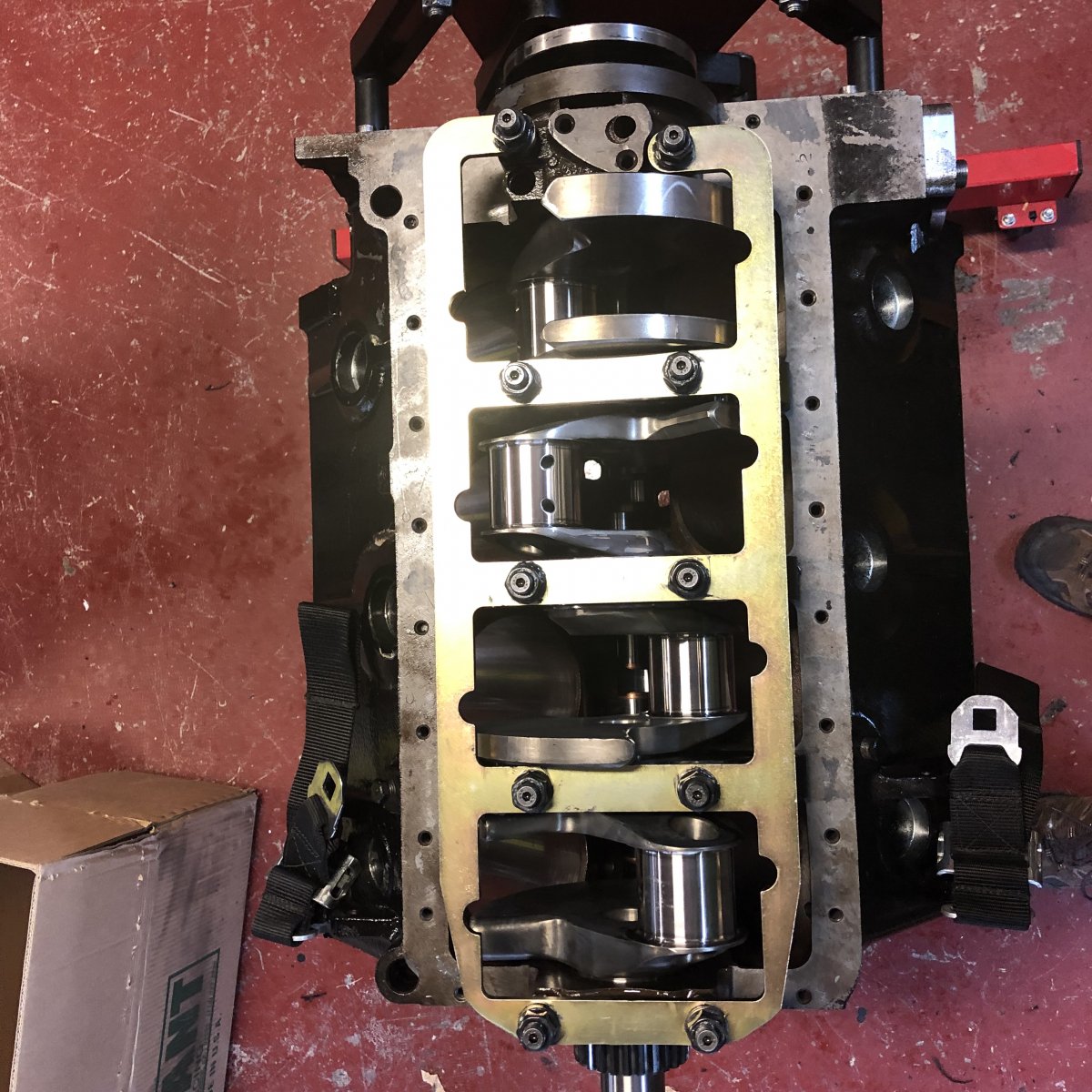

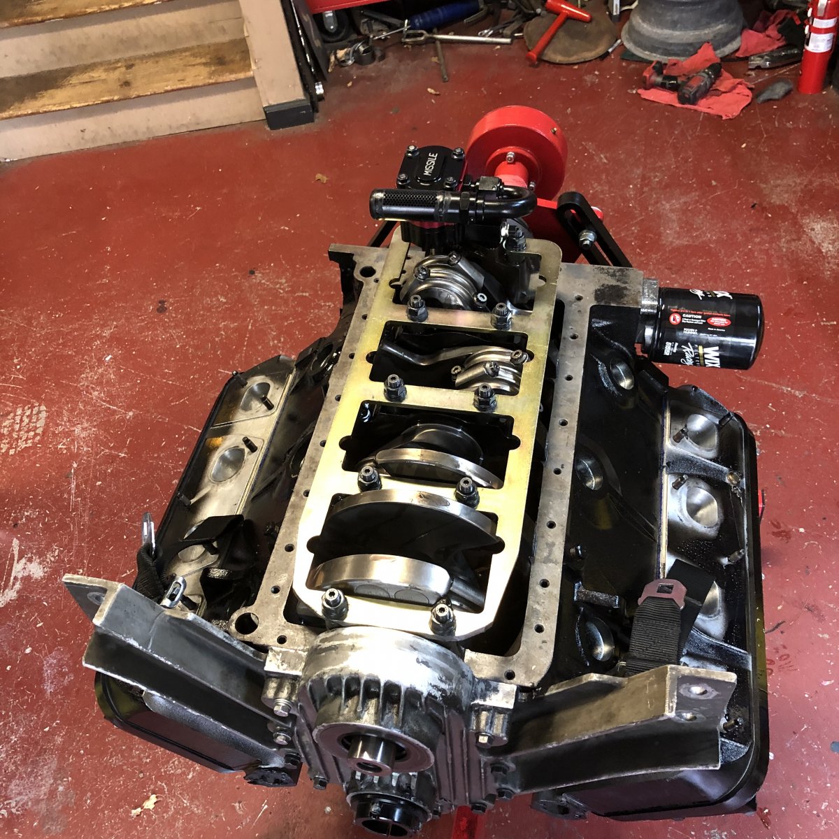

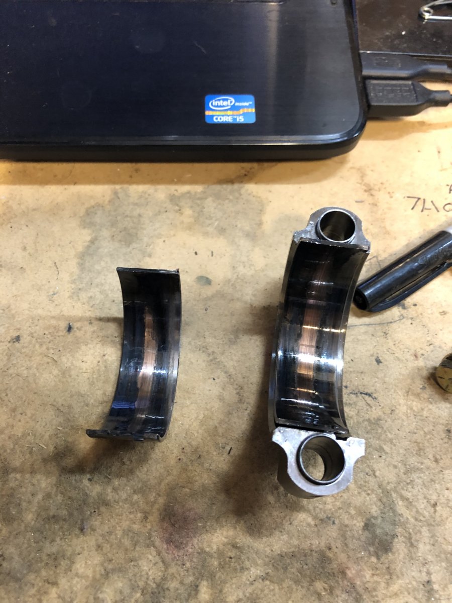

  2. Good thing it was only eighth mile. Was it just one bearing or all of them? I would torque all the rods down and run a bore gauge through them. A early hemi can rpm higher than a 426. I would personally feel more comfortable knowing the big end of the rod didn't go out of round.

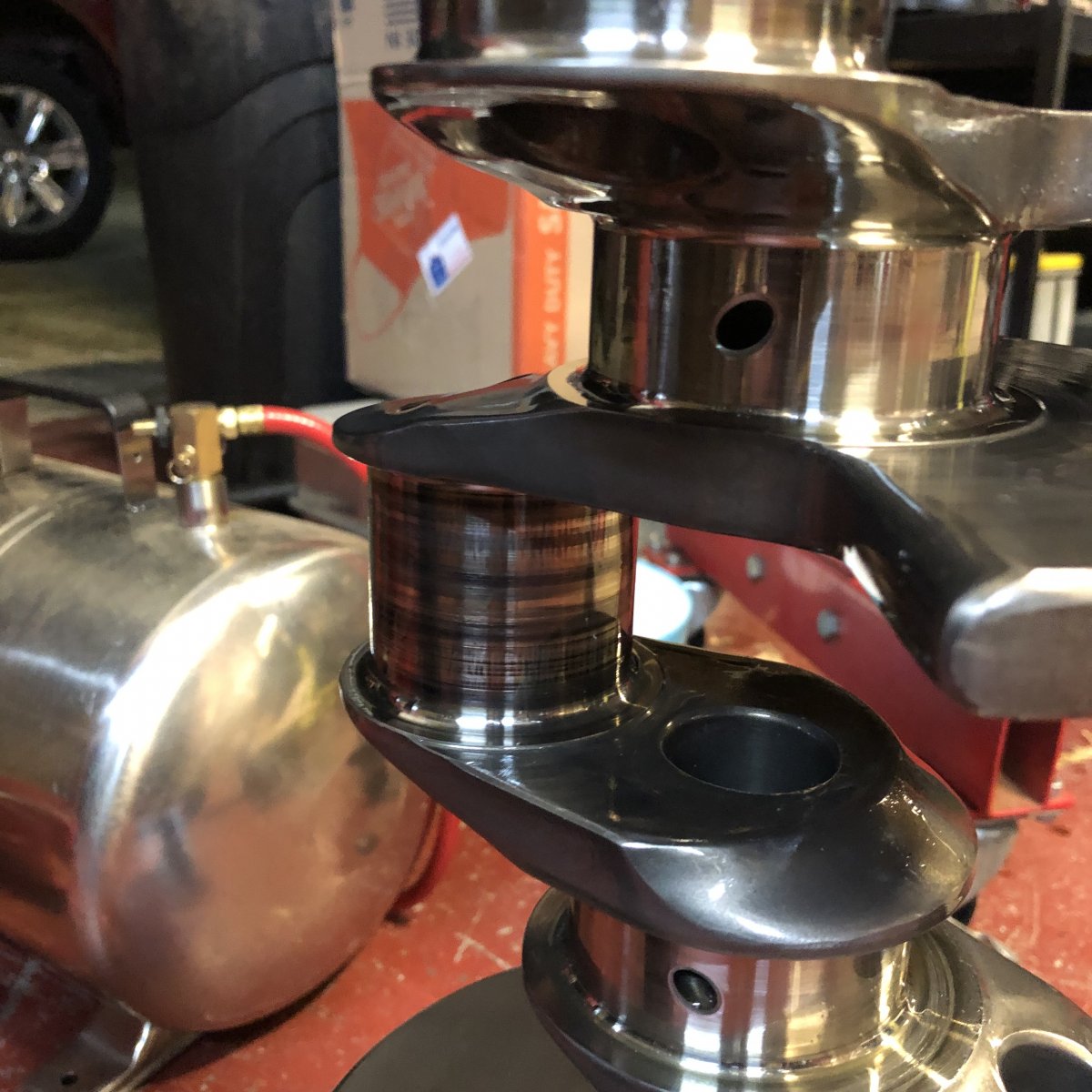

  3. Yeah it was a damn close call. The oil pressure went to 30psi right at the return road and the engine died. Its downhill to the trailer so it wasn't started until we got home. We started doing a leakdown test and the damn thing was 90% stuck! The starter could rotate it but the crank bolt wouldn't budge it. Another 1/8th mile would have scattered it.
    So the rod bearing closest to the pump was fine. All the mains are like new. Each bearing going farther from the oil pump is blacker. Johnny is checking the rods and fitting the bearings today.

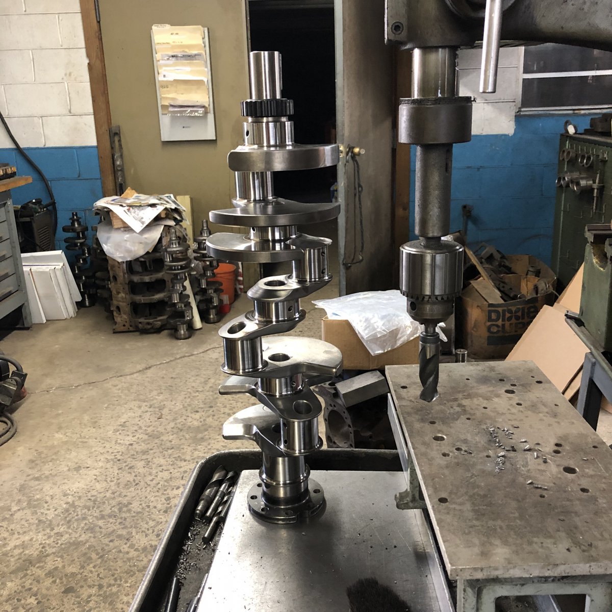

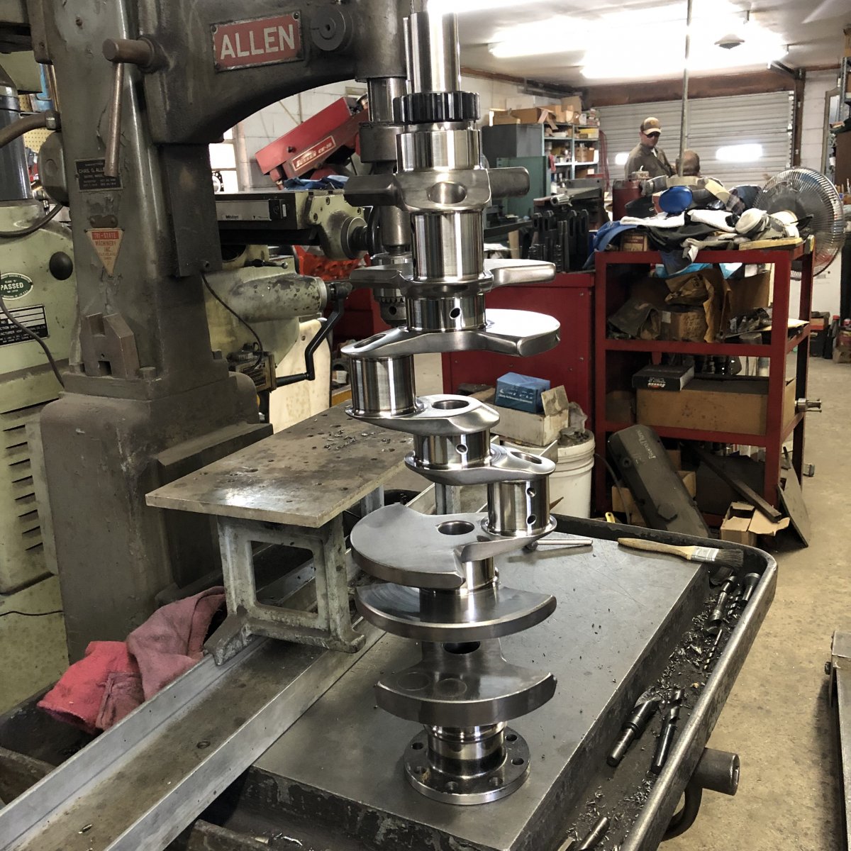

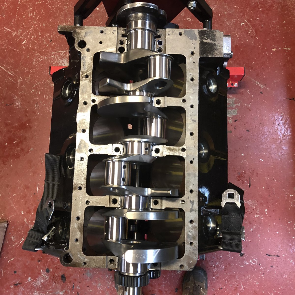

  7. Tested that
    Yeah he wasn’t keen on me changing the spring but said it’s possible. My theory on this - his spring is 36# and I swapped it to 27# . At idle or just using a drill it went to 80 psi fine. At 9000 it might be doing something weird. Happened too fast so maybe it was fine - don’t know. Don’t mess with success.
    Johnny said the high dollar crank paid off this time. Polished right up. A stock crank would have been scored pretty bad he said.
    $100 polish
    $100 fitted bearings
    49FEE00F-6018-4D25-83D3-93D6EDBE7680.jpeg BE259AEA-8B82-48DD-A547-75963A8C4A0E.jpeg
  8. Cool. You get what you pay for. Nothing like quality parts. With the drill the oil was cold right? Cut that by half hot.
