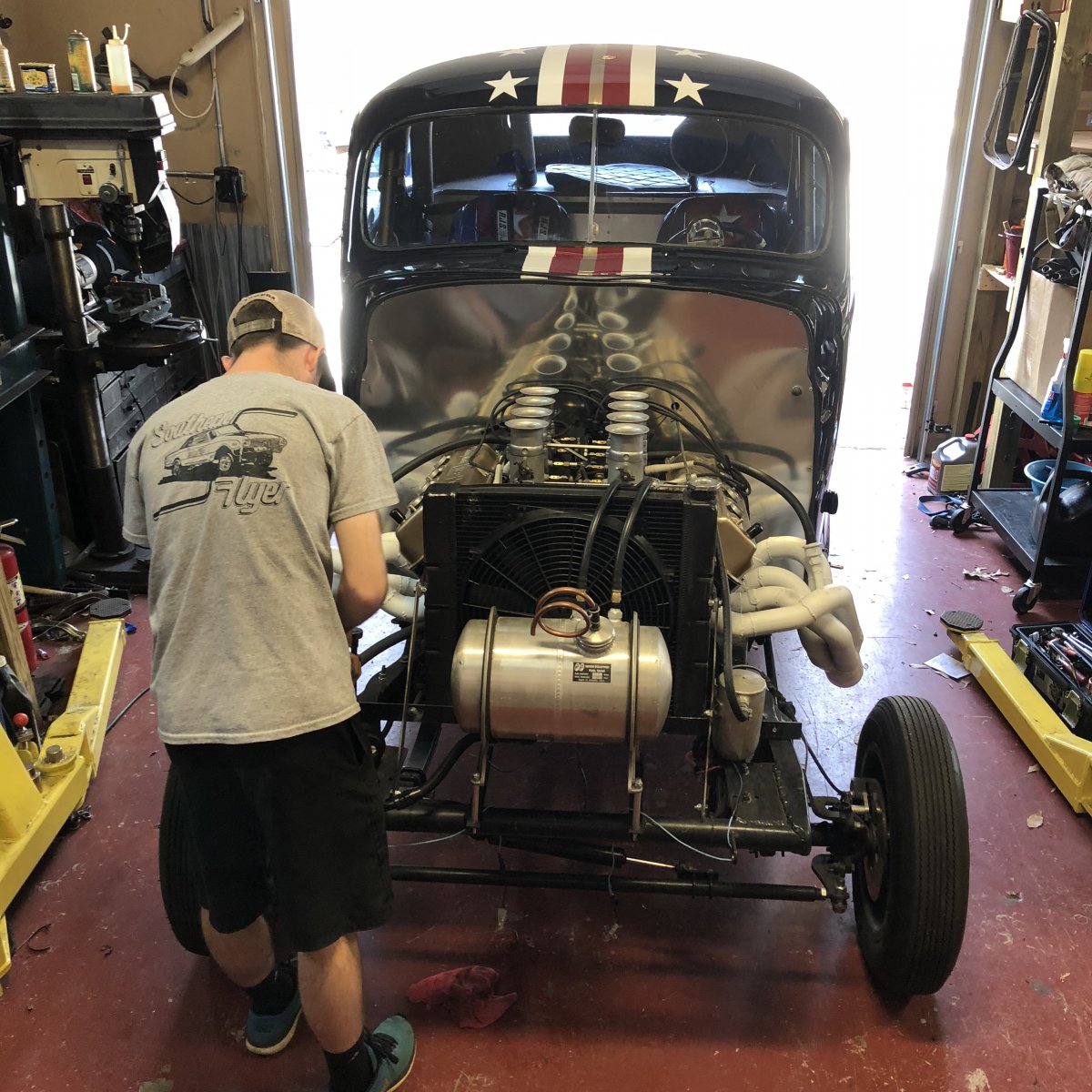

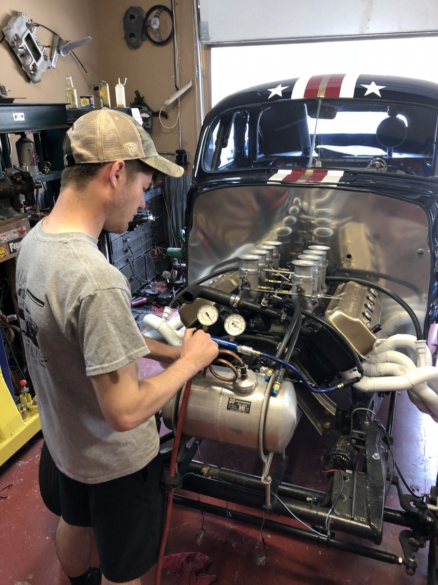

  7. Slow progress but getting things cleaned up that have needed done. Cut 15 pounds of frame pieces and junk bracing that wasn't really doing anything. Now its time to clean up the aluminum floor and attempt to bend a easily removable trans tunnel. @allwilly was working on a bonzia weekend run down here to bend up some sheet metal but it hasn't worked out yet. Maybe it will before I make a complete mess .....
    My help is going off to college at Auburn for mechanical engineer in 6 months.
    So I'm working his ass off
    Set the barrel valve to 12%
    These seat mounts have got to go - not sure what to do here though .

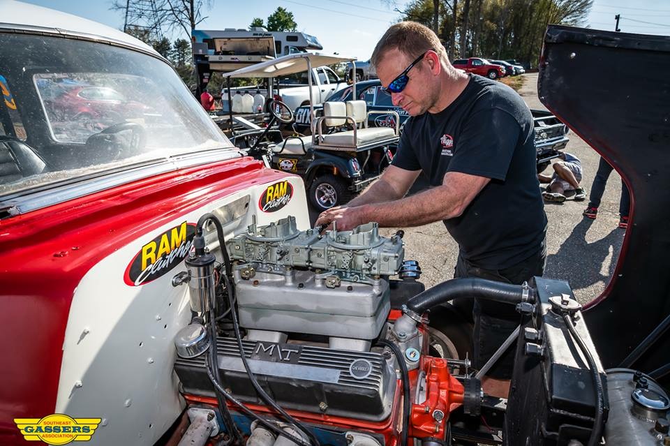

  16. AE722B67-C267-478A-8511-8D6296B1B097.jpeg 90D8056B-9F73-4E82-AC78-F8123E9918EC.jpeg BA965BA4-31A5-483A-A1B8-07CA6510806F.jpeg 1FEC8D8B-168B-460E-85F5-0FB5F54DB6B6.jpeg E73E4F9E-5868-4112-AAEB-61B19EAC8458.jpeg 66A8150D-985F-492D-B0D8-228EB7680C23.jpeg B5D0DCD5-583F-4ED9-A018-612B1F8DE825.jpeg BF82E5E9-AE34-41F4-95C7-206B2E06581B.jpeg Man what a great weekend! Record crowd and perfect weather. Hung out with a bunch of awesome people and smoked some tires and Cuban cigars. Here’s a few random shots.
    The car ran great Friday night- too great- was driving over the tires in 2nd and 3rd. Then Saturday it stumbled on every launch and then after the show was over they let me use the track to troubleshoot. After leaning the barrel valve and doing a test hit several times it stopped stumbling. So now I know what the bog is caused by. Wish I knew this before bogging 3 runs. I’m ordering a weather meter and taking notes
