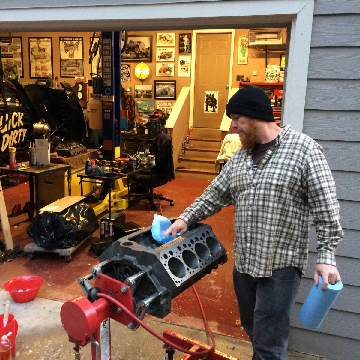

    You should share your photos from our trip to Ohio.

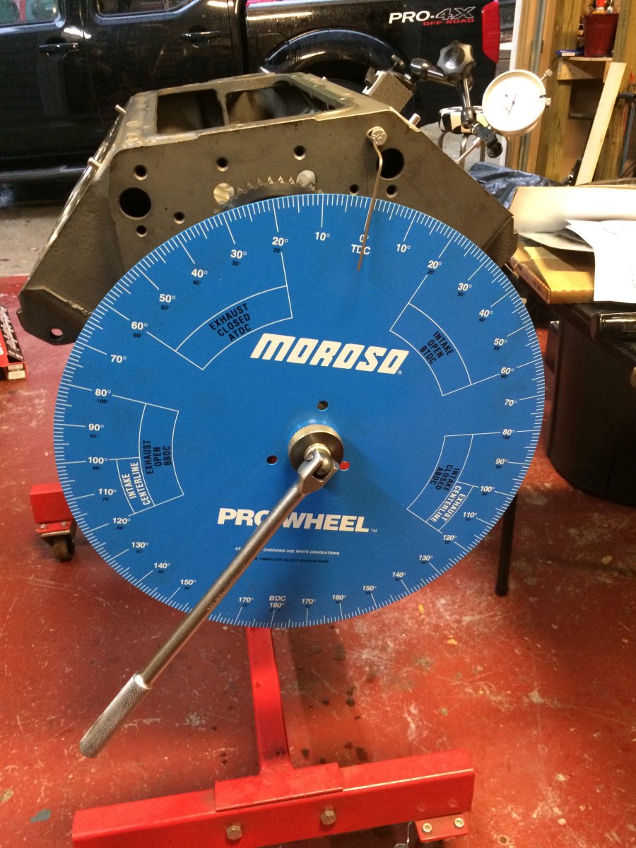

  15. Hey do they have tools? A car lift? Asking for a friend .....
    Thanks from one hemi hound to another. What cam are you running? This one has an Isky 505 flat tappet and I really don't want to break it in by pulling all the inside valve springs off. Time is short and that thing will be too hot to handle for hours. I'm tempted to break in the cam with both springs installed. 325lbs open.

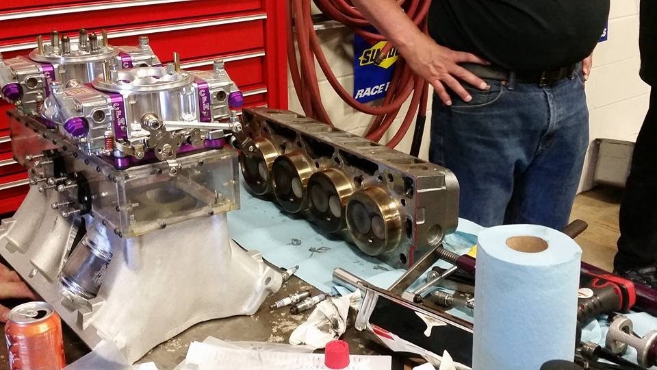

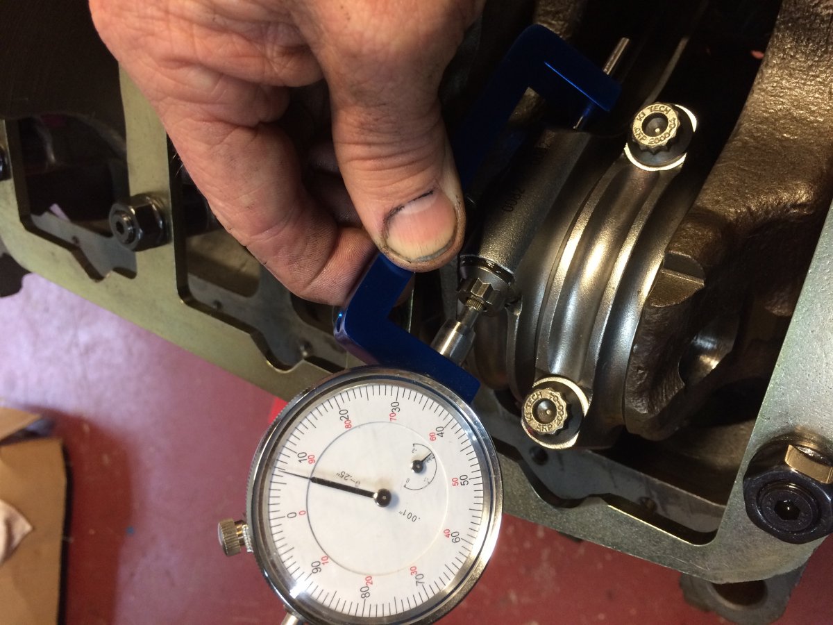

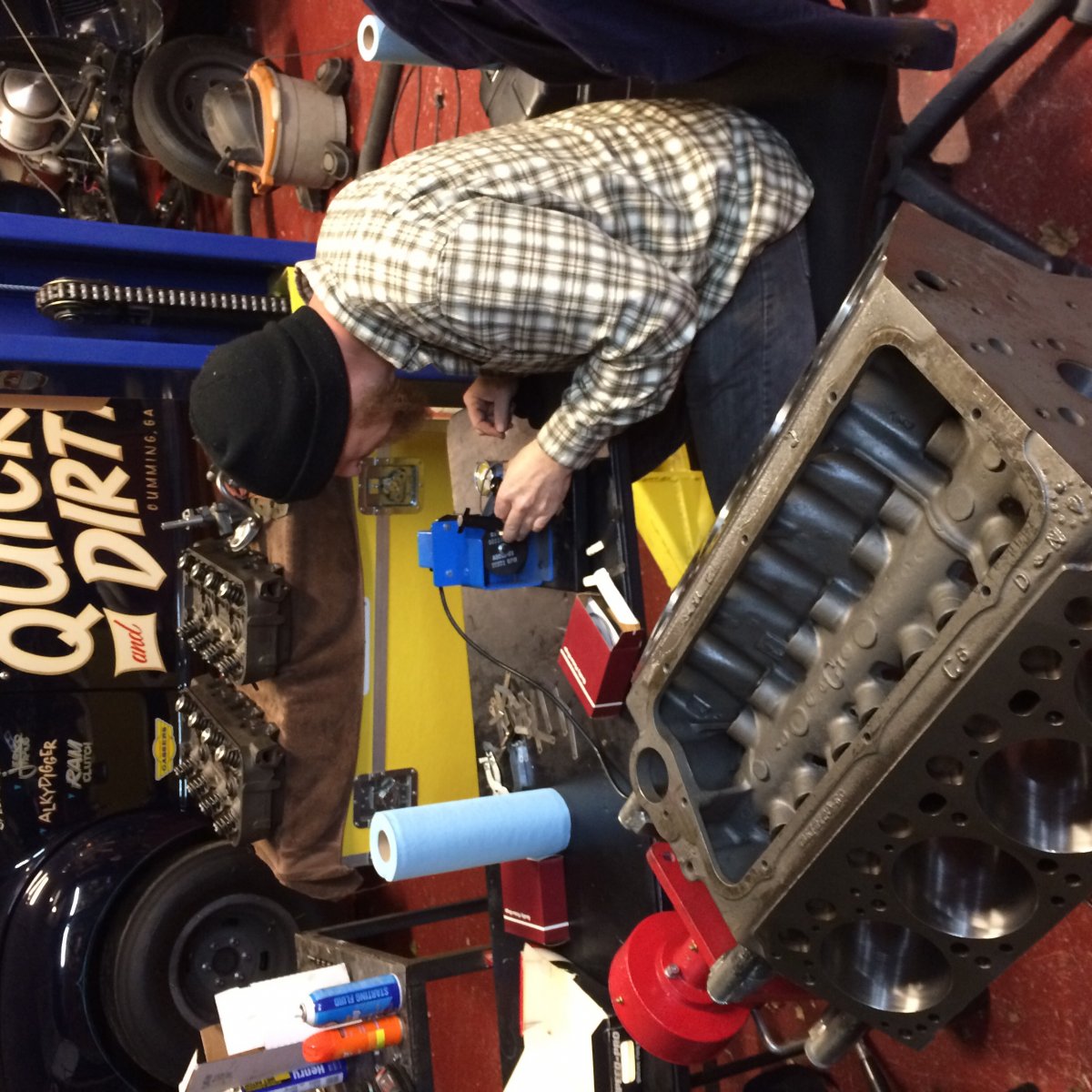

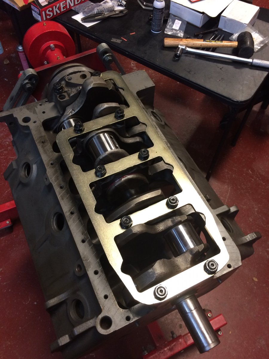

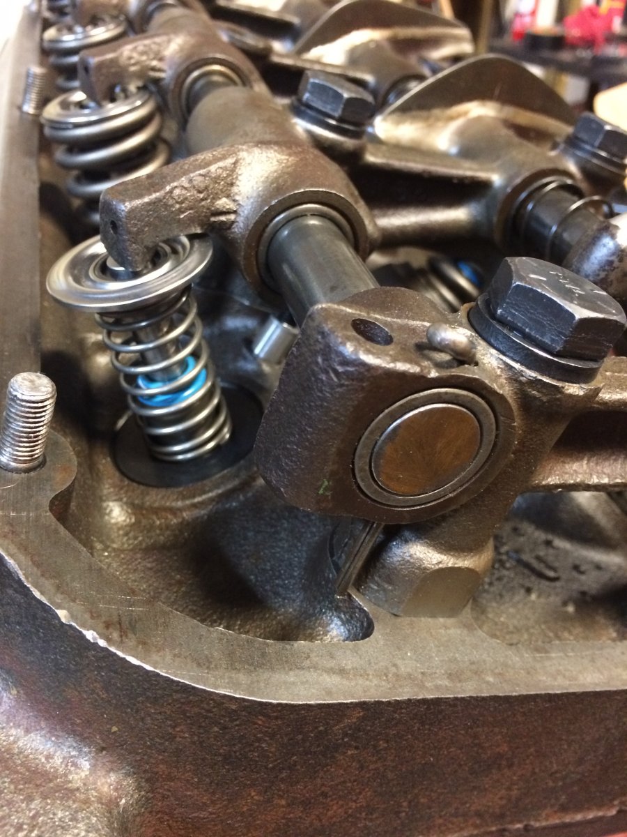

  16. This has to be one of the coolest things I've been to. Its probably been posted somewhere else by now. Here's a few shots.
    IMG_6182.JPG IMG_6203.JPG IMG_6228.jpg IMG_6231.JPG IMG_6232.JPG IMG_6239.JPG

    What in the world is up with that cylinder head?

  20. That is a John Kaase MEL engine where he dropped the valve seat into the cylinder to lengthen the runner - crazy!
    Thanks - I'll tell my friend.
    Sounds like we better pull the inner springs ......
    Here's the dyno cell video:
    Tudor, 402BOSSMAN, loudbang and 4 others like this.

    If you want to learn about thinking outside the box, follow John Kaase around. Last year he had a Y-block ford that they changed the intake passages from horizontal to vertical so he could use a SBC tunnel ram intake!

    1-1/4" Thick "Head Gasket" sure seems like the "Spirit of the Rules"......the gray area seems to rule anymore.
    I applaud his effort but at the same token completely altered the head from its intended design.

    Unless it was very early in his career when he was not a famous Ford Guru, I don't think I ever met John Kaase, so I'm not trying to defend a friend.
    But to me, if the rules don't specifically forbid something, then use that opportunity if you can figger out how. Gene Adams did a similar thing with the variable length injector stacks on that hemi.

    It wasn't Gene's idea, I've been sitting on it for 4+ years and finally had an opportunity to build it. Luckily the rule listed was simple - Unlimited. We have worked together for the past 7 years so he has been a great mentor to me. Either way it was fun to showcase ones abilities and see what others brought to the table. Gonna miss the contest, rumor is this was the last year.

  29. Was the deck height the same and they destroked it by the thickness the head was protruding into the cylinder?
  30. 402BOSSMAN
    Joined: Jul 26, 2015
    Posts: 428
    402BOSSMAN
    No, the 1-1/4" thick "gasket" allowed him to build a new combustion chamber by making it flush again to the deck.. It bolted to the block in the same manner.
