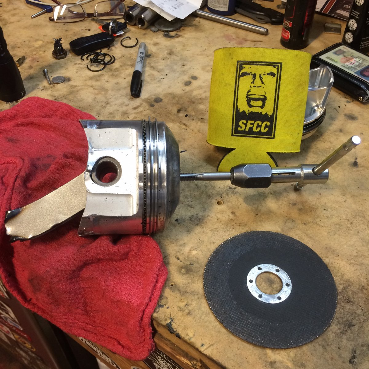

    After going back through the photos of the pistons out of the motor,I think you should have a closer look at the orientation of that second ring.It's clearly installed UPSIDE DOWN,which would not only scrape oil up toward the chamber,but also away from the skirt,which would explain why it looks a little bit scuffed up,too.
    So after a few pages of angry rants,name calling,and character assassination,it turns out this whole mess was caused because you couldn't install a piston ring with the right side facing up?
    WOW.
    You put a lot of effort into dragging a man's name through the mud....If I were in your shoes,I'd be feeling like a pretty big heel right now.
    I hope your apology is as enthusiastic as your accusations were.

    Just so ya know Scott, the photos that you have posted weren't the ones that were in his motor...

    ^^^^^^^^^ That was an old, used spare piston and an old ring that Tony was using to check ring groove depth and he installed the old ring on it just to use it in the absence of a micrometer depth gauge with a probe small enough to fit in that very narrow ring groove. Since it was only being used for this, made no difference which way it was installed, as it wasn't installed to run in the engine.
    In the opinion of many engine "gurus" the problem is that the piston used a design with no oil return holes in the oil ring groove because it had been designed originally for engines with vacuum pump on crankcase and oil holes would have been a vacuum leak.

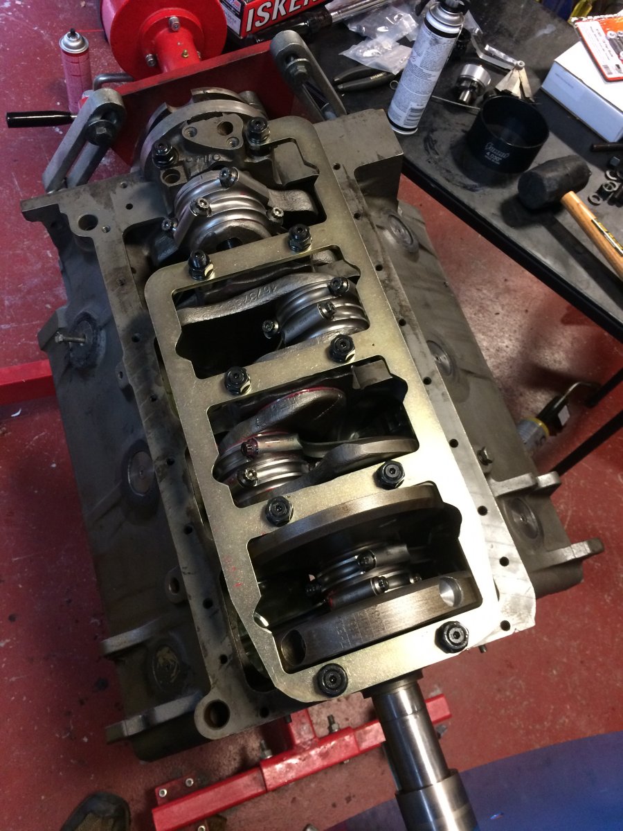

    Cliff notes version - the last experiment on the smoke was to use my season 1 engine. The 392 that had Wiseco pistons. I moved everything over to that block/pistons/rods/crank. So now we have all the same heads, lifters, pan, intake, crank evac - you name it. That engine didn't smoke at Darlington. Well - until the last pass of 4 passes. Thought leaving the line at 7000 rpm was a good idea but was not.
    So we went from this :
    To this :
    To this:
    catdad49, PBRmeASAP, enloe and 5 others like this.
  29. The stroker motor is now pulled apart waiting on pistons of a different design. Shorter rod to allow for a bigger ring pack. It is what it is.
    Now I'm out of options to get to the Nov 4th finals. My buddy Russ was cool enough to let me build up his 9:1 blower motor he's had sitting for years. Like a true addict, I jumped at the chance to get another engine in the car just to get the race points and not miss the finals so ..... no sleep till FINALS!
