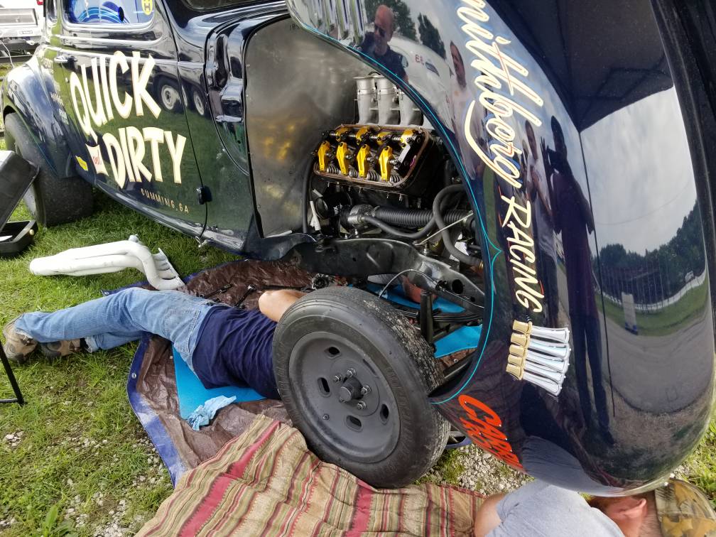

  5. Jimmy Huff was under there too and Gabriel was reading the torque wrench because me and Jimmy can't see anything without glasses anymore :D should have seen Mitch's face when I told him we were flipping the bearings like it was last year o_O glad you took a pic Rusty!
