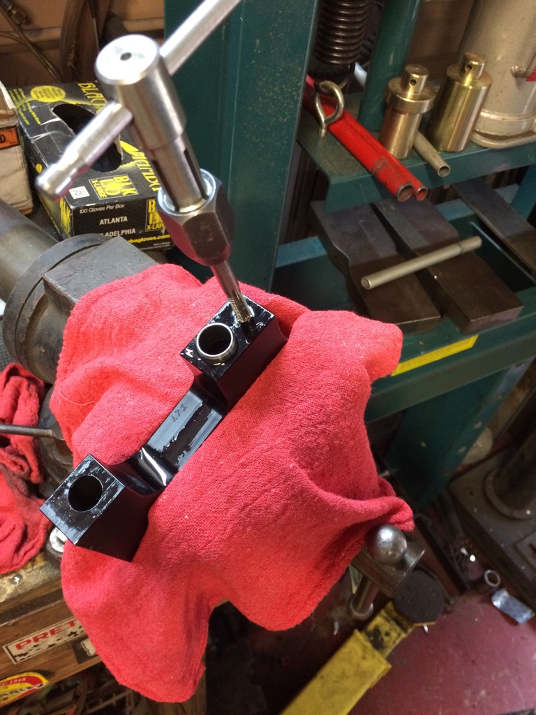

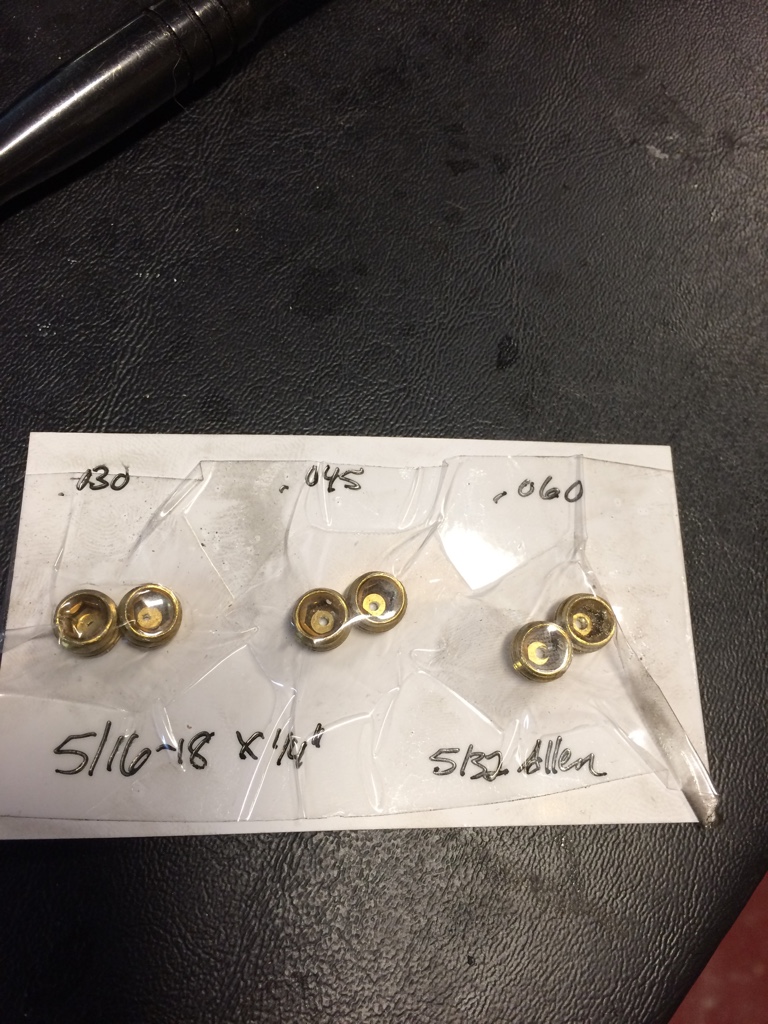

  2. They are real small holes. .030 .045 and .060 so I didn't even try to make any. The drill bits need a 4 jaw chuck ;) They are supposed to be here on Wednesday which is really making this tight. Test and tune on Friday night so ...

    I was afraid that was the size range you were dealing with, and that big ass lathe of mine won't spin nearly fast enough to utilize drill bits that small. Might get access to one elsewhere but in the time frame you're in, and the shape I'm in, not a realistic chance of getting it done.:(

    I made a second batch of them and Priority Shipped them. Tony got them today and is thrashing to get the engine together now.

    Couldn't spin that big lathe fast enough to have drilled those on it, but could prolly do it in the Bridgeport mill. Just have to drill and tap a hole in a piece of stock, screw the set screws in and drill after spotting holes.
