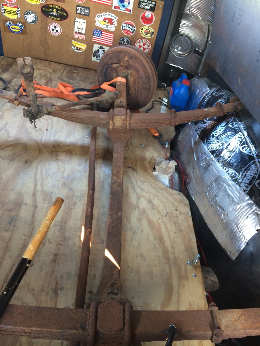

  3. He came over last night and pulled the axle to put on new parts. Worked past dark and rode away again - never saw him after that.

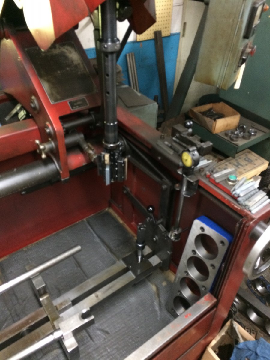

    Johnny was working on my block - honing with the torque plate - and he says you need a BBC and this issue will go away . I wrote on a hero card. He liked it enough to put me on his board.
    So after several calls - we found a way to get to 18 pounds on the oil ring. Rings are on order. Cam is full grooved on the oil supply now.

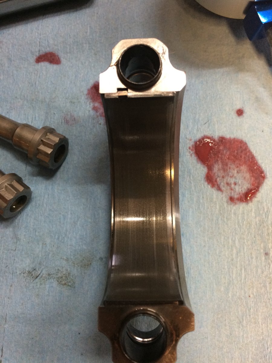

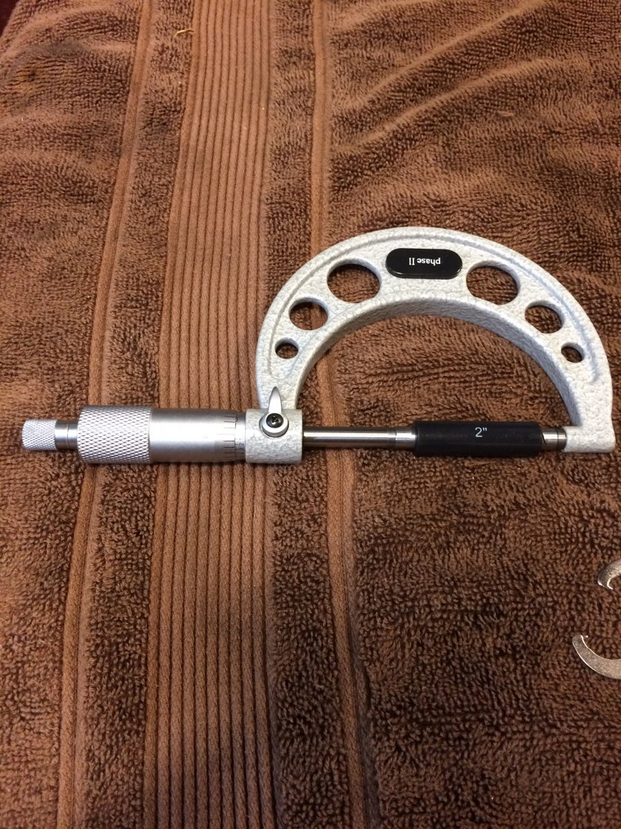

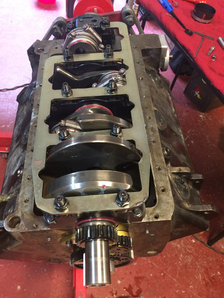

    Dotting the I's and crossing the T's this time around. 4 pistons left to install tonight. Checked all the bearing clearances and ring gaps, rod side clearances etc. Talked to 4 tech lines about ring tension and ring seal and engines that smoke on the passenger side - not unheard of in round track apparently. I've never taken this much time to put it together. All day Saturday and all day Sunday.

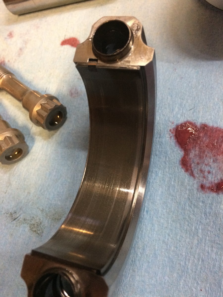

    What about rod side clearance? I can see .014 on the feeler gauge in pic, if that's the clearance with a snug feeler gauge, I think that should be OK. Lots of the circle track problems on excess oil on right side is due to turning left at such a high G force.
    mad mikey and Higgy's Henry like this.
  9. Yeah .016 would not fit at all and the .014 drags just a little. .015 is the target.

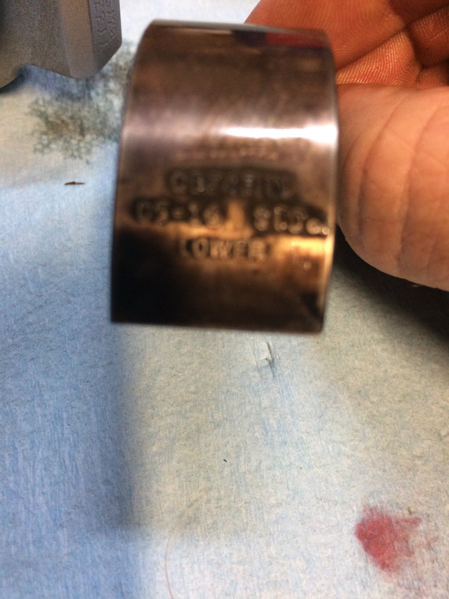

    Last night I ran the 'backwards bearing' test - new to me was BBC rods and so last season I had some of the rod bearings mixed up between upper and lower. I'll try to find the pictures from December when I tore down the engine, but the edge of the bearing was copper. I'm like damn - almost spun a bearing or something. Then I get to looking and you can read upper and lower on the bearing - the upside down ones were copper rubbed on the edge.
    It makes about .017 difference in the rod side clearance - which put the rod side clearance at zero last season. Didn't hurt the crank at all. But damn if it didn't confuse me on the source of the smoke. This year we got a lot more oil sling coming off of the properly installed bearings.
    IMG_5628.JPG IMG_5629.JPG View attachment 3611349 IMG_5631.JPG IMG_5632.JPG View attachment 3611354 IMG_5634.JPG IMG_5635.JPG

  11. greybeard360
    Joined: Feb 28, 2008
    Posts: 1,747
    greybeard360
    Some bearings that look the same but are marked upper and lower aren't the same.... The lower bearing has a little bit more clearance built in to allow for more oil to get between the crank and bearing so that you get a better film on oil on the journal as the crank rotates.

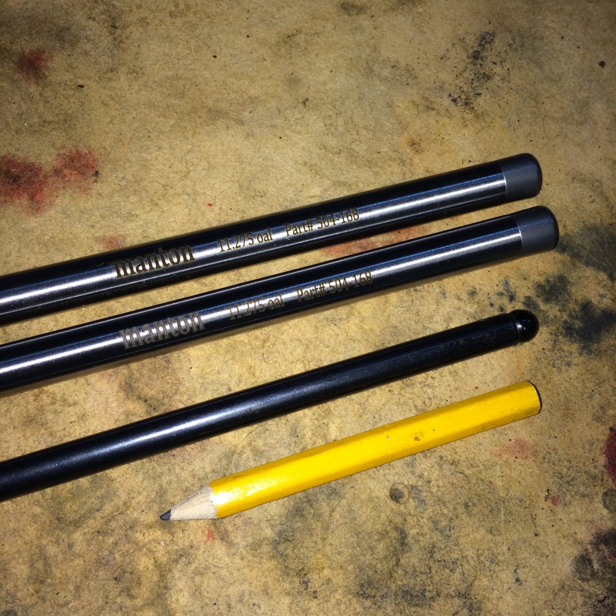

  25. The US Mail lost the oil control jets that go inside the rocker stands. In a holding pattern at the moment.
    He couldn't get the drone to record more than 15 seconds at a time. He was supposed to send it up and we were going to do 30 minutes of work putting in the engine and then edit that - all we got were some odd little pieces. Wanted to do a stationary time lapse - but who's got time for that :confused:
    Check the size of the 7/16" pushrods - the black one is stock size.

    Those push rods should keep them from looking like a bass fiddle string at RPM.
